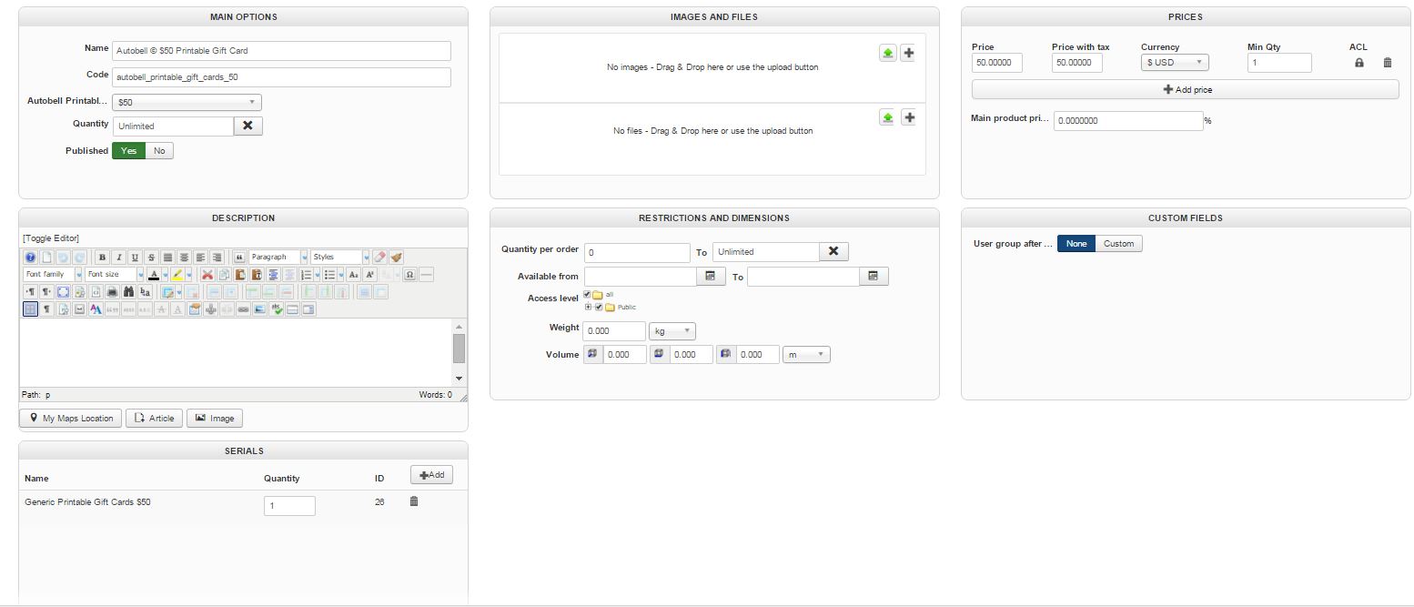

  • Posts: 165
10 years 4 months ago #223544

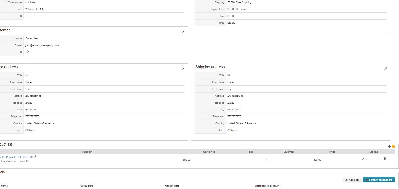

This only works if I set the serial number status to "unassigned" and then go into the order and refresh the status and then it will show up as "assigned" after this. "Refreshing associations" is not going to be an option with the number of orders this site will have.
However, what I want it to do is be able to set the serial status to "free to use" and once the product is ordered it automatically assigns the serial to the order and then hika serial set that serial status "used".
How can I get it to work this way?
Last edit: 10 years 4 months ago by jschroeder.

- If all is okay, you can go in the HikaShop order edition in the backend and click on the button "refresh association".
I'm not telling you that it is the solution and you need to click on that button for each order.
I'm asking you to perform that action ; so I need you to do that and tell me if the button "refresh association" fix the issue.
Depending that result, we will be able to go forward on more checks.

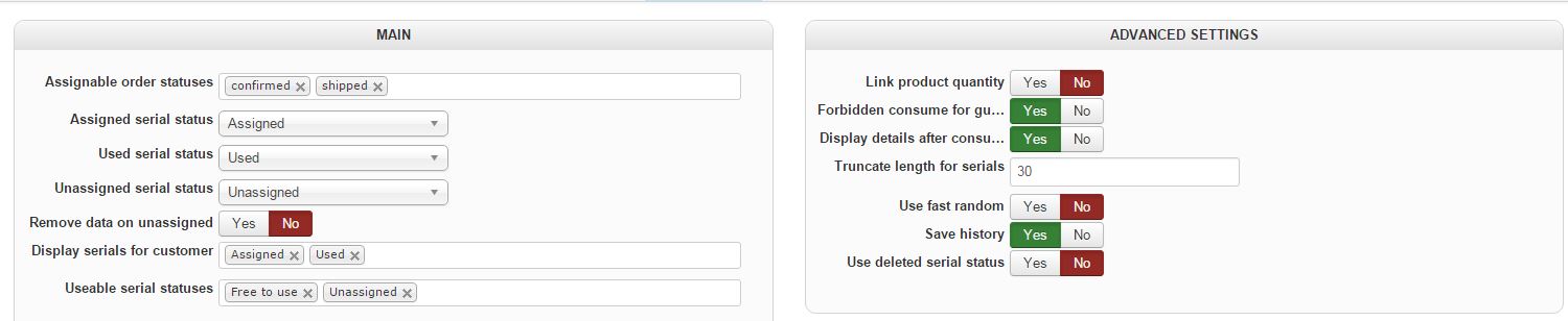

  • Posts: 165
10 years 4 months ago #223638
It does not work even if you click refresh association unless the serial is set to unassigned. If I set the serial to free to use the refresh association button does nothing.
I'm sorry but if you need to do that ; it means that the first points (cf my first message) are not correct.
So please provide details (screenshots) in order to prove that your configuration is right.
It could be also useful to precise the HikaSerial version number you're using.

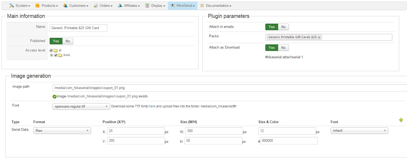

I am using the latest version of hikaserial HikaSerial 1.10.1 as I am the same person who had you add the button to not allow duplicate serials during a csv upload.
I uploaded a screenshot of the hikaserial configuration settings, hikashop product variant settings with the pack attached, the order which default is set to confirmed., pack settings, serial settings, and serial attach settings.
Please let me know if you need anything else.

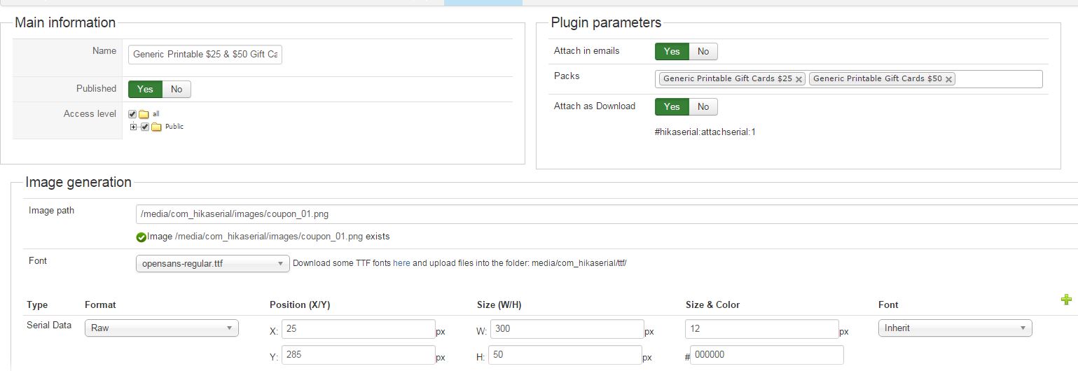

  • Posts: 165
10 years 4 months ago #223648
Sorry I sent the wrong screenshot of the serial attach settings this is the correct one!

10 years 4 months ago #223649

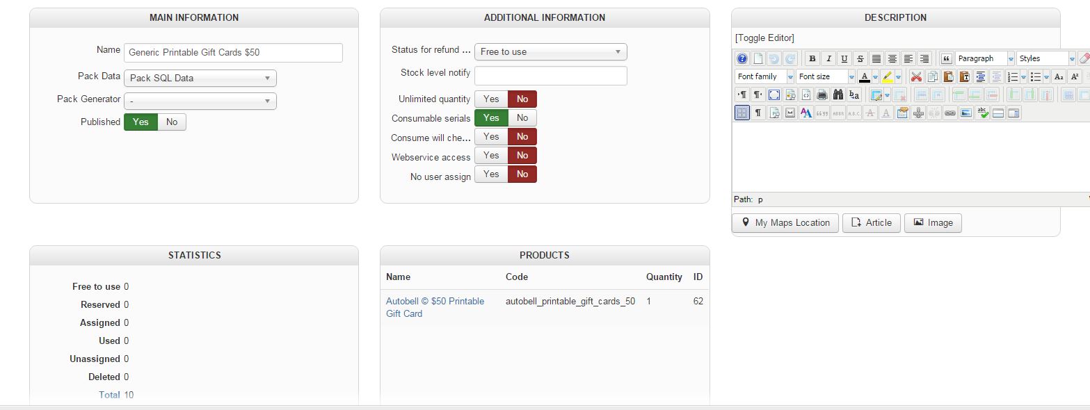

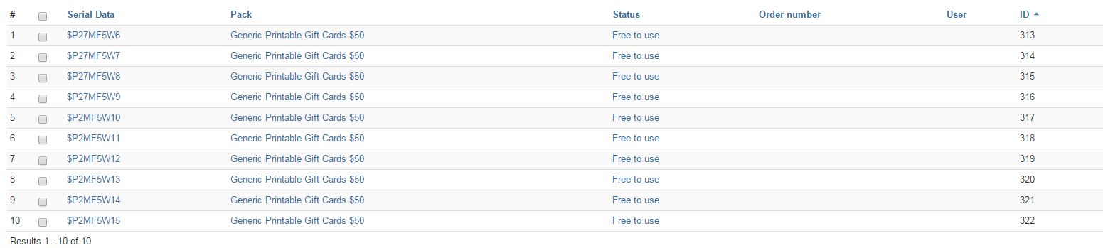

If you look at your screenshot "pack-settings", you will see that the statistic indicates that there is no "free to use" serials.
But there is a total of 10 serials.
www.hikashop.com/media/kunena/attachment...61/pack-settings.jpg
So your imported serials does not have the right serial status.
I suppose that you set "Free to use" which is the translated text and you didn't use the namekey which is just "free".
I will see to update the HikaSerial documentation in order to talk more about that specific point.
So, for the moment HikaSerial does not have any serial available for the assignation.
You can see to edit your serials and change they order status and use "free" next times for your impots.

However, My serial numbers are like this below and no barcode is being generated. If i change the format to barcode it sends the blank coupon image with nothing attaching to it in the email. How do I fix this?
$P27MF5W6
$P27MF5W7
$P27MF5W8
$P27MF5W9
$P2MF5W10
$P2MF5W11
$P2MF5W12
$P2MF5W13
I saw a link to different formatting options, but I am not really sure what format this would be considered. Also what do I put in the box under the barcode input text box in the screenshot I attached?

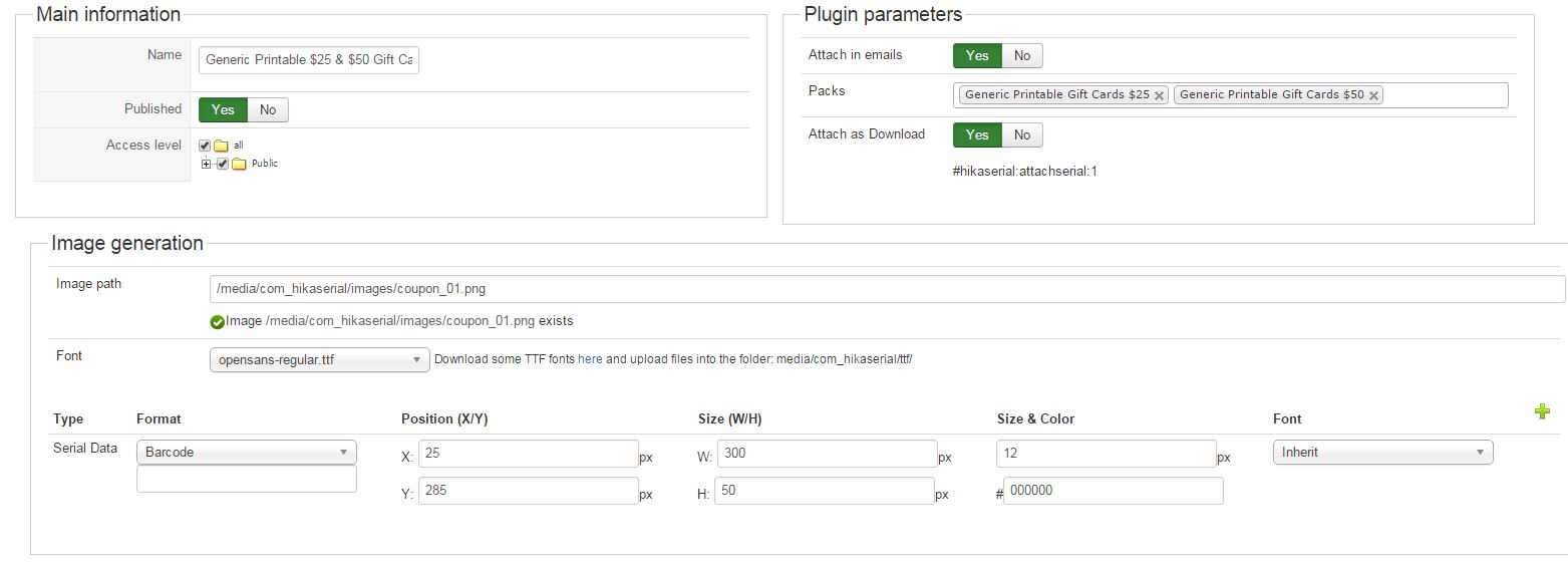

The plugin "attach serial" only accept barcodes with the format "ean13".
If the serial is not compatible with the format, the result is a blank image.
The support of the other format (for barcode and qrcode) in the plugin has been implemented few days ago and is already ready for the next release.
For the moment, you can just edit the "attach serial" plugin and change the default format in the function "generateImageBarCode".

I figured everything out now, but how do I increase the size of the barcode? I changed the width but it does not seem to increase size. I really think this should be a setting of some sort in the back end of the site. Currently the barcode is way to small and needs to be about 3 times the size it is currently.
  • Posts: 26353
  • Thank you received: 4066
10 years 4 months ago #223962
www.hikashop.com/support/documentation/1...ns-attachserial.html
The size settings "width" and "height" allow to change the "line width" and "height" into the barcode generator library.
By default the width is "1px" and the height is "60px".
By setting "3px" and "180px", the lines will became 3 times larger and the line height will be also 3 times bigger.
