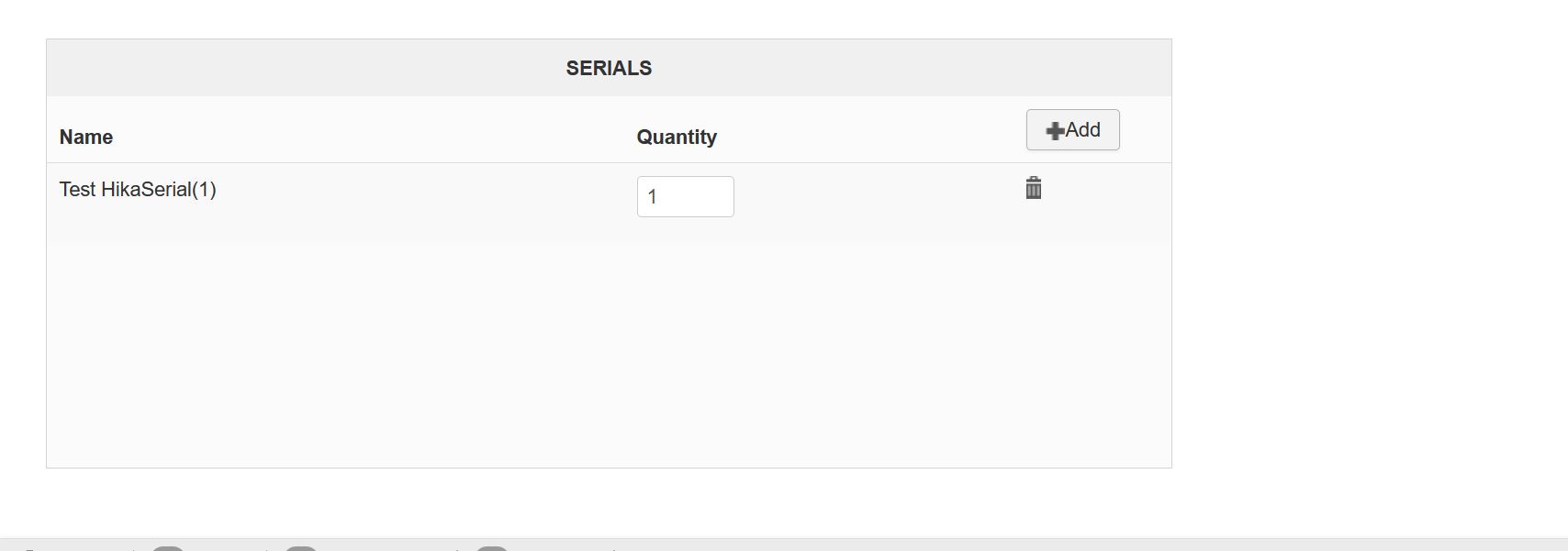

5 years 1 month ago #335667 by Jerome
Can you try to describe your issue ? (what you do have, what is not working..)
Some screenshots of your coupon template, your coupon generator and your pack will be also useful to understand the current situation and help you the best way.
We do prefer to help you understanding how the product is working and how to use/configure it.

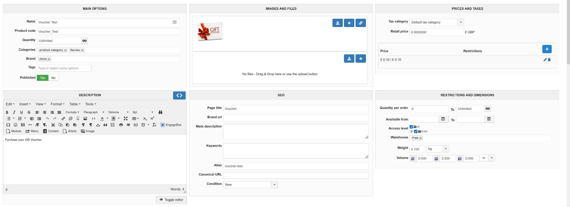

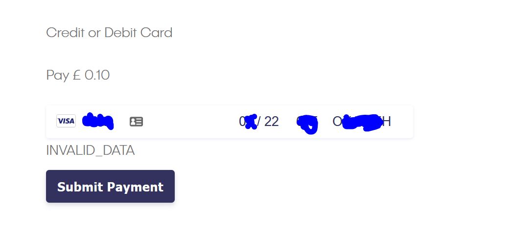

5 years 1 month ago #335702 by spytech
Hi, so for some reason all other products seem to be working fine and you can pay with no issues. The vouchers give the attached error, just saying INVALID_DATA. I have also attached two files for the Voucher product. It does create the serial if I manually finish the order in the backend, but need to test the email etc.

5 years 1 month ago #335706 by Jerome
CF : www.hikashop.com/support/documentation/2...ipeconnect-form.html
Tips
Stripe do not accept payments below $0.5 / €0.50.
We recommend to set-up the minimum price in the plugin depending your currency.
For more currencies stripe.com/docs/currencies

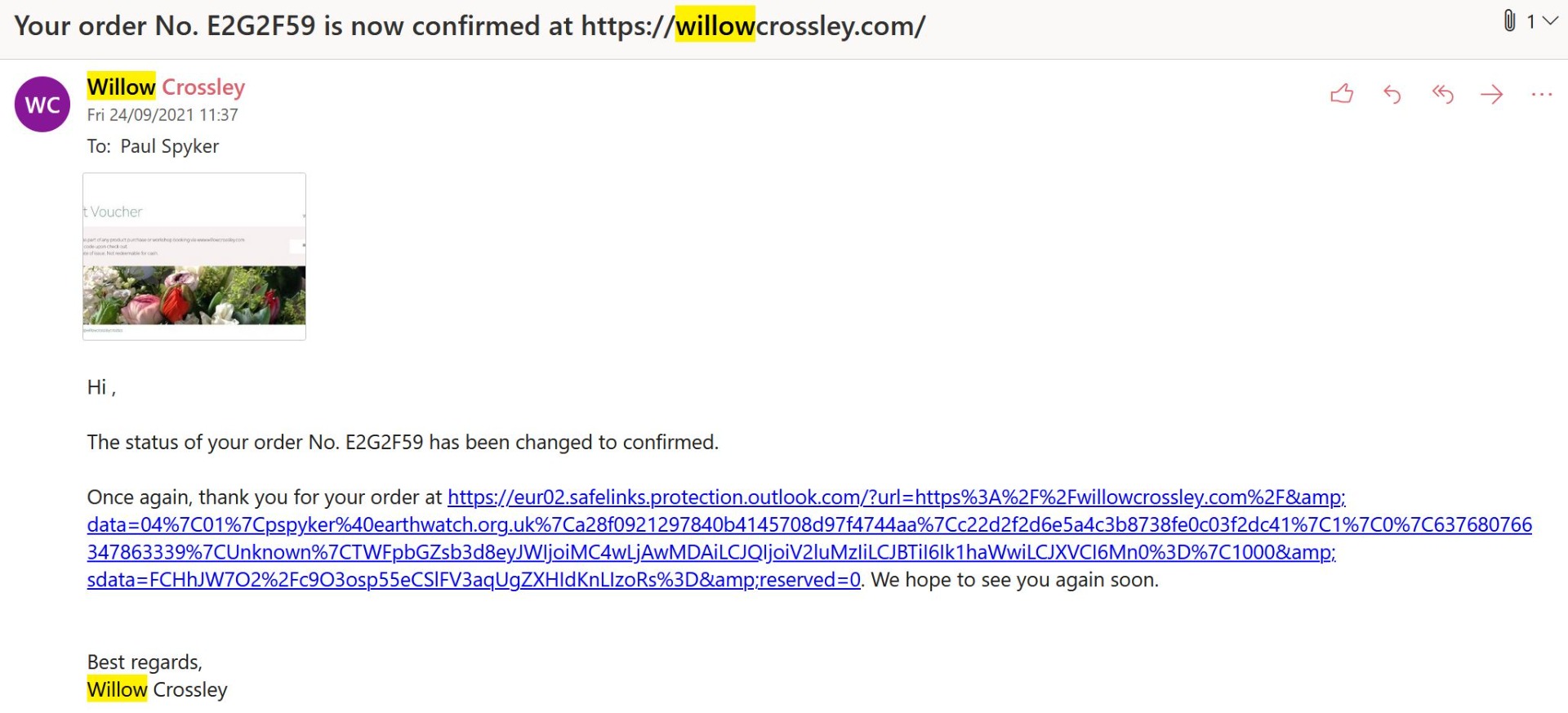

5 years 3 weeks ago #335983 by spytech
Hi, I am just trying to get the text in the email. The issue is that the serial is not showing in the email that is sent to the customer. See attached for the email the customer receives. Do I need to switch this on somewhere?
More
5 years 2 weeks ago #335988 by Jerome
Looking at your email, that's not a "default" HikaShop email but a customized one.
Since there is no details regarding the order, I suppose there is no trigger for HIkaSerial.
