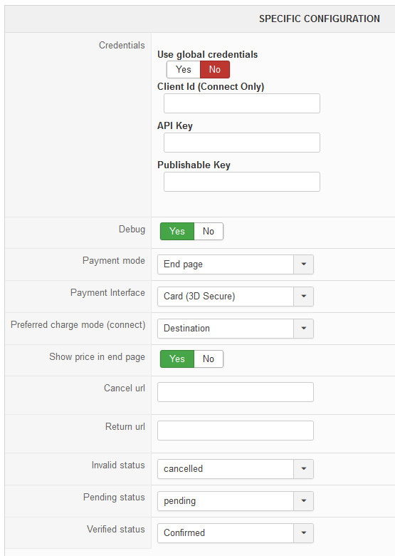

stripe
Additional Information
  • Credentials :
    • Use global credentials If you're using the plugin with HikaMarket, we recommend to use the global credentials and enter the next three settings in the Joomla plugin settings.
    • Client Id (Connect Only) If you're using the Connect platform, you need to provide your Client Id so vendors will be able to connect with your store.
    • API Key Also called sometimes "Secret Key" in Stripe documentation, you can retrieve it from Stripe's account (https://manage.stripe.com/account)
    • Publishable Key Enter here the publishable key associated to your Stripe's account (https://manage.stripe.com/account).
  • Debug : You can activate the debug mode of the payment plugin. If you do so, informations about each notification received from Stripe will be logged in the payment log file. You can see and modify the location of this file in the configuration page of HikaShop.
  • Payment mode : Allow to choose the integration mode with HikaShop. End Page is currently the default mode.
  • Payment Interface : The setting control the API which will be used. "Card (3D Secure)" is recommended. The Stripe Token API is now deprecated and not SCA compatible.
  • Preferred charge mode (connect) : When you use Stripe Connect, you can choose the way that Stripe will perform the charge.
  • Show price in end page : Display or not the order full price with the Stripe payment form.
  • Invalid status : Here, you can select the status to set to an order if the plugin receives a notification from Stripe for an order with an amount different from the order total or in a different currency. In that case, we highly recommend you to check your Stripe account, the order information, and maybe contact your customer, and decide yourself what to do with the order.
  • Pending status : Here, you can select the status to set to an order if the plugin receives a pending notification from Stripe for an order.
  • Verified status : Here, you can select the status to set to an order if the plugin receives a successful completion notification from Stripe for an order.
