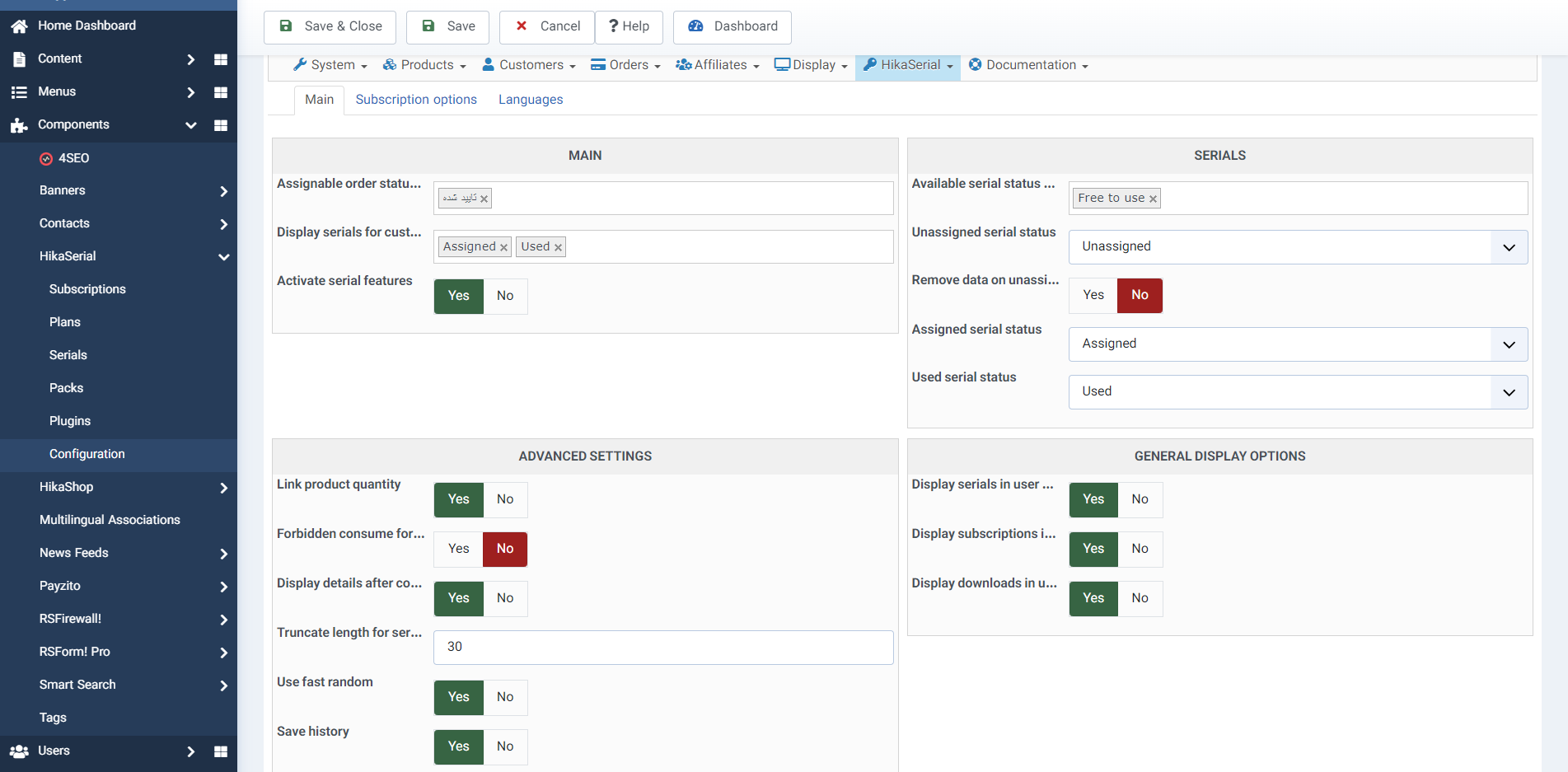

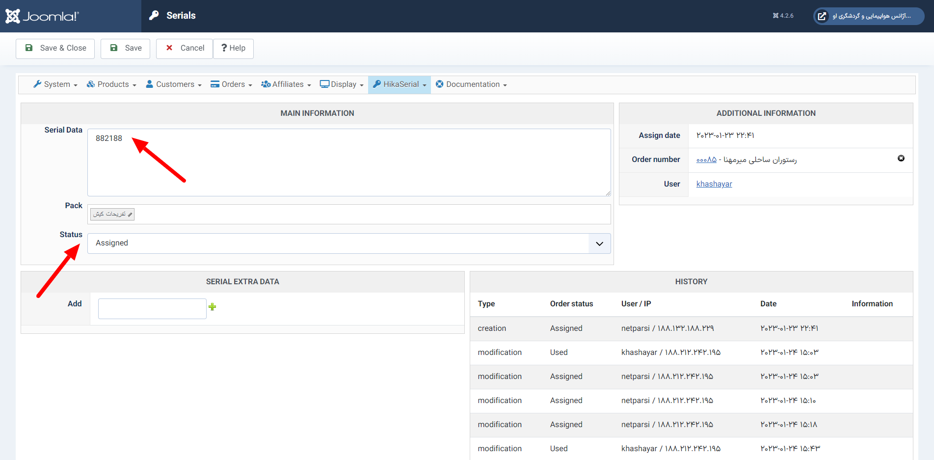

Can you please provide screenshots of your HikaSerial "serial" configuration ?
  • Posts: 240
  • Thank you received: 13
3 years 7 months ago #348665
I attached two files :
- screenshot of my main configuration page
- screenshot of one the serials configuration
