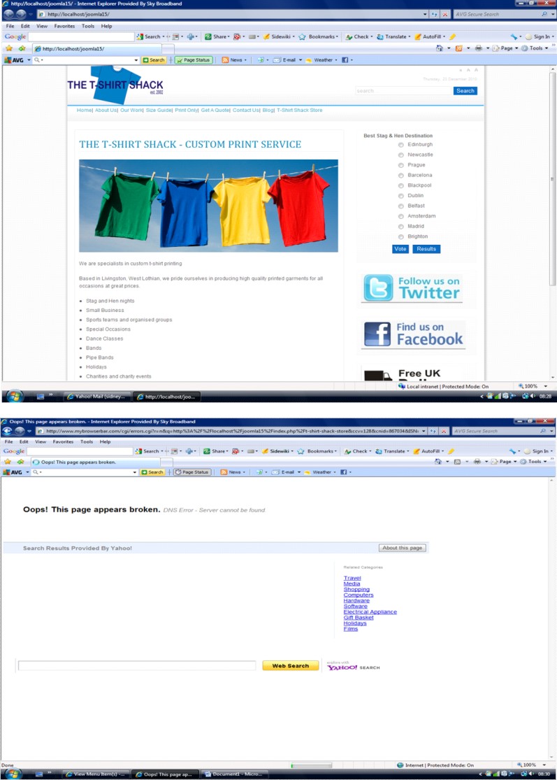

15 years 10 months ago #4025 by sidneyd
Hi Nicolas
I have attached a word doc with a screenshot of the homepage. The menu item is T-Shirt Shack Store and the screenshot below it shows the result when clicked.
I currently have this menu item set up as Hikashop - Category Listing
15 years 10 months ago #4026 by sidneyd
Sorry attachment didn't go through, try this image missing http://www.hikashop.com/media/kunena/attachments/legacy/images/t_shirt_shack.jpg
15 years 10 months ago #4027 by nicolas
Could you copy/paste the link which is broken ?
