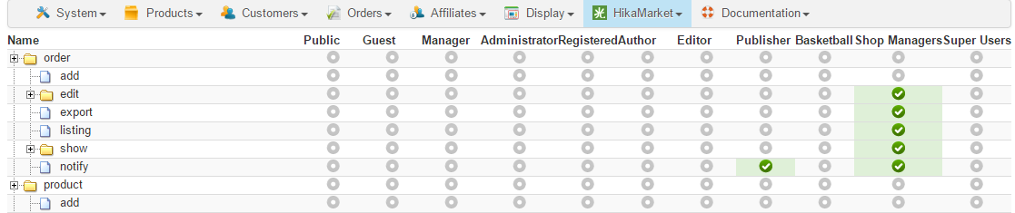

I have installed Hikamarket so that our accounts person can have access to the orders from the front end. At present however only the site admin can see this listing.
I have created a group called Shop Managers and made the accounts person a member of this. I have also modified the HikaMarket Access to be as follows for this group.
After logging on, if the accounts person clicks on the orders link they get redirect to the homepage i.e. don't appear to have the correct permissions. If admin logs in, everything works fine.

Does the account you tested are listed as users for "your vendor" ?
www.hikashop.com/support/documentation/2...tml#tuto_your_vendor
The admins are automatically assigned to the main vendor ; for other users you have to add them in the interface.
