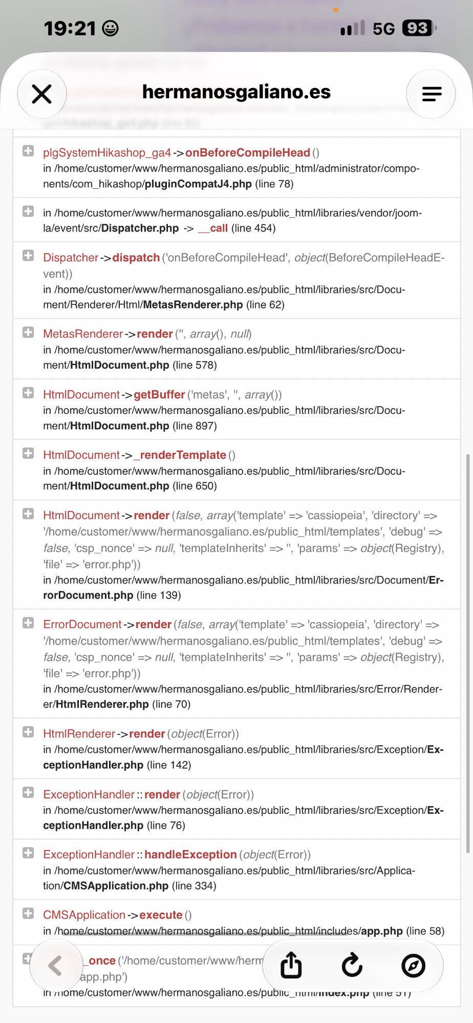

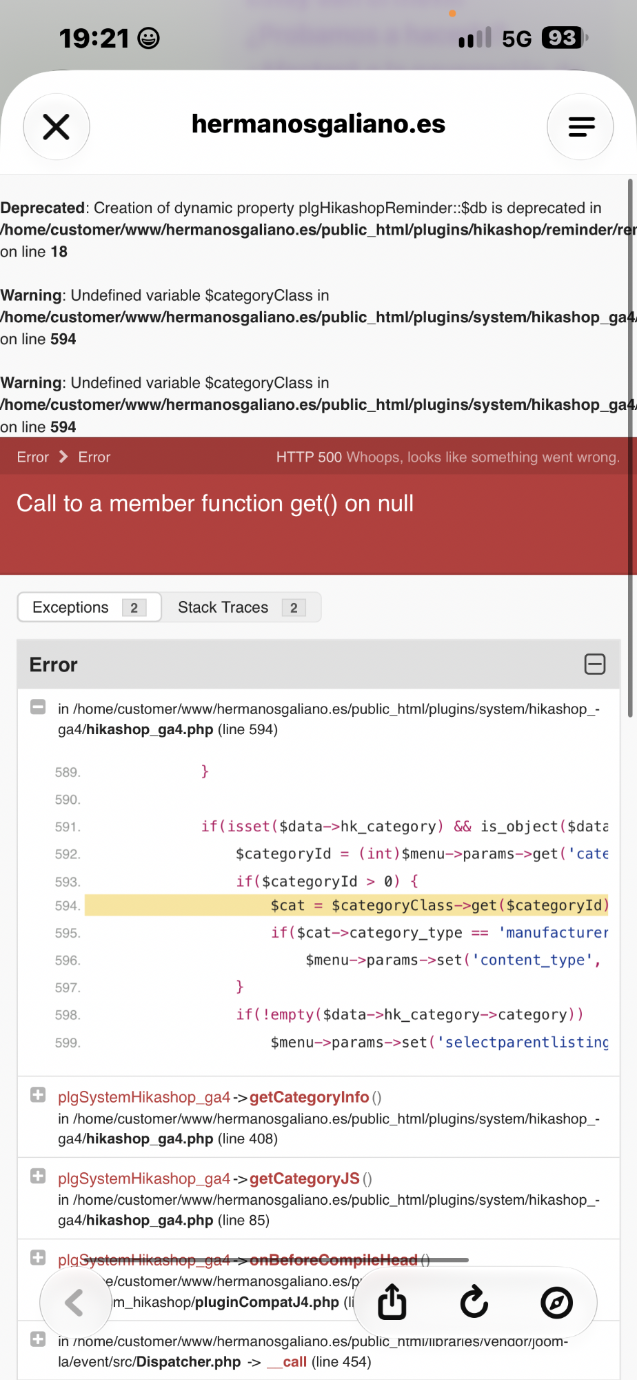

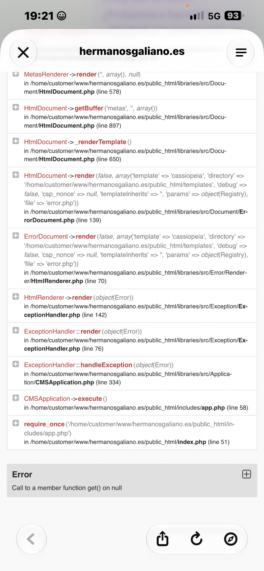

We ran the test with Error Reporting set to Maximum and found the cause of the HTTP 500.
The fatal error is:
Call to a member function get() on null
File:
/plugins/system/hikashop_ga4/hikashop_ga4.php
Line: 594
Before the fatal error, Joomla also reports:
Warning: Undefined variable $categoryClass
in the same file and line.
The failing line is:
$cat = $categoryClass->get($categoryId);
The stack trace shows the error originates in plgSystemHikashop_ga4->getCategoryInfo(), called from getCategoryJS() and then onBeforeCompileHead().
So it appears that the hikashop_ga4 system plugin is not initializing $categoryClass in this particular product listing context.
We have now restored Joomla Error Reporting to its previous setting.
Does this plugin belong to HikaShop, or should we contact its developer to have this case fixed?
Thanks,
José Ángel

1 month 2 weeks ago #100000151
by nicolas
Replied by nicolas on topic HikaShop generating duplicate product URLs with product ID
Yes, "System - Google Analytics 4" (hikashop_ga4) is our plugin. The error you found is a bug in versions up to 1.5.1: in getCategoryInfo(), the category class was used before being loaded, so some listing pages (here /component/hikashop/product/listing, which falls back to the settings of one of your menu items) stopped with "Call to a member function get() on null". It was fixed in version 1.5.2 of the plugin, and the current version is 1.5.6.
Versions before 1.5.3 also had a problem with their update check, so Joomla probably never offered you the update. Please download the latest version of the plugin from its page on our marketplace ( www.hikashop.com/marketplace/product/108...egration-google.html ) and install it over the current one in System > Install > Extensions. Your settings are kept. Then open www.hermanosgaliano.es/component/hikashop/product/listing again: it should display the products instead of the 500 error, and Search Console will stop reporting it at its next crawl (you can ask for it with "Validate fix").
The Deprecated message about plgHikashopReminder::$db in your screenshot is only a notice from the Reminder plugin under PHP 8.2 and is not related to the error.
