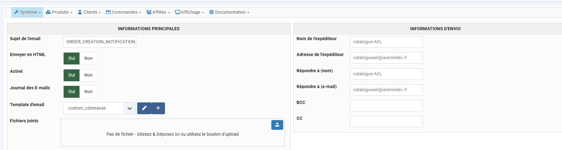

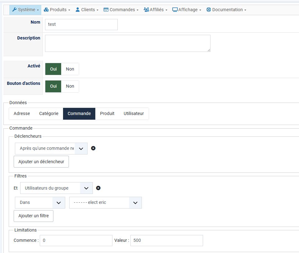

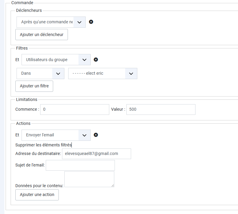

1 year 7 months ago - 1 year 7 months ago #366517 by Levesque
Sur les fihcier joints j'ai mis les réglages de l'action en masse + les réglage de l'email notification d'action en masse
Mon code template email :
Code:
<?php /** * @package HikaShop for Joomla! * @version 5.1.5 * @author hikashop.com * @copyright (C) 2010-2025 HIKARI SOFTWARE. All rights reserved. * @license GNU/GPLv3 http://www.gnu.org/licenses/gpl-3.0.html */ defined('_JEXEC') or die('Restricted access'); ?><style type="text/css"> body.hikashop_mail { background-color:#ffffff; color:#575757; } .ReadMsgBody{width:100%;} .ExternalClass{width:100%;} div, p, a, li, td {-webkit-text-size-adjust:none;} @media (min-width:600px){ #hikashop_mail {width:600px !important;margin:auto !important;} .pict img {max-width:500px !important;height:auto !important;} } @media (max-width:330px){ #hikashop_mail{width:300px !important; margin:auto !important;} table[class=w600], td[class=w600], table[class=w598], td[class=w598], table[class=w500], td[class=w500], img[class="w600"]{width:100% !important;} td[class="w49"] { width: 10px !important;} .pict img {max-width:278px; height:auto !important;} } @media (min-width:331px) and (max-width:480px){ #hikashop_mail{width:450px !important; margin:auto !important;} table[class=w600], td[class=w600], table[class=w598], td[class=w598], table[class=w500], td[class=w500], img[class="w600"]{width:100% !important;} td[class="w49"] { width: 20px !important;} .pict img {max-width:408px; height:auto !important;} } h1{color:#1c8faf;font-size:16px;font-weight:bold;border-bottom:1px solid #ddd; padding-bottom:10px;} h2{color:#89a9c1;font-size:14px;font-weight:bold;margin-top:20px;margin-bottom:5px;border-bottom:1px solid #d6d6d6;padding-bottom:4px;} a:visited{cursor:pointer;color:#2d9cbb;text-decoration:none;border:none;} .cart_button{ color: #fff!important; font-size: 15px; font-weight: bold; background-color: #53b8c8; border-radius: 5px; padding: 5px 10px; } a.cart_button:hover { background-color: #278392; text-decoration: none; } {VAR:TPL_CSS} </style> <div id="hikashop_mail" style="font-family:Arial, Helvetica,sans-serif;font-size:12px;line-height:18px;width:100%;background-color:#ffffff;padding-bottom:20px;color:#5b5b5b;"> <table class="w600" style="font-family:Arial, Helvetica, sans-serif;font-size:12px;line-height:18px;margin:auto;background-color:#ebebeb;text-align:center;" border="0" cellspacing="0" cellpadding="0" width="600"> <tr style="line-height: 0px;"> <td class="w600" style="line-height:0px" width="600" valign="bottom"> <img class="w600" src="{VAR:LIVE_SITE}media/com_hikashop/images/mail/header_black.png" border="0" alt="" /> </td> </tr> <tr> <td class="w600" style="text-align:left;" width="600"> {VAR:TPL_CONTENT} </td> </tr> <tr style="line-height: 0px;"> <td class="w600" style="line-height:0px" width="600" valign="top"> <img class="w600" src="{VAR:LIVE_SITE}media/com_hikashop/images/mail/footer_black.png" border="0" alt="--" /> </td> </tr> </table> </div>
Tout cela fonctionne mais la commande de l'email n'ai pas dans le mail.
Il n'y a que le message vous avez une nouvelle commande.
Merci de votre aide.
Last edit: 1 year 7 months ago by nicolas.
1 year 7 months ago - 1 year 7 months ago #366519 by nicolas
Votre capture vient the "order creation notification". C'est l'email qui est envoyé au client à la création de la commande.
C'est l'email "mass action notification" qui est envoyé, lorsque vous avez une action "envoyer un email".
www.hikashop.com/support/26global-informations.html#emails
Comme je disais, les informations de la commande ne sont pas ajoutées par HikaShop dans l'email "mass action notification".
Par défaut, cet email ne contient qu'un message générique pour dire que l'action de masse a été déclenchée.
Donc c'est le résultat normal que vous avez.
Si vous voulez rajouter le contenu de la commande dans cette email, cela demande de modifier l'email "mass action notification" de manière très importante. Il y en a pour plusieurs heures de boulot pour un développeur chevronné si vous voulez un rendu similaire que l'email "order creation notification".
Vous nous aviez contacté il y a un mois pour nous demander comment envoyer un email en plus. Et voici ce que je vous avais répondu:
HikaMarket Multivendor ( www.hikashop.com/hikamarket-multi-vendor.html ) has the capability to send an extra email for an order to the vendor of the order.
By default, the vendor is automatically selected based on the product(s) in the cart. However, HikaMarket has a setting "Allow vendor selector" you can use to allow the customer to select the vendor of the order during the checkout process :
www.hikashop.com/support/documentation/1...onfig_market_general
Also, the setting below, "Preferred vendor selector" allows you to select a custom user field in order to preset the value of that field during the checkout with vendor the user usually uses.
This is used by companies with salesmen placing orders on behalf of their prospects so that the salesmen can select themselves during the checkout for example, with returning customers already having their original salesmen preselected in the checkout when another sale is made with the customer.
So, you could have Mr. X as a vendor, select it as the preferred vendor of Mr. Y. in a custom user field. That way, when Mr. Y would place an order, Mr. X would be preselected as the vendor of the order, and he would be notified of the sale. And if you don't want Mr. Y to change himself the vendor during the checkout, you can add a bit of CSS code to hide that area from the page. That way, it will be transparent for Mr. Y.
And similarly, you can have a different person be notified for the sale of someone from another departement etc.
This would require the use of HikaMarket Multivendor for the vendor system, and HikaShop Business to be able to use custom fields. You can read more about custom fields here:
www.hikashop.com/support/documentation/4...shop-field-form.html
Alors, oui, il est vrai que vous pouvez potentiellement passer par une action de masse en développement beaucoup de code pour faire cela. Mais c'est dur et demande des connaissances en développement. C'est pourquoi je ne vous avez pas parlé de cela mais plutôt d'utiliser HikaMarket. N'aviez vous pas reçu ma réponse ?
