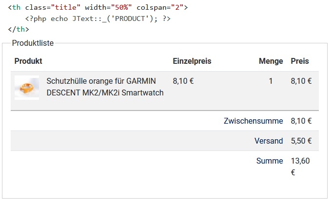

The prices are not displayed correctly on my invoice forms. Even with relatively small amounts, the currency symbol is written in the next line. That's a bit unsightly. See the attached PDF.
Is it possible to change e.g. the column widths so that there is no line break in the prices? Or can the font size for the invoice form be changed globally?

In the same view file where you added the text, you can see the line:
Code:
<th class="title" width="60%" colspan="2">
This basically says that the column with the image and the name of the product can take up to 60% of the width. Change it to 50% and it will leave more space for the other columns, preventing the browser from forcing the prices on two rows.
Another, simpler option is to edit the euro currency in the System>Currencies menu, and turn off the "Symbol and positive value space separation" and "Symbol and negative value space separation" setting. That way, you won't have a space between the price and the currency symbol, preventing the browser from separating them on two rows when not enough space is available. This will be effective everywhere on your website, so it's a great way to prevent this.
1 year 7 months ago #366545 by petloc
Code:
I had already tried that. The result is that the product description is narrower and the “Unit price” column is moved to the left. However, the columns for “Quantity” and “Price” remain as before. This did not solve the problem (see invoice_title_width_50.jpg).

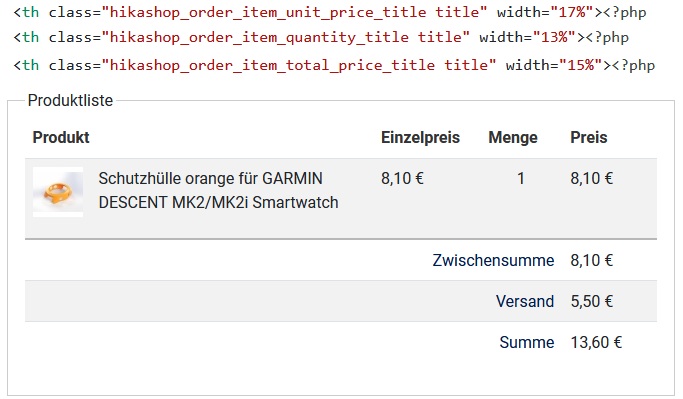

So I changed the columns for "Unit price", "Quantity" and "Price" as follows:
Code:
<th class="title" width="55%" colspan="2"> ... <th class="hikashop_order_item_unit_price_title title" width="17%"><?php <th class="hikashop_order_item_quantity_title title" width="13%"><?php <th class="hikashop_order_item_total_price_title title" width="15%"><?php
Now the invoice looks like this:
Attachment not found
I will also try your suggestion to remove the blank space in the "Currencies settings"

1 year 7 months ago #366549 by nicolas
Yes, forcing the width of all the columns is indeed better.
But yes, look into the currency settings. Changing a setting is always better than having view overrides for long term maintainability.
