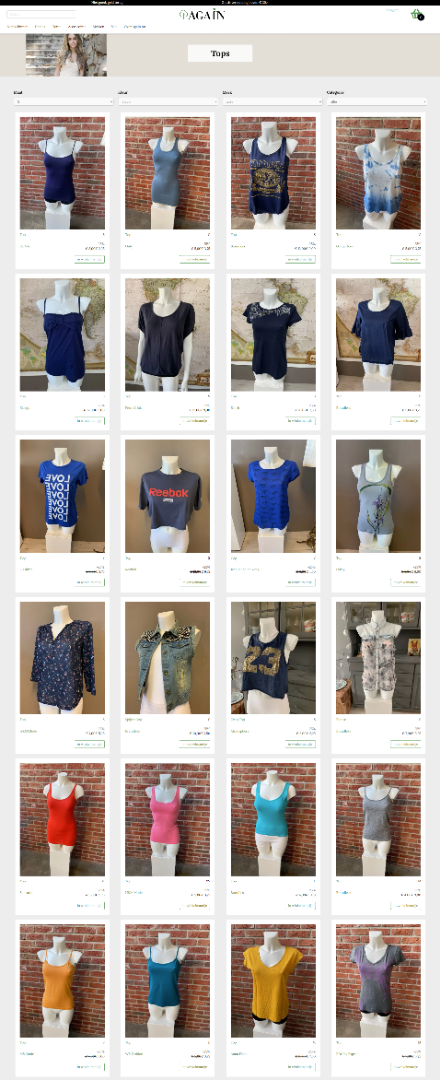

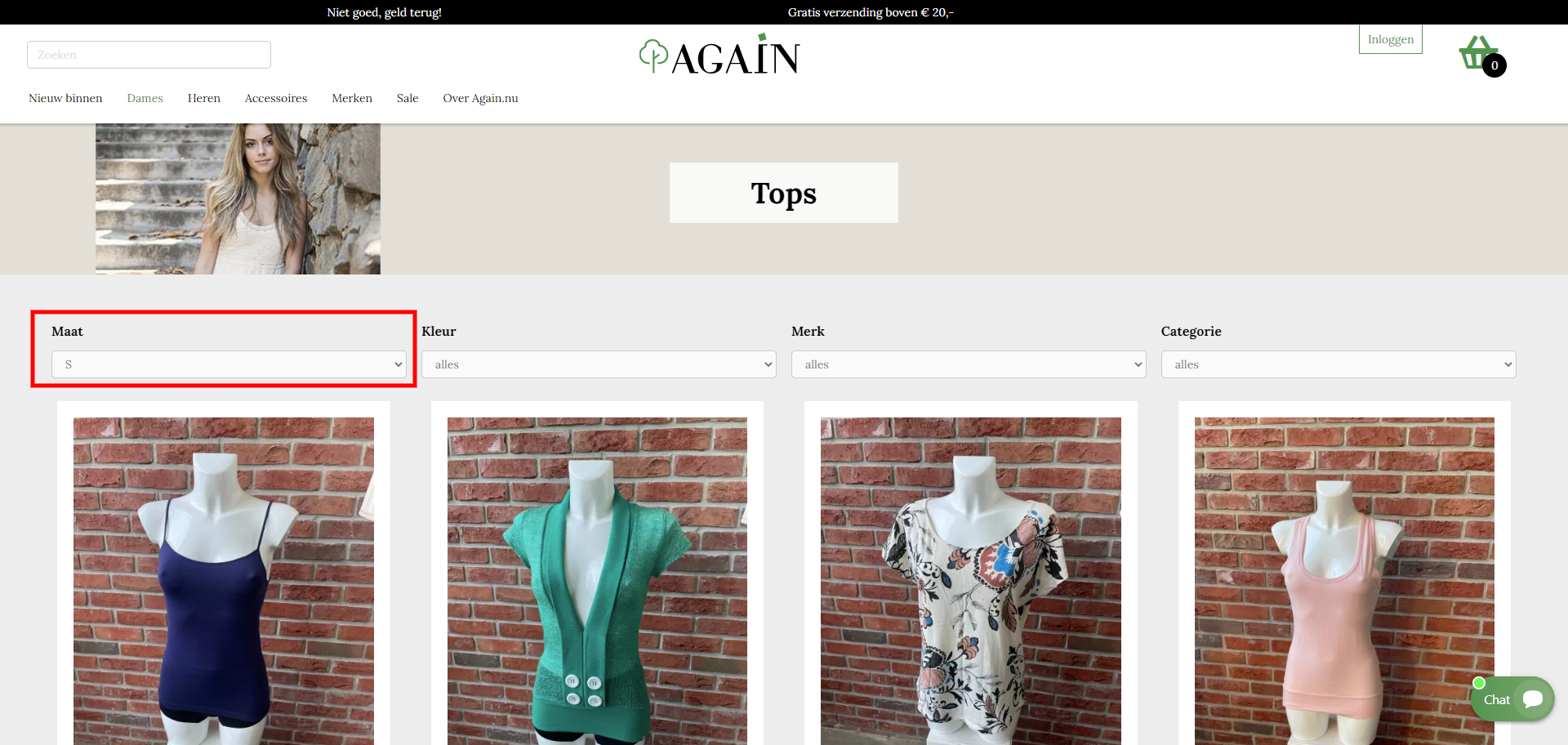

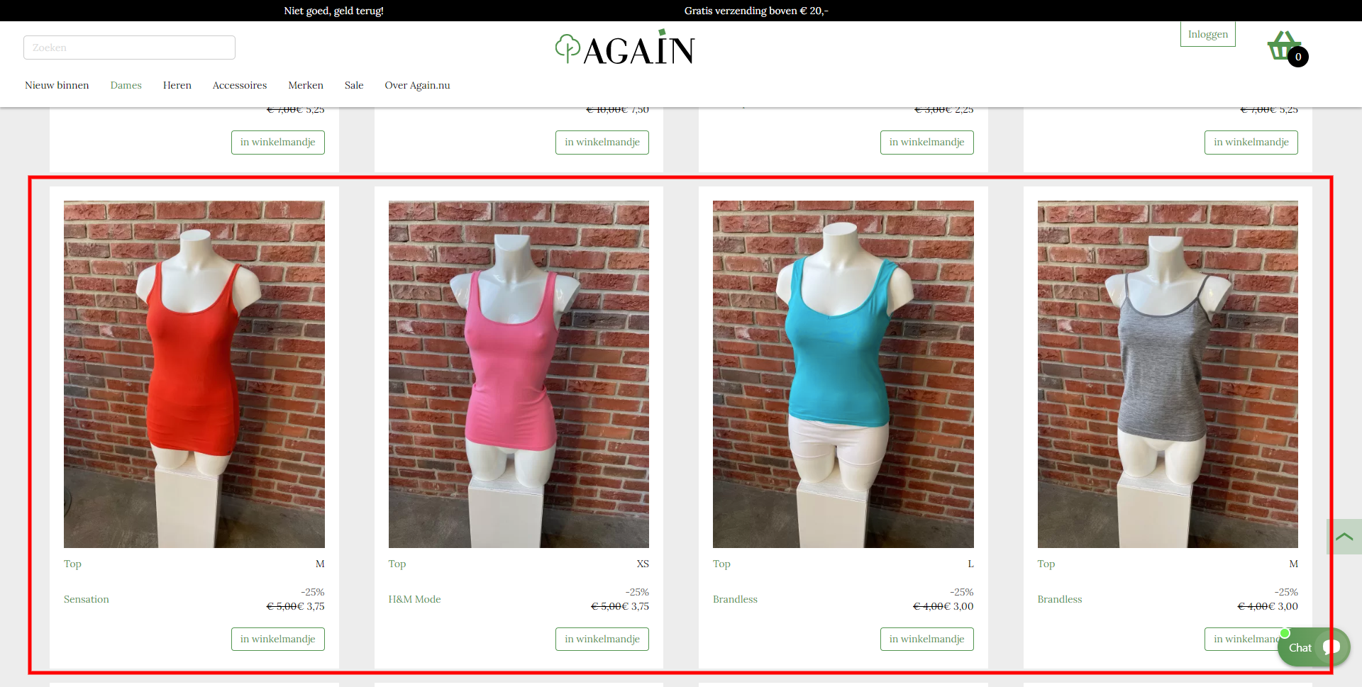

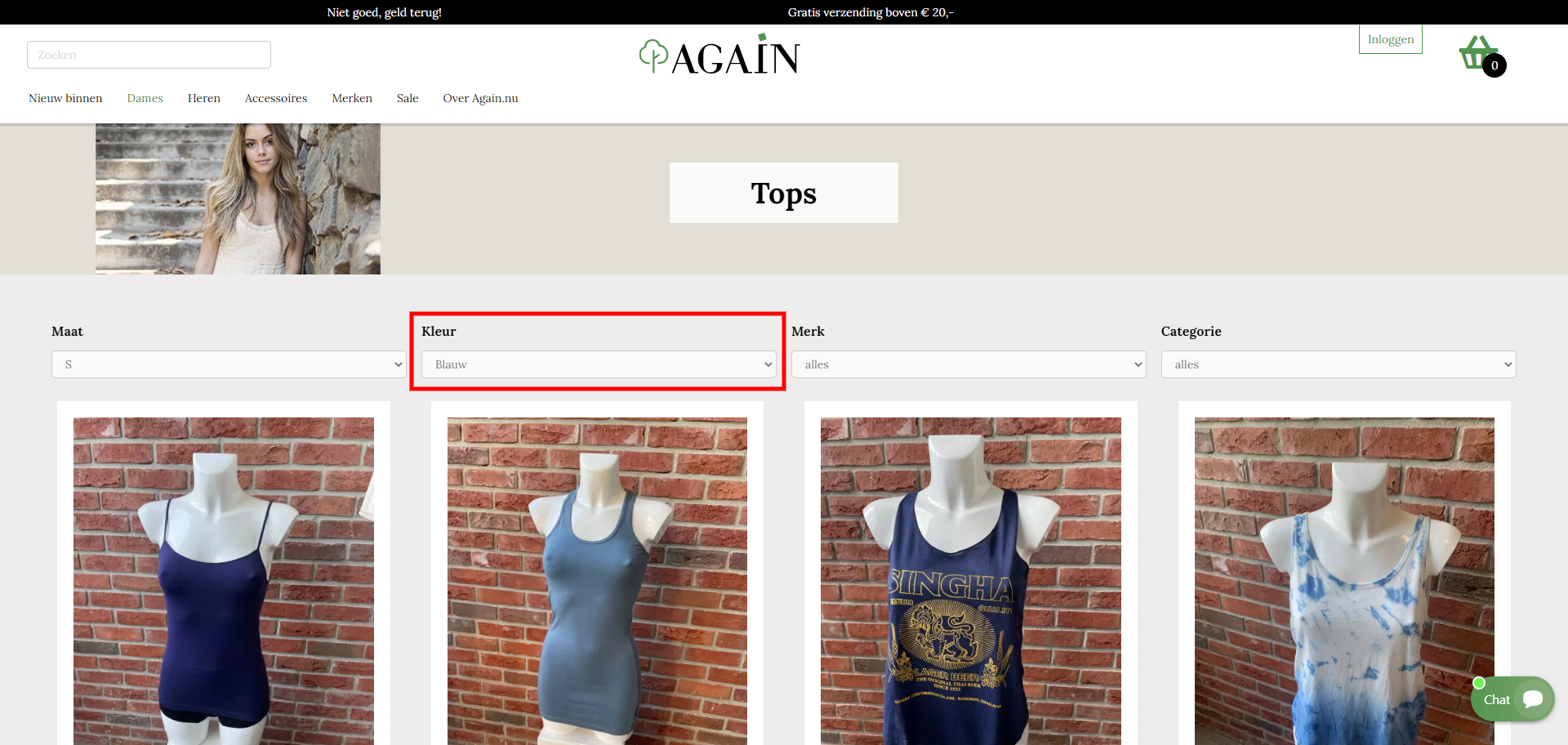

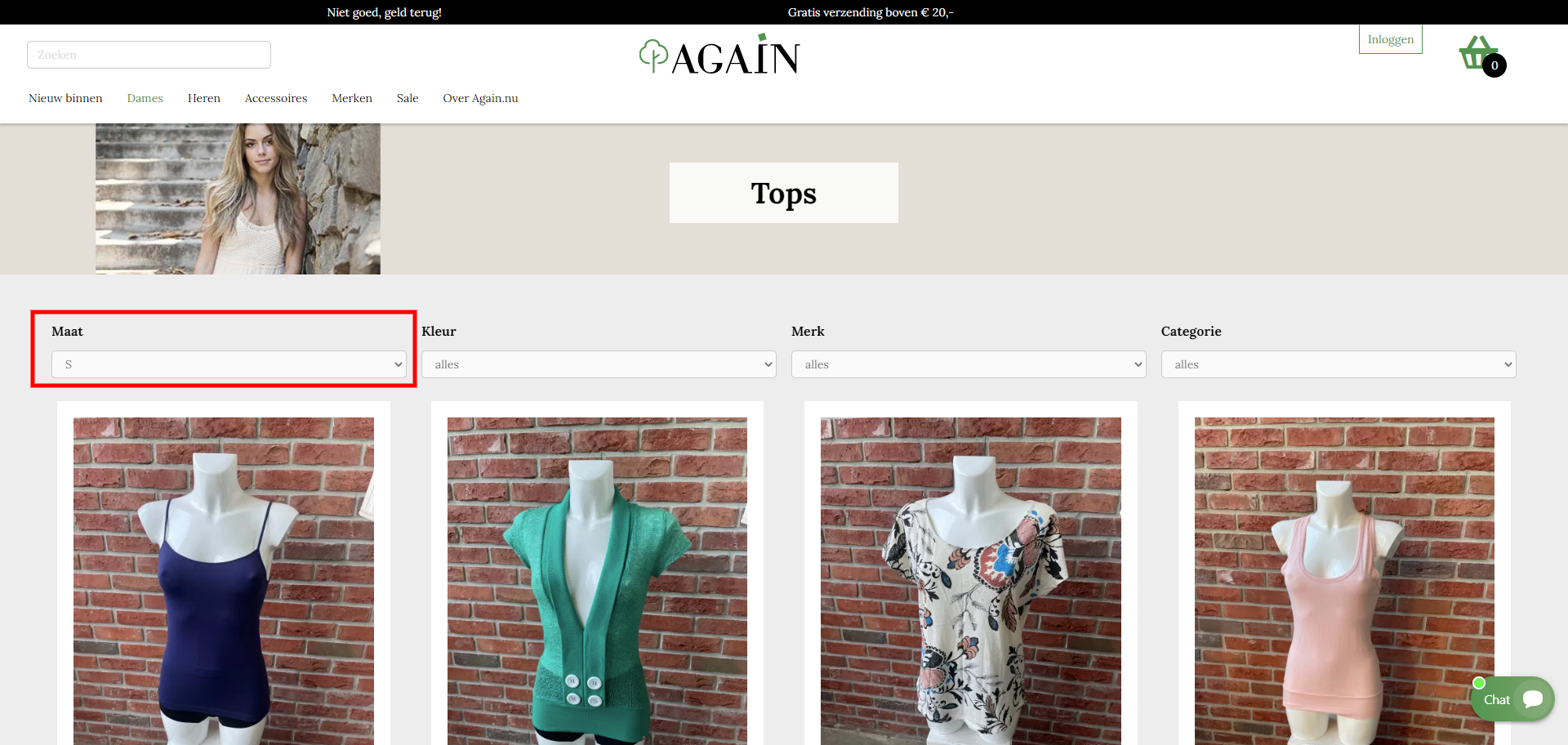

when I go to again.nu/dames/tops and filter on Maat (size) "S", then filter Kleur (color) "Blauw" (Blue)... then I see nicely the right products... BUT, when scrolling down I get different colors?!
When I refresh the page the filtering is like it should and only showing size S and color blue.
In the menu settings we have the "Infinite scroll" options turned on. When we turn that OFF, the filtering works like is should. I hope you can help me with this...

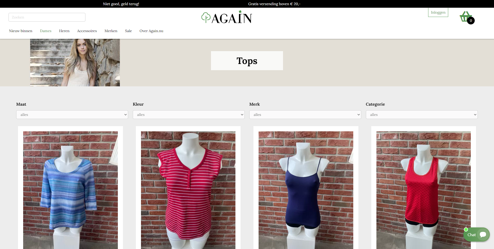

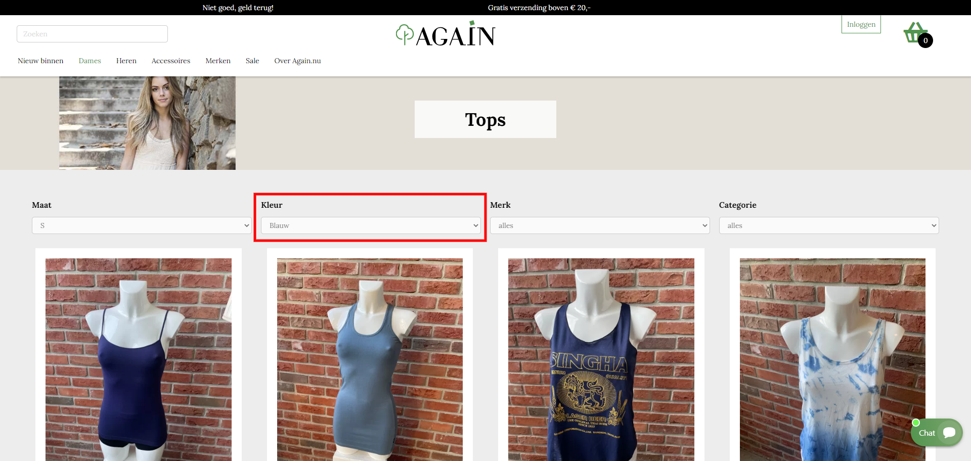

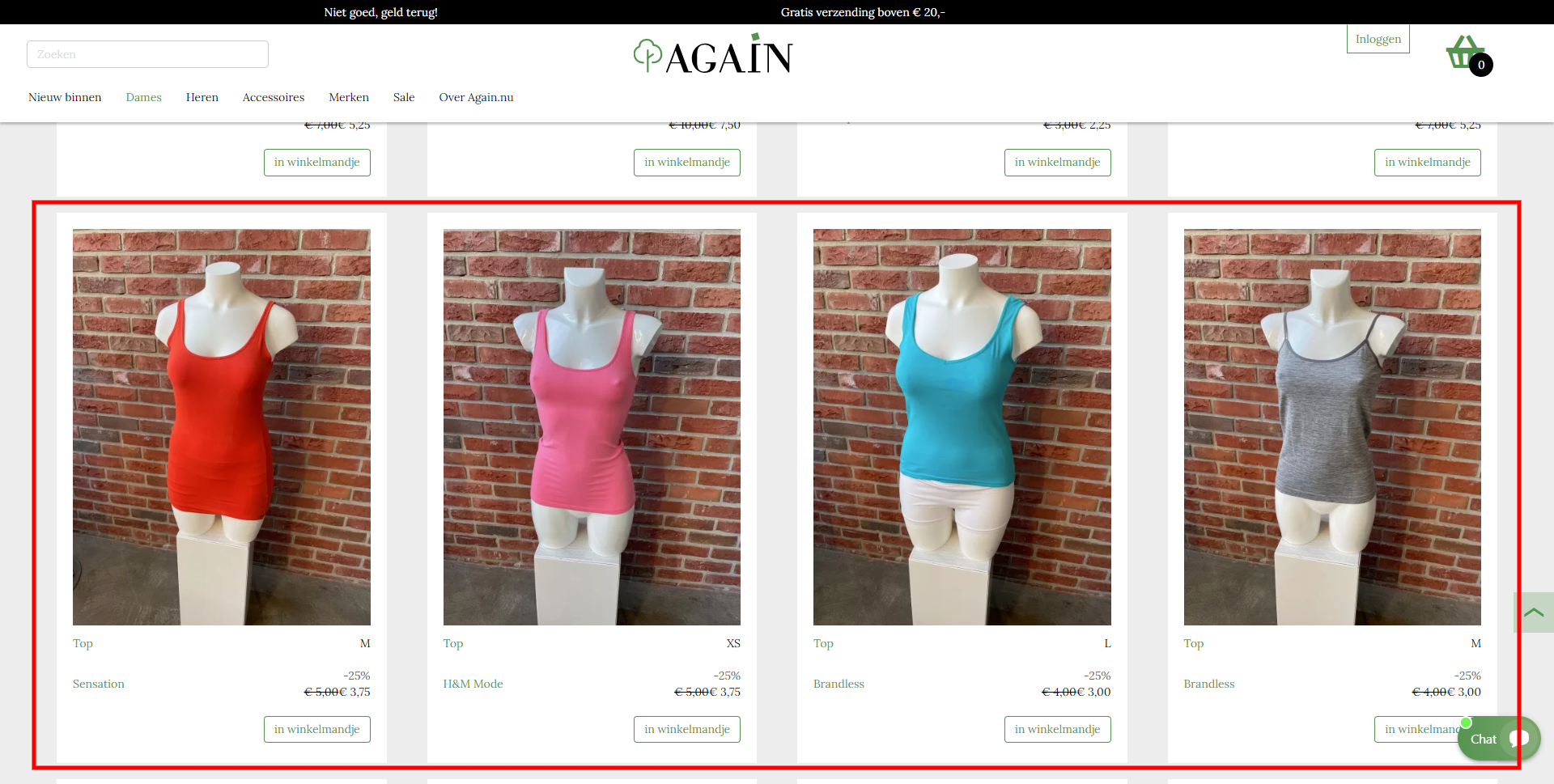

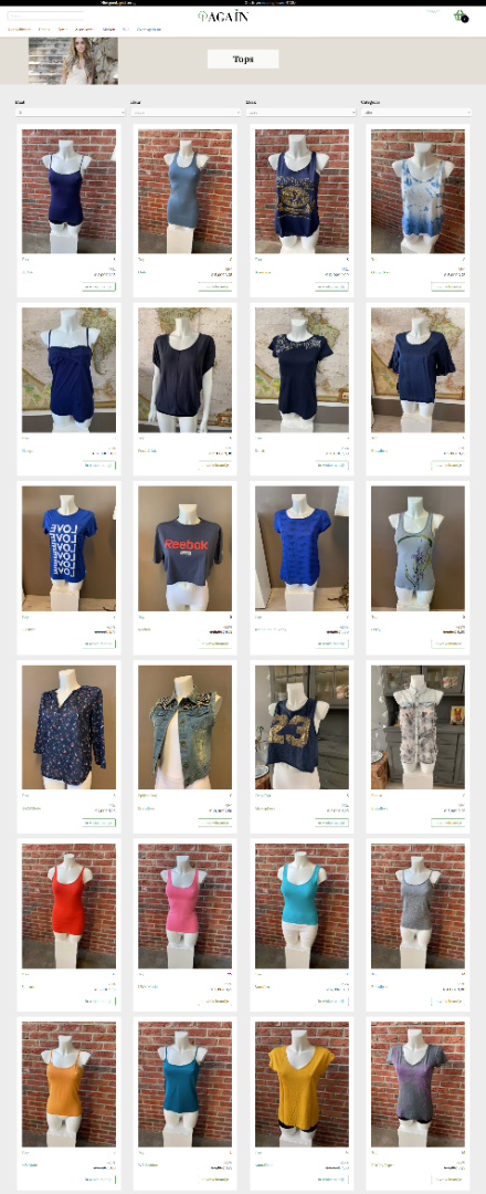

In the attachments the step 1 to 4 where you see that there are other colors the blue are showing.
This only happens when we use the option "Infinite scroll" in the menu item.

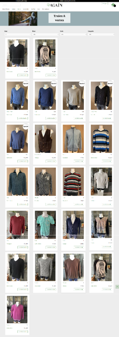

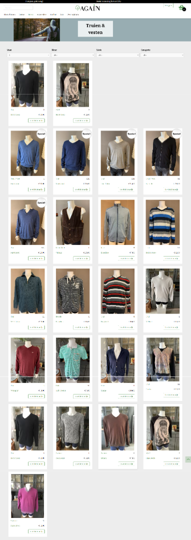

Hi there again... We have found a page where it goes wrong the hole time: again.nu/heren/truien-vesten
When you filter on size S then you get all different sizes... see attachment.
When you refresh the page you only get the 2 products size S.
Michiel
