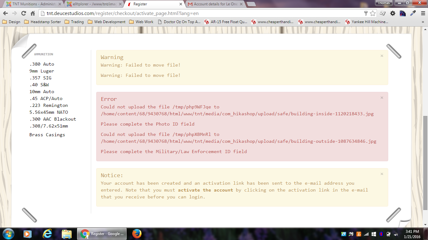

10 years 6 months ago #234372 by deuce4884
hey nicolas,
I thought I had this warning for the file move issue solved. I was doing some final checks on my site and registered a user. I got the warnings as showed in the screenshot above, but not the errors. I have commented out the lines in the file that you stated above and the upload/safe folder permissions are set to 777. The image is in the safe folder and can be viewed and downloaded. Why am I still get these errors and what else can I do? very frustrated with this. thanks for the help

10 years 6 months ago #234382 by nicolas
Replied by nicolas on topic Registration field problems
The warning comes from Joomla. And you didn't get it anymore because you had made that change:
www.hikashop.com/forum/integrations/8819...problems.html#228587
I suppose that you must have updated Joomla, and thus you lost your change in the Joomla file and thus you get that error again.

10 years 6 months ago - 10 years 6 months ago #234439 by deuce4884
I have not updated Joomla or Hikashop. I've tried a combination of everything I can think of including:
  • changing safe folder permissions
  • adding $ret = true; after the line: JLog::add(JText::_('JLIB_FILESYSTEM_ERROR_WARNFS_ERR01'), JLog::WARNING, 'jerror'); in the file libraries/joomla/filesystem/file.php
  • commenting out the lines $app->enqueueMessage(JText::sprintf( 'FAIL_UPLOAD',$file,$uploadPath . $file_path), 'error'); return false; in the file administrator/components/com_hikashop/class/file.php
  • I do not have ftp layer on
  • add a trailing slash to my temp folder in the system settings. did this after doing some research and someone said this solved their problem
Depending on what I change I may get the warnings and errors or only the warnings as shown in the screenshot here . I do have a plugin that allows the user to be added to a dealer customer group or military customer group. Those form sections have their own image uploads as well. I don't believe this has anything to do with it as in the fact that I can not get just one image to upload without getting a warning or error. But just in case it does have something to do with it here are the plugin files:
The registration is here . I'm really at a loss here and feel like ripping my hair out :unsure: . I can create a superuser for you if you need it, but I really need to figure out what is going on here and get it fixed. I really appreciate all your help.

10 years 6 months ago #234441 by nicolas
As I said, this message comes from Joomla, not HikaShop.
You'll get it if the folder of the upload directory is not writable or if PHP is not able to move the file from the tmp folder to that folder.
If it's just the message that's bothering you, and that you think that your permissions are setup properly and that the rest is working properly, then remove the line:
JLog::add(JText::_('JLIB_FILESYSTEM_ERROR_WARNFS_ERR02'), JLog::WARNING, 'jerror');
in libraries/joomla/filesystem/file.php and that will remove it.
