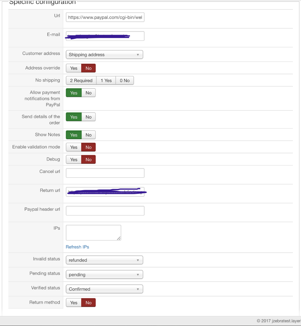

I have noticed a bug in one of my Hikashop sites. The order status is not changing to "cancelled" when clicking "cancel and return to seller" in the Paypal redirect. The order status remains "Created". This does not happen in my other Hikashop sites.
In the paypal method specific configuration I have:
Invalid status: cancelled
Pending status: pending
Verified status: Confirmed
What could I have done wrong in this site?
Thanks.

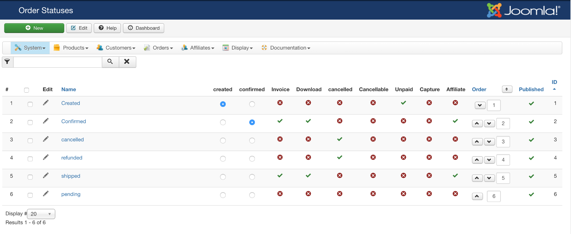

The first enabled column is "cancelled" - please see attached.
Is there something else?

Please deactivate all the statuses in that column. Then, activate "cancelled" first and then "refunded" to make sure that it is the first.
Also, make sure that the "created" status is activated in the "cancellable" column so as to authorize the customer to cancel orders with the "created" order status. Otherwise, it won't do the change.

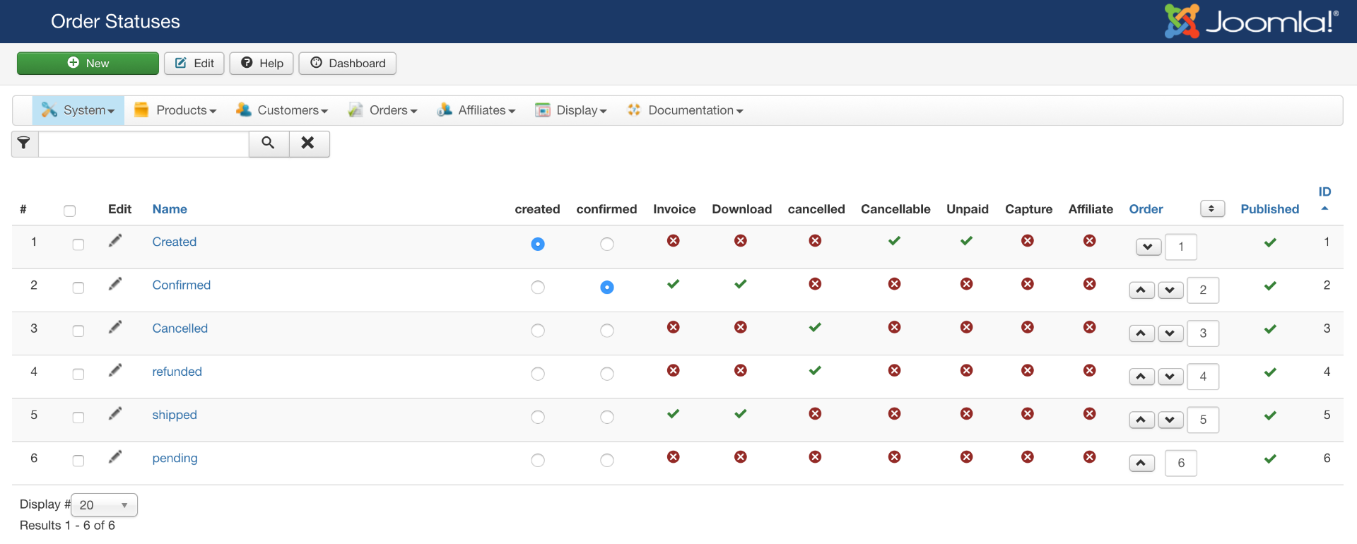

Apologies, I meant to say "The order status still remains "created".
Please see attached images.

Hello Josh,
We just tested it on our end and it worked fine, can you give us a link to your website so that we can directly reproduce your issue ?
