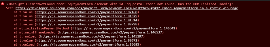

6 years 2 weeks ago - 6 years 2 weeks ago #325593 by Tsuki Dev
Replied by Tsuki Dev on topic Why NO Square API?
Hello Julie,
We can understand your frustration but we actually launched it 2 years and 6 months ago with a first version which is still working fine on several websites.
Potential users are always free to use HikaShop or Square as we are giving our best to provide them as much as we possibly can with what they need. That's why we are launching a second version of the plugin, and that's also why you often have new Hikashop version releases from Hikashop team.
However, as we explained :
1. Putting the Hikashop cart on that page will be hard as Hikashop won't allow that without huge customization. So we added a translation Keys at the beginning and end (SQUARE_FORM_START/SQUARE_FORM_END) of the page so that merchant will just have to add their custom text / image (in html) using these translation key via "Hikashop->System->Configuration->Languages"
==> In the future, we can eventually develop an integration with their checkout API, which will enable you to directly redirect your customer to the Square payment platform to pay. They will then, directly be redirected to your website.
2. We just added the support of the location ID, which can be tested by downloading the last Square version through Hikashop website and installing it.
3. When we try to remove the postal code we actually get the attached JavaScript error, which mean that they won't allow us to hide it.
We found a solution. The default value of the postal code field is now set to your customer's order billing address.
==> You'll just have to use the new "Hide Postal code" option which directly hide the post code field.
