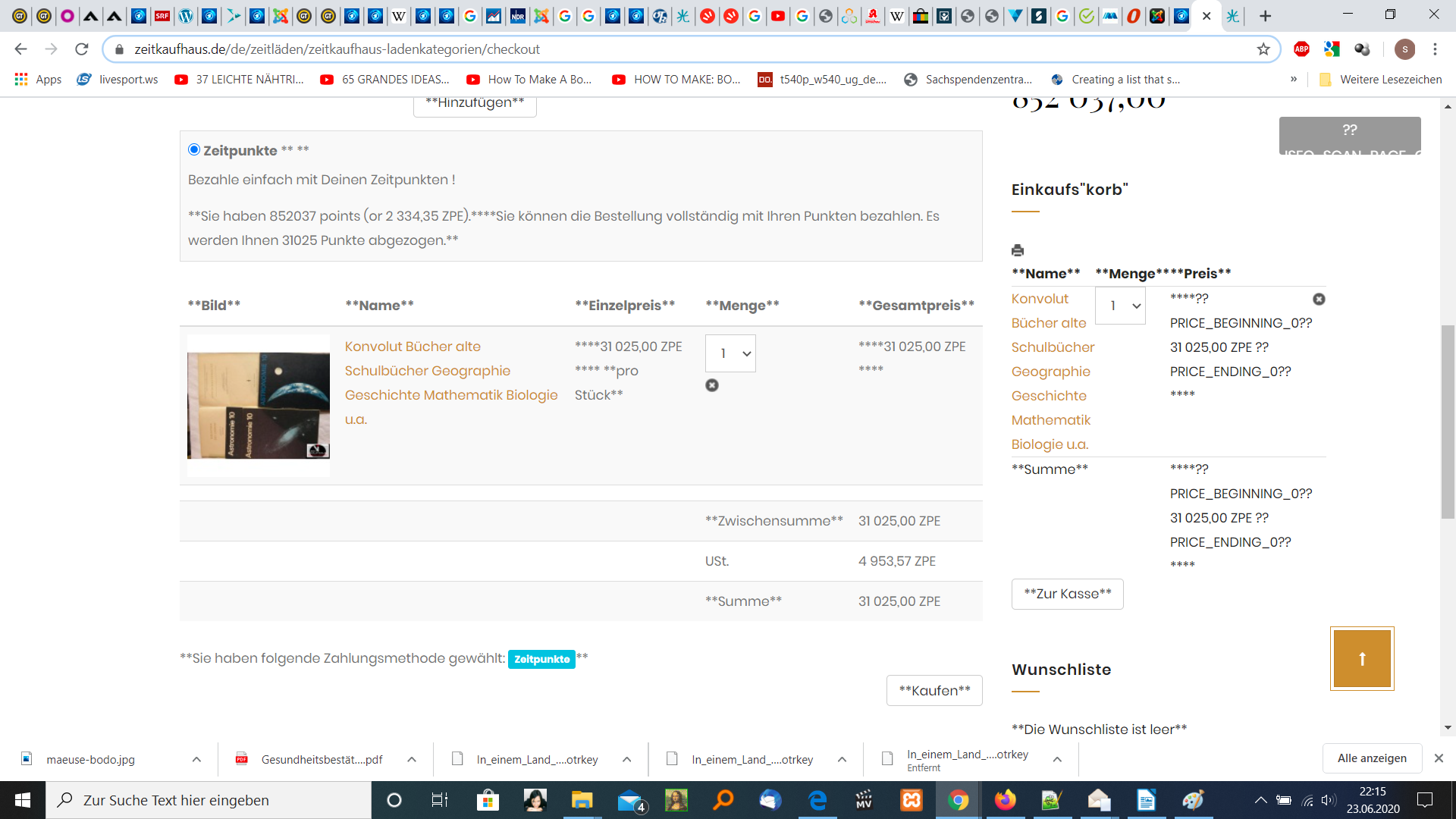

with Nicolas´ help, I can now pay with points. There´s a little problem left:
The user gets the message "You have 1080001 points (or 2 958,91 ZPE)". and "Es werden Ihnen 31025 Punkte abgezogen." (means: 31025 ZPE are deducted). That´s correct, the price is 31025 ZPE.
How and where to hide or change the information (or 2958,91 ZPE) ?
Thanks and Kind regards
Martin

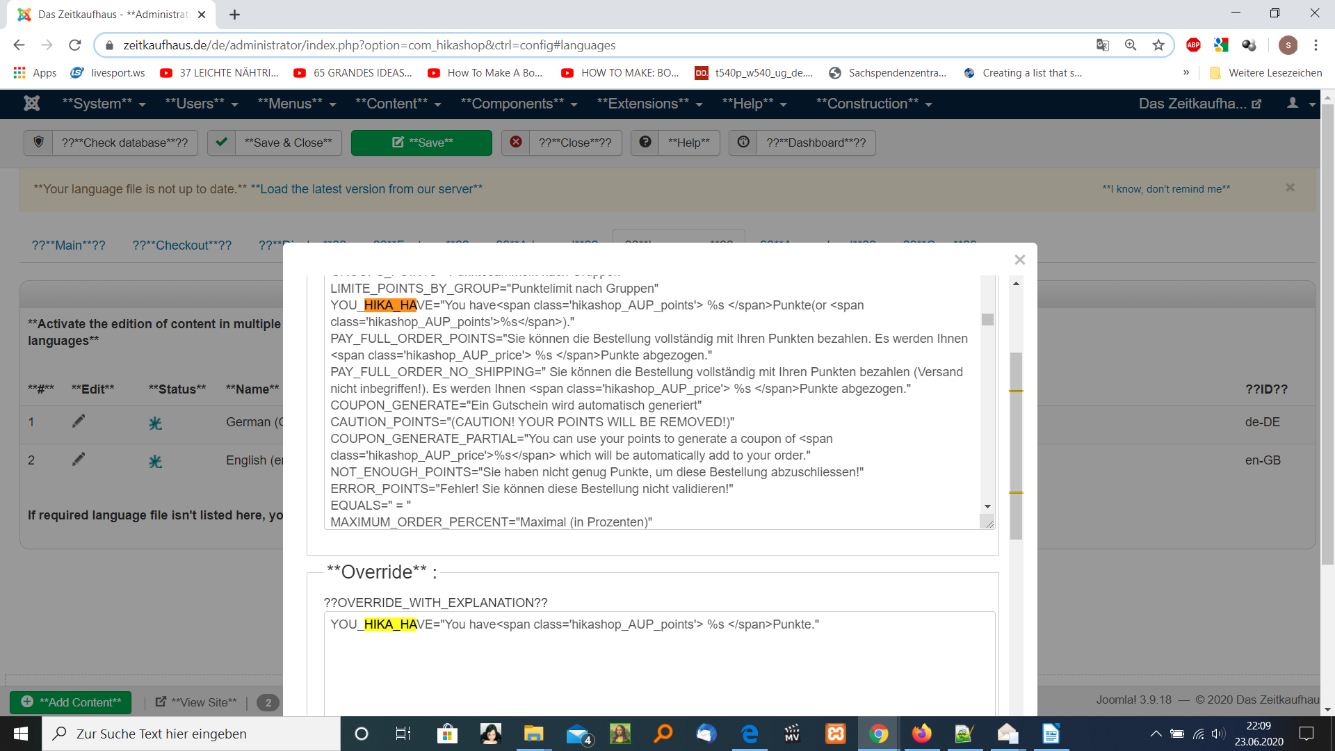

6 years 3 months ago #321014
The simplest is to do a translation override.
You can do an override of:
YOU_HIKA_HAVE="You have<span class='hikashop_AUP_points'> %s </span>points (or <span class='hikashop_AUP_points'>%s</span>)."
To have:
YOU_HIKA_HAVE="You have<span class='hikashop_AUP_points'> %s </span>points."
  • Posts: 61
6 years 3 months ago #321037
thanks. I pasted in the override of german and english language:
No effect...In Frontend still is shown:
Sie haben 1080001 points (or 2 958,91 ZPE).Sie können die Bestellung vollständig mit Ihren Punkten bezahlen. Es werden Ihnen 31025 Punkte abgezogen.
Additionally, I want to change "points" to Punkte...

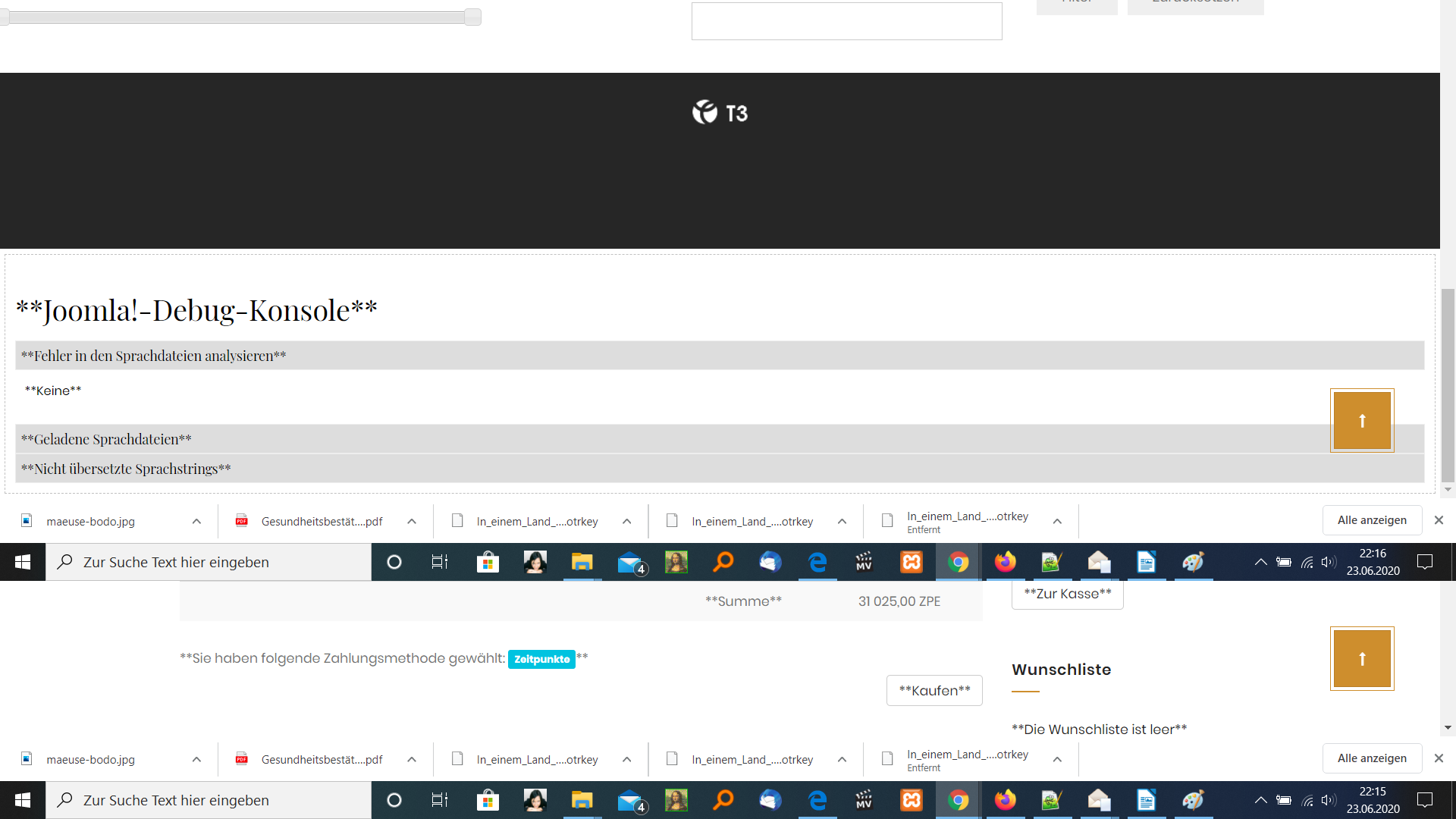

  • Posts: 61
6 years 2 months ago #321201
thanks for the hints.
0: I have a look on the products and gonna provide screenshots if the issue come back;
1. Is done, even there was no change possible in content module
2. Is done, I check it; Alternative: Is it possible to assign two or more prices to a product and assign the prices to different groups ?
3. I set the debug modus, but it shows "Fehler: keine" (Mistakes: none), please see screenshots

  • Posts: 86187
6 years 2 months ago #321281
1. "there was no change possible in content module" You mean you didn't see the option when you edited the module ? Could you provide a screenshot of the "hikashop options" tab of that module settings page ?
2. Yes. When you edit / create a price on the price listing of the product edition page, you have also an "access level" setting for the price you're editing / creating. So you can create several prices with different access levels for that.
3. Then it means that it's not that translation that is used there but another one. If you check the file plugins/hikashop/userpoints/userpoints_checkout.php you'll see all the translations used by the user points area on the checkout.
You have POINTS USERPOINTS_HAVE_X_POINTS USERPOINTS_NO_POINTS USERPOINTS_USER_FOR_DISCOUNT USERPOINTS_USE_DISCOUNT_QUESTION and USERPOINTS_EARN_POINTS
So you want to change one of these with a translation override in the same manner I explained for the other translation key YOU_HIKA_HAVE which is apparently used elsewhere.
