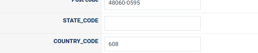

The plugin has two fields for state code and country code. Are those digits or abbreviations? This client is located in the state of Michigan in the United States.
Thank you,
-Jim Gribble
3 years 3 months ago #353718 by nicolas
Replied by nicolas on topic Looking for update
These must be 2 letter codes.
So the code for the USA is US
And the code for Michigan is MI

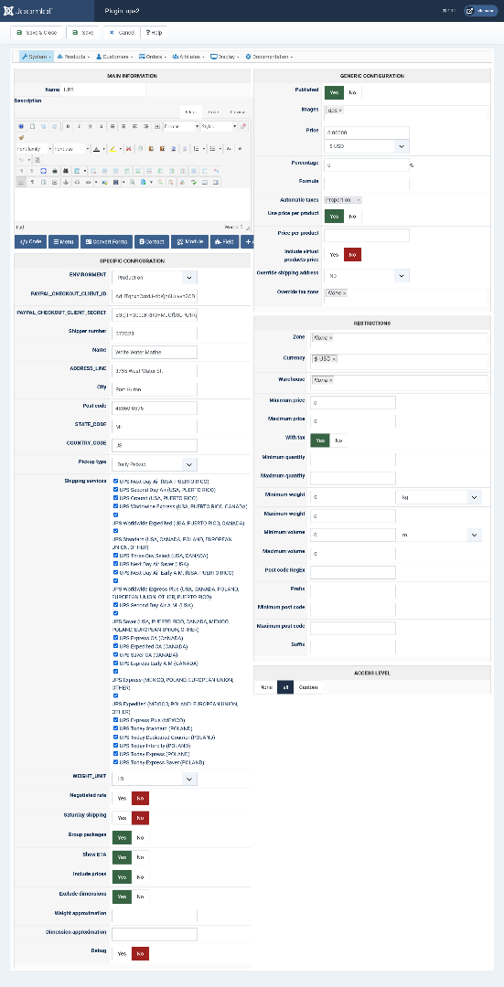

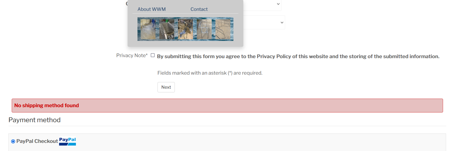

We may be a little bit closer but I am afraid it still doesn't work Or I am doing something wrong. Please see screenshot. I have the new plugin installed and configured and published. But it still doesn't show in front end. I have scoured settings and documentation to no avail. If you go here and attempt to check out you will see what I mean. jimg57.sg-host.com/en/buy-boat-lifeline-...anchion-bases-online
There are other display issues but this is the big one - the one that is still making it impossible to launch. Would you be willing to log in and take a quick look? If there is a service fee, okay. It may well be a setting I just can't comprehend. I thought that if we published a shipping method, it would publish to checkout. Maybe not...

3 years 3 months ago #353803 by nicolas
It's not that simple.
UPS requires the product to have a weight and potentially dimensions. So please check that it is the case.
Also, on your screenshot, it seems that you, as a customer, didn't enter your shipping address yet (you need to click on the "next" button above the red error message to validate the fields you filled in the address form above, so that the UPS shipping plugin sees your address and send it to UPS to be able to retrieve the rates).
3 years 3 months ago - 3 years 3 months ago #353806 by jgribble
Replied by jgribble on topic Looking for update
All products do have a weight. And volume. I can prove it. You can have a login to see it for yourself. I did as you suggested relative to filling in address/name. That is not the problem. I never thought so. Please see screenshot. We desperately need to get this working, and if there's a service charge okay. To my knowledge your plugin is properly configured and published. So far it doesn't work.

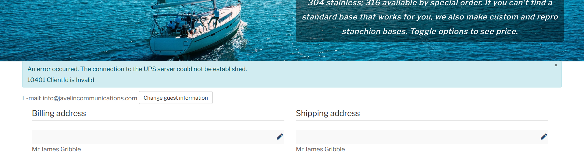

3 years 3 months ago - 3 years 3 months ago #353808 by jgribble
I tried to pay and a new error appeared. Seems to be a common thing, not something I did. How do I fix it?
An error occurred. The connection to the UPS server could not be established.
10401 ClientId is Invalid
I thought this might have something to do with sandbox mode. But no that's not it. Whether payment plugin is set to sandbox or production, error still occurs. The plugin is not connecting to UPS.

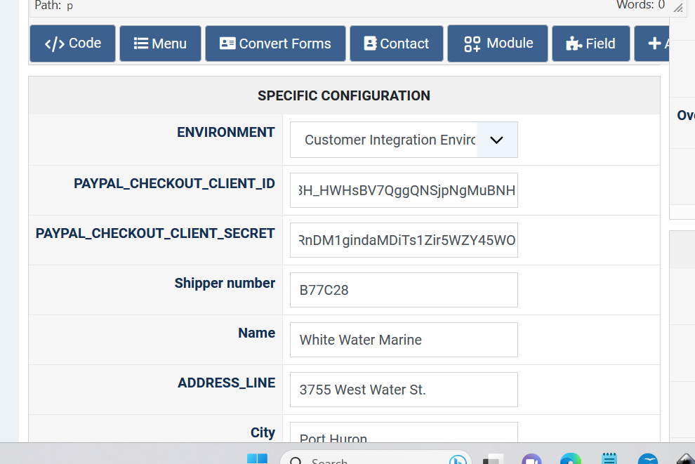

3 years 3 months ago #353810 by jgribble
In the UPS plugin, I have been wondering why am asked to I input Paypal client ID and Paypal secret key? Shouldn't these be coming from UPS? Is that our entire problem here? I have read that the new UPS API does have both client ID and secret key.

3 years 3 months ago #353812 by nicolas
I'm not doubting you. So far you hadn't said you had set a weight and dimensions in your product, and since that's a common problem when people are configuring their products, I was just pointing at that possibility.
The error message indicates that the client ID provided in your shipping method settings page is wrong.
You indeed need to provide your UPS client id and client secret.
I used the paypal translation keys there, but because you didn't update your HikaShop you don't have the translations for these and thus, instead of seeing "client id" and "client secret", you see the translation keys.
Go in your HikaShop configuration page, and under the Languages tab, edit your language file. There, click on the "load latest version from our server" button and save. When you go back to the shipping method, you'll see just "client id" and "client secret" as everyone else using the plugin in the future will see.
3 years 3 months ago - 3 years 3 months ago #353814 by jgribble
So, yes, the plugin you gave me had the wrong field labels? I never suspected. The field labels which say "Paypal" are wrong. Right?
Then I will do as you suggest and we'll have another go. However, I have a lot of other language overrides in place. Please assure me they won't be overwritten?
I am going to look upon this process at a beta test and be patient and cheerful, expecting some teething issues. I know we will eventually get it all working. It's never easy going first.
