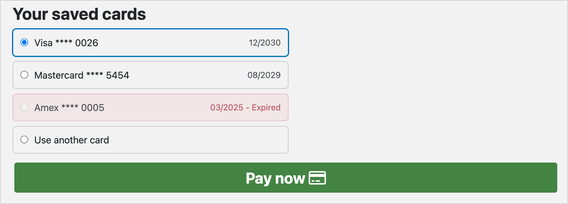

  • Customers can save their cards : When enabled, customers with an account see a "Save this card for my next purchases" box under the card form, and the cards they saved above it on their next payments. PayPal keeps the cards: your website only stores the reference PayPal gives for each card, with its brand, last four digits and expiry date to display it, never the card number. Your PayPal app needs the "Save payment methods" feature. It is off by default.
With the setting enabled, a customer who saved cards picks one on the payment page, the last saved first; an expired card is shown but cannot be picked, and "Use another card" opens the card form:
Saved cards on the PayPal Checkout payment page

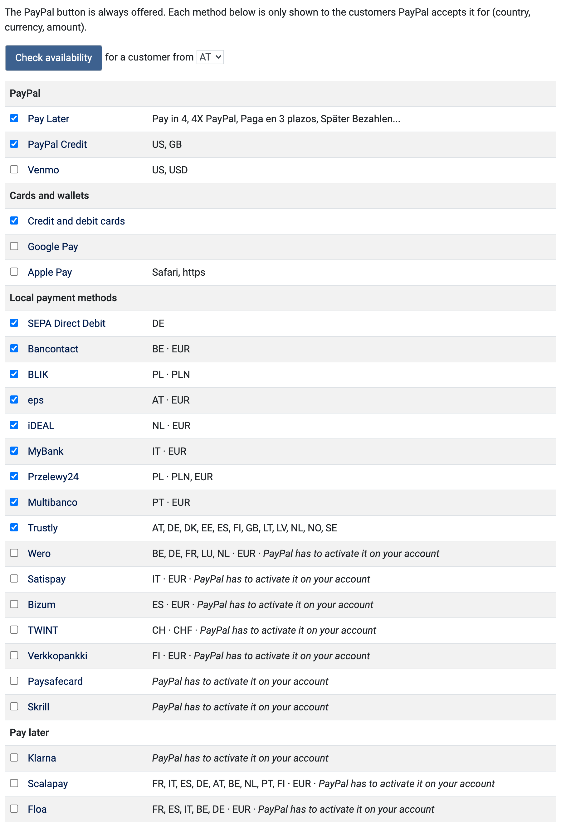

Payment methods
The PayPal button is always offered. The table lists the other payment methods the plugin can offer at the end of the checkout, grouped in PayPal (Pay Later, PayPal Credit, Venmo), cards and wallets (credit and debit cards, Google Pay, Apple Pay), local payment methods (SEPA Direct Debit, Bancontact, BLIK, eps, iDEAL, MyBank, Przelewy24, Multibanco, Trustly, Wero, Satispay, Bizum, TWINT, Verkkopankki, Paysafecard, Skrill) and pay later (Klarna, Scalapay, Floa). Check the ones you want to offer. Each row gives the countries and currencies the method works with, and says when PayPal has to activate the method on your account first.
A checked method is only shown to the customers PayPal accepts it for: their country, the currency and the amount of the order. The local payment methods which PayPal offered before (Bancontact, iDEAL, eps...) are only loaded for the customers of their countries.
Check availability : this button asks PayPal which methods a customer would be offered right now, with the client ID of the form. With the sandbox, choose the country of the customer; with a live account, PayPal answers for the country you are browsing from. SEPA Direct Debit cannot be checked in advance.

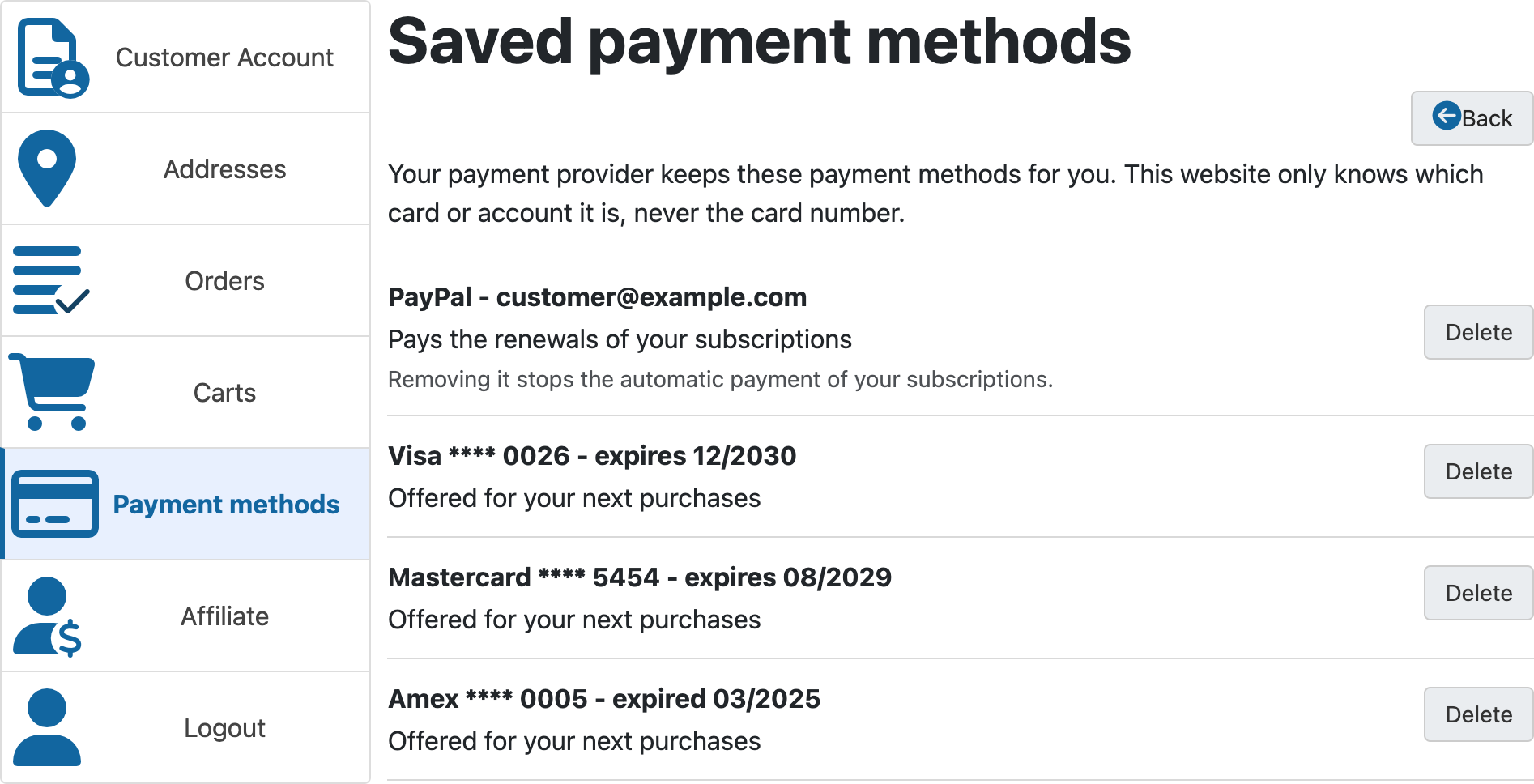

Subscriptions and saved payment methods
The PayPal Checkout plugin can charge the renewals of a subscription automatically, when used together with a subscription plugin such as the HikaShop Recurring Orders plugin or HikaSerial.
How it works:
  • On the payment page of a subscription order, the order summary says how often the subscription renews, the date of the next charge, and that the PayPal account or card used will be charged automatically for each renewal. Only the payment methods which can be charged again are offered: the PayPal button and the card form. Pay Later, Google Pay, Apple Pay and the local payment methods are left out.
  • The customer pays with PayPal, where they approve the future charges, or with a card, which goes through 3D Secure when the bank asks for it. PayPal then keeps that PayPal account or card.
  • Your website only stores the reference PayPal gives for it, never card data. For each renewal, the HikaShop cron task asks PayPal to charge it, without the customer.
  • Customers see the payment methods PayPal keeps for them in the "Payment methods" page of their account, where they can remove them. Removing the one of a subscription stops its automatic renewals.
The subscription notice in the order summary of the payment page The Payment methods page of the customer account
