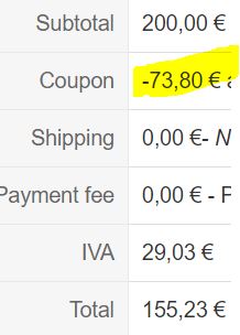

Yes, I've created the coupon in the newsletter tag with the product category tax and for a specific product.
Have a look at this fantastic calculation:
The topic has been locked.
9 years 2 weeks ago #272793
Happy to see that our correction able you to generate your coupon thanks for your return, now for this result (that is a different subject).
The cart view respect your display configuration, and you choose to display product price WITHOUT taxes, and so If add your taxes to your subtotal, I get this :
200 + 46 (23% of 319.32 Euro) = 246 Euro.
As you know, a discount or a coupon have to calculated from the total price (with taxes), then :
30% of 246 Euro = 73.8 Euro
So calculation are good, the point is display options.
Maybe display both, price without & with taxes would be a good compromise and more understandable.
Hope this will help you.

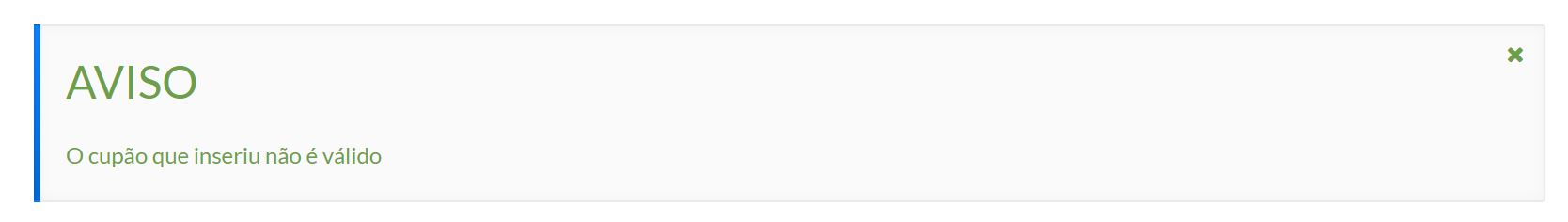

I'm sorry, I don't understand this and I'm really about to give up:
1- I used to have the coupon working correctly, that is, applied to the price before taxes and only then adding VAT.
2- No matter what I do now, I can't make the coupons working again. They are generated in Hikashop correctly, but when I send one now I get this:
This is really frustrating after several days around...

I don't even add any coupon to the checkout and I already get the message the coupon isn't valid!??

Yes, I have got the error: "Coupon is not valid" although I'm not even entering any coupon.
Whatever coupon is entered is always invalid.
This happens in all products.

Yes, I was getting the error message without entering the coupon.
Now it's gone. Have you changed anything?

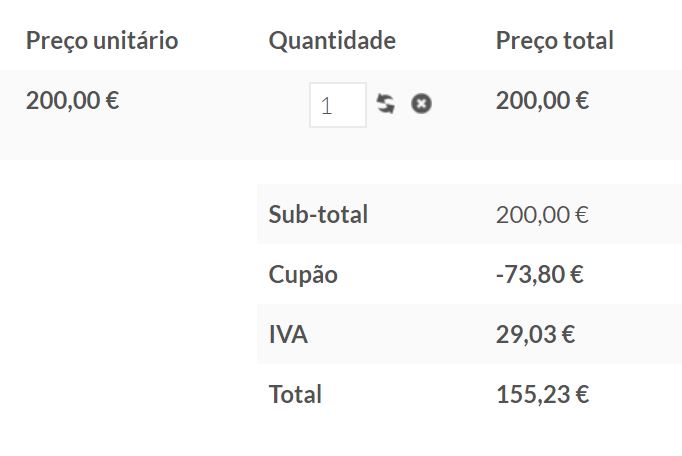

Hello, this STILL doesn't work!
Look at this discount:
I want the 30% discount to be applied BEFORE the taxes. So this is the tag I'm using:
{hikashop_coupon:0||||30|0|1|[name][key][value]|72|14}
This includes the product and the tax category of the product.

You do not provide the details of the coupon configuration (in the HikaShop backend) and your HikaShop configuration.
I am sorry but we can't analyze anything in such situation.
Please provide concrete details in order to understand your issue and your configuration.
Your screenshot does not explain anything.
