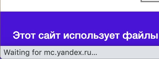

4 years 7 months ago - 4 years 7 months ago #340205 by lousyfool
Hi again,
When loading a product details page (e.g. aketo.kz/datchiki/temperatury/termosopro...ct/dts3225-rt1000-v2 ), basically all of the waiting time is spent with staring at this in the browser window's bottom left corner:
Apparently, that's for mc.yandex.ru/metrika/tag.js and maybe similar (I haven't checked each and every bit). Just look at such page's waterfall. Again, there are plenty of analytical tools around, you only need to use and read them correctly.
Nothing related to HikaShop. Get rid of the other hold-ups on your site, at least temporarily for testing purposes if other tools don't work for you, and see/verify. If you still need them in the long run, consider loading such time consuming stuff after all other code (= defer respective code lines to the very end of page).
Last edit: 4 years 7 months ago by lousyfool.
