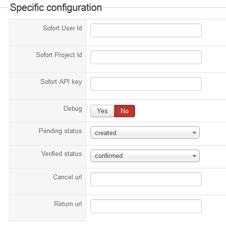

Additional Information
- Sofort user ID: The user (customer) id corresponding to your Sofort account.
- Sofort project ID: The project id you're currently working with. Viewable from your Sofort account.
- Sofort API key: The API Key you will get from your Sofort account.
- Debug : You can activate the debug mode of the Sofort payment plugin. If you do so, informations about each notification received from Sofort will be logged in the payment log file. You can see and modify the location of this file in the configuration page of HikaShop
- Cancel url : The url you want your users to be redirected to when they cancel the order from the Sofort interface. By default, they will be redirected to the first step of the checkout process.
- Return url : The url you want your users to be redirected to when they finish their payment on the Sofort interface. By default, they will be redirected to the after_end page of the checkout process which will thank them for their order.
- Pending status : Here, you can select the status to set to an order if the plugin receives a pending notification from Sofort for an order. A pending notification means that the customer entered his payment information but that Sofort could not yet receive the funds. In that case, we highly recommend you to check your Sofort account, the order information, and maybe contact your customer, and decide yourself what to do with the order.
- Verified status : Here, you can select the status to set to an order if the plugin receives a successful completion notification from Sofort for an order.
