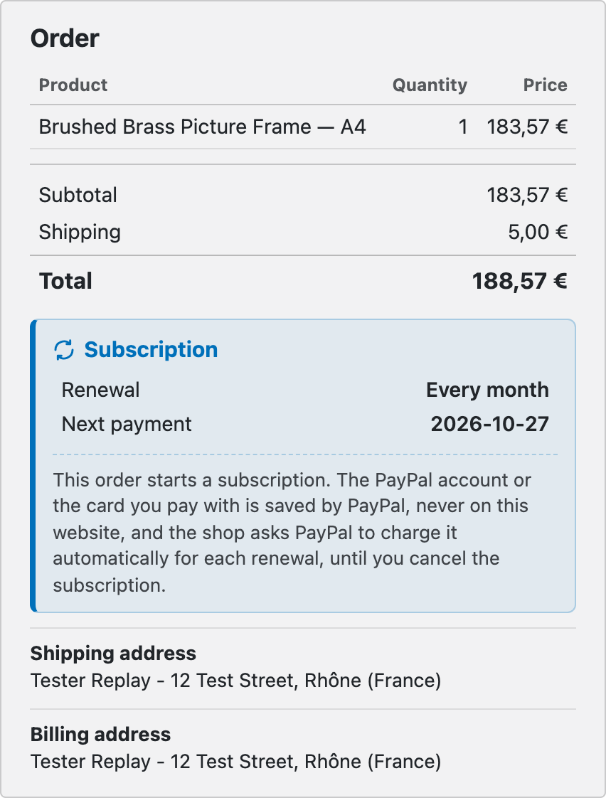

Recurring payments (Vault)
The PayPal Checkout plugin supports payment method vaulting for recurring payments. When used together with a recurring orders plugin (such as the HikaShop Recurring Orders plugin), customers can save their PayPal account for future automated charges.
How it works:
  • When a customer places a recurring order, they are redirected to PayPal where they approve the payment and consent to saving their payment method for future charges.
  • After approval, the payment is captured and a vault token is stored on the customer's HikaShop account.
  • For subsequent recurring orders, the cron job charges the saved payment method automatically via the PayPal API, without requiring the customer to log in to PayPal again.
Requirements:
  • Your PayPal account must have Vault permissions enabled. In your PayPal Developer Portal app settings, ensure the "Vault" feature is enabled under "Advanced features".
  • A recurring orders plugin must be installed and active. It sets the recurring flag on the order, which triggers the vault flow automatically.
  • The HikaShop cron task must be set up to process recurring charges.
No additional configuration is required on the PayPal Checkout payment method itself. The vault functionality activates automatically when the order has a recurring flag.
Compatibility with HikaSerial: This vault support is fully compatible with HikaSerial's recurring subscription system. When a customer purchases a HikaSerial subscription product using PayPal Checkout, the payment method is automatically vaulted. Subscription renewals created by HikaSerial are then charged automatically using the stored vault token. This replaces the need for the older "PayPal Recurring" payment plugin (plg_hikashoppayment_paypal_recurring) which used the deprecated PayPal NVP/IPN API.
