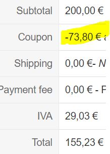

Yes, I've created the coupon in the newsletter tag with the product category tax and for a specific product.
Have a look at this fantastic calculation:

Happy to see that our correction able you to generate your coupon thanks for your return, now for this result (that is a different subject).
The cart view respect your display configuration, and you choose to display product price WITHOUT taxes, and so If add your taxes to your subtotal, I get this :
200 + 46 (23% of 319.32 Euro) = 246 Euro.
As you know, a discount or a coupon have to calculated from the total price (with taxes), then :
30% of 246 Euro = 73.8 Euro
So calculation are good, the point is display options.
Maybe display both, price without & with taxes would be a good compromise and more understandable.
Hope this will help you.

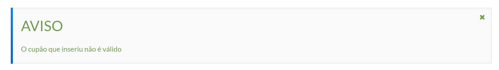

I'm sorry, I don't understand this and I'm really about to give up:
1- I used to have the coupon working correctly, that is, applied to the price before taxes and only then adding VAT.
2- No matter what I do now, I can't make the coupons working again. They are generated in Hikashop correctly, but when I send one now I get this:
This is really frustrating after several days around...

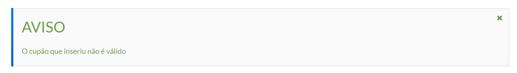

I don't even add any coupon to the checkout and I already get the message the coupon isn't valid!??

I don't see the problem on my end.
The coupons generated by the AcyMailing integration are always published and that error means that the coupon has been unpublished.
Can you do a test one more time and provide a screenshot of the settings of the generated coupon ?

Yes, I have got the error: "Coupon is not valid" although I'm not even entering any coupon.
Whatever coupon is entered is always invalid.
This happens in all products.

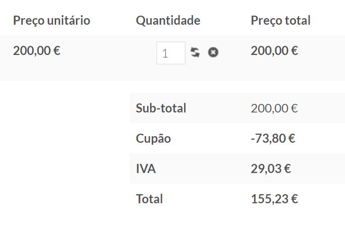

Hello, this STILL doesn't work!
Look at this discount:
I want the 30% discount to be applied BEFORE the taxes. So this is the tag I'm using:
{hikashop_coupon:0||||30|0|1|[name][key][value]|72|14}
This includes the product and the tax category of the product.
The topic has been locked.

You do not provide the details of the coupon configuration (in the HikaShop backend) and your HikaShop configuration.
I am sorry but we can't analyze anything in such situation.
Please provide concrete details in order to understand your issue and your configuration.
Your screenshot does not explain anything.
