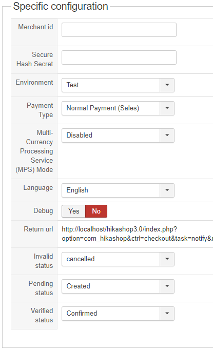

Additional Information
- Merchant ID: Your SiamPay Merchant ID.
- Secure Hash Secret : Your SiamPay Secure Hash Secret
- Environment: You can choose here the the environment to use. "Test" is used for testing the SiamPay payment method with a test account, so that you can check if your parameters are right and see if data are transmitted. This environment is used during the test phase and transactions will not be credited, once your method is rightly configured, you can switch to the Production/Live mode with your real account and if you have a problem, you can try the Testing/Debug mode.
- Payment Type : Here, you can select which kind of SiamPay payment type you want. You can either use the "Normal Payment (Sales)" (recommended) or the "Hold Payment (Authorize only)" mode.
- Multi-Currency Processing Service (MPS) Mode : Here, you can enable the MPS mode to dynamically convert your customers order prices to a different currency.
- Language : Here, you can select the language use through the SiamPay platform.
- Debug : You can activate the debug mode of the SiamPay payment plugin. If you do so, informations about each transaction made with SiamPay will be logged in the payment log file. You can see and modify the location of this file in the configuration page of HikaShop.
- Return url : The url you want your users to be redirected to when they finish their payment on the SiamPay interface. By default, they will be redirected to the after_end page of the checkout process which will thank them for their order.
- Invalid status : Here, you can select the status to set to an order if the plugin receives an invalid notification from SiamPay for an order.
- Pending status : Here, you can select the status to set to an order if the plugin receives a pending notification from SiamPay for an order.
- Verified status : Here, you can select the status to set to an order if the plugin receives a successful completion notification from SiamPay for an order.
