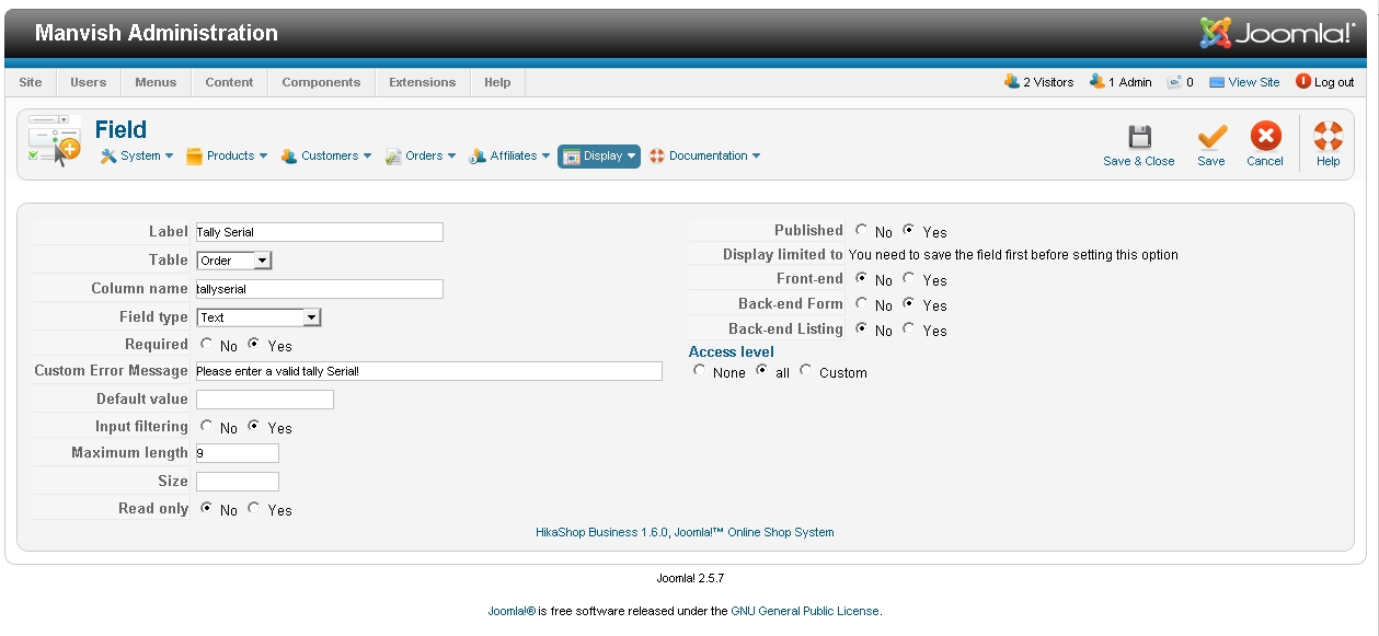

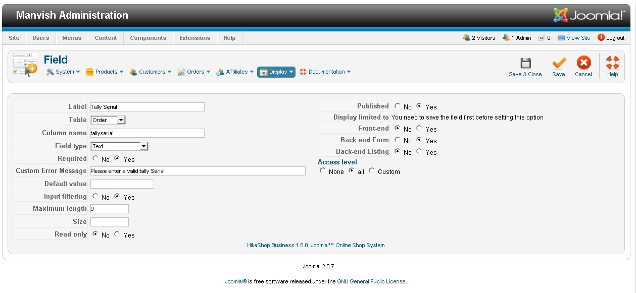

  • Posts: 83
13 years 11 months ago #68812
Please find the attached screenshot of adding a custom field "tallyserial".
I've gone through the below custom field documentation but there are some areas which are not explained.
www.hikashop.com/en/support/documentatio...shop-field-form.html
Could you please brief me about the following fields?
1. Input Filtering
2. Maximum Length and Size
3. Read Only
4. Front end, Backend form and Backend listing
User should be restricted to input only 9 digits; not less than 9 or greater than 9 and it should not be alphanumeric.

13 years 11 months ago #68825
How can I get the serial on my confirmed status mail ?
The serial would be added in the confirmation email automatically.
Now serials could be generated and attached to the orders, so the rest of HikaSerial would work too.
I have check your email configuration and it will be good.
If you want to check it manually, open a "confirmed" order and changed his status to "shipped".
Check the "notify customer" checkbox and look and the email content which would be send to the customer. The HikaSerial part would be displayed.
1. Input filtering is a security feature. It add protection for XSS (removing html and javascript tags).
2. It add a basic limitation in the text field (you want "9")
3. It put the field as read only (you don't want it)
4. It indicate where display the custom field (you want the front and the backend. Not the backend listing).

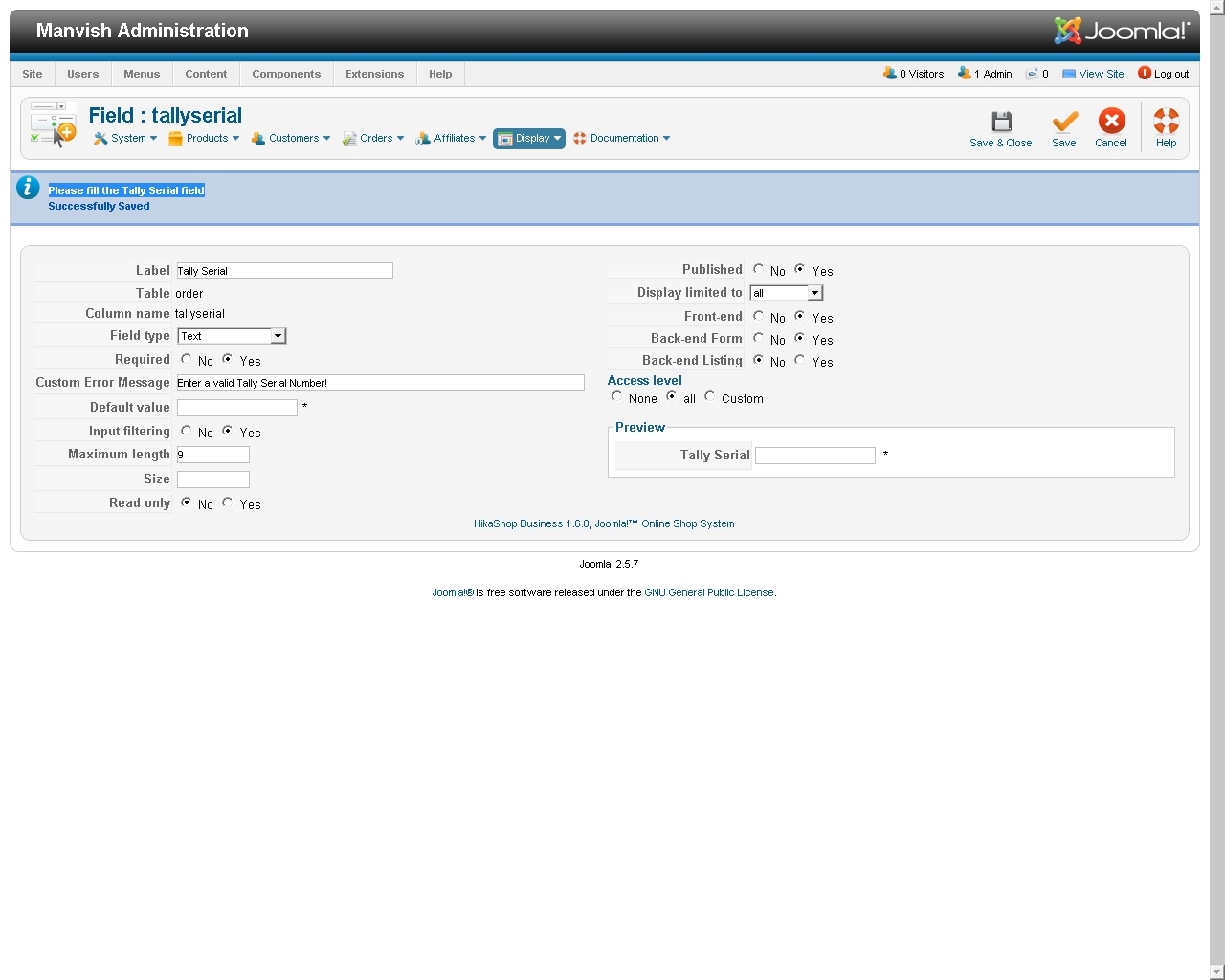

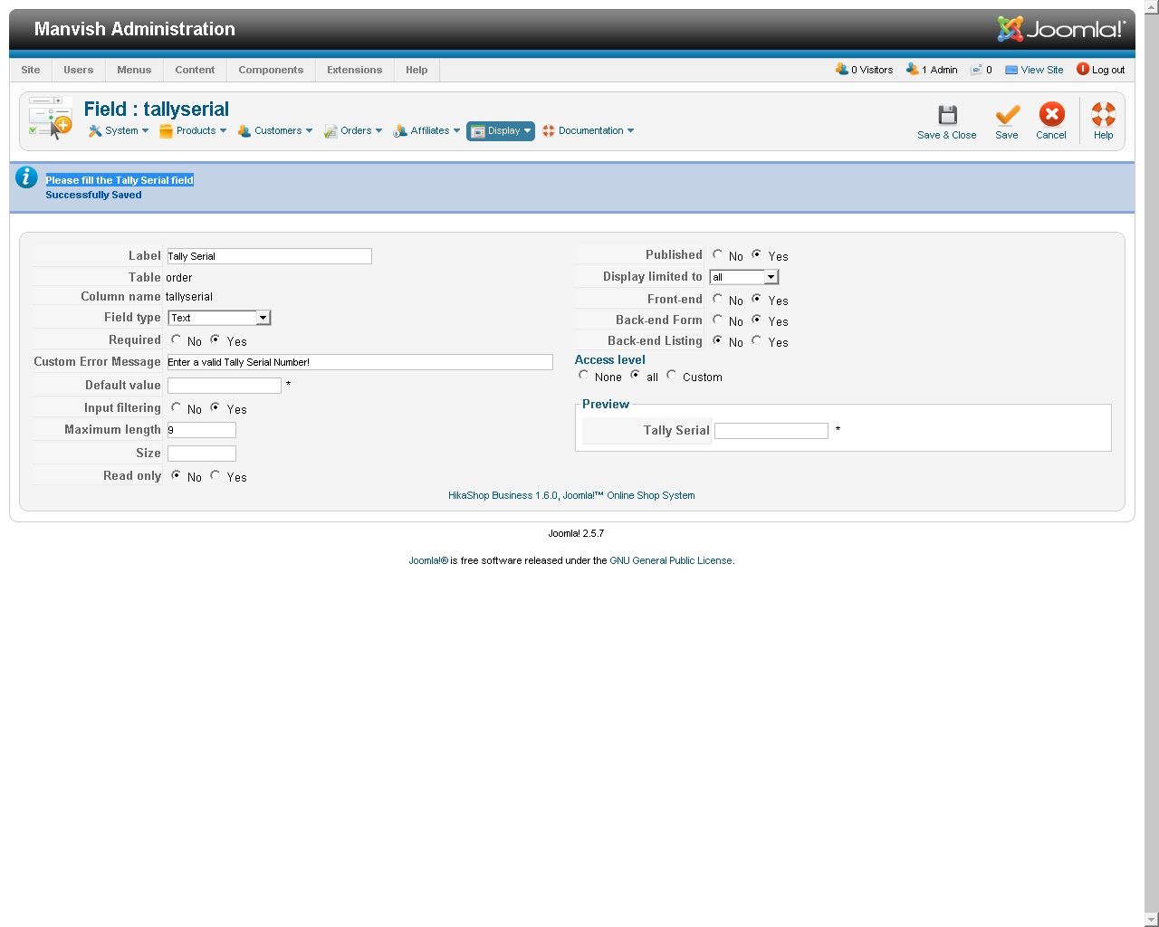

  • Posts: 83
13 years 11 months ago #68831
I got a warning while adding the custom field through the HikaShop->Display->Custom Fields->New
"Please fill the Tally Serial field"
Find the attached screenshot.
Is there any problem?
Do I need to input anything in the Size field (below to Maximum Length)?

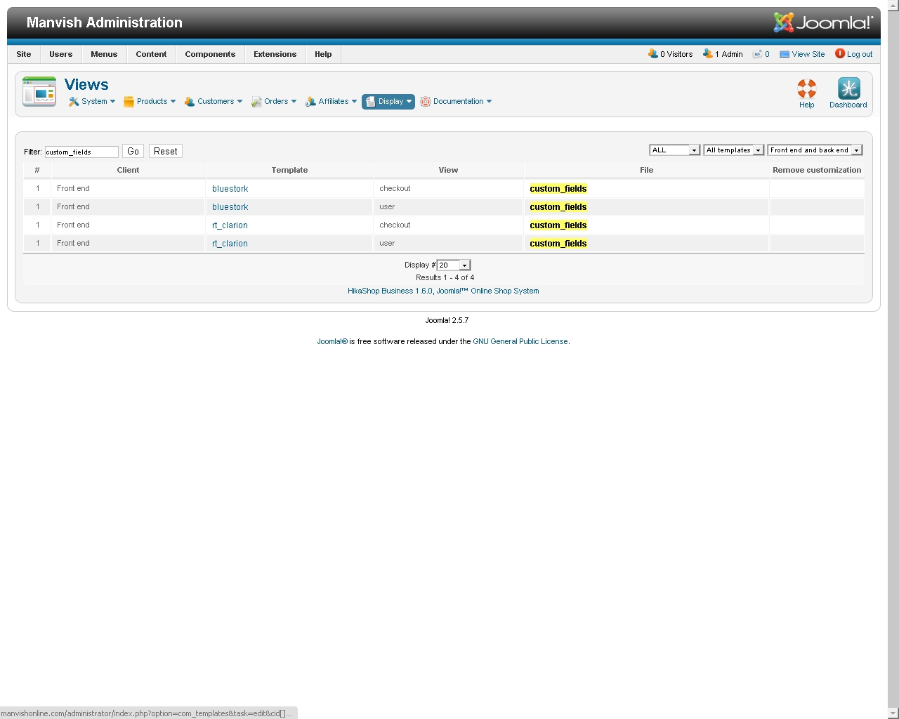

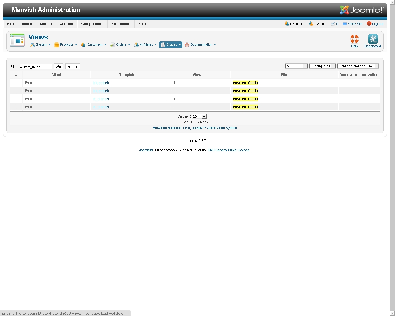

  • Posts: 83
13 years 11 months ago #68835
when i searched for adding the checkout custom field code mentioned by you, i found two checkout custom field; one for the administrator and other for the site.
do I need to replace the code in both the sections of administrator(bluestork) and site (rtclarion)?
13 years 11 months ago #68859
1 - You have modified the email content and you removed the part which allow HikaSerial to add his content, it will be logical that the serial would not be include.
As explain in other threads in this forum, HikaSerial require this portion of code:
<?php
	JPluginHelper::importPlugin('hikashop');
	$dispatcher = JDispatcher::getInstance();
	$dispatcher->trigger('onAfterOrderProductsListingDisplay', array(&$data->cart, 'email_notification_html'));
Where the string "email_notification_html" can change depending the email or the backend view.
2 - You have to edit you current front-end template (site).
You want to add this restriction for your clients, so, the front-end site and not the backend.
3 - You put the field are "required" and the backend form display an example of the custom field.
It is just a warning validation message generated by the custom field. It does not affect the custom field configuration.
There is no problem, don't worry.
