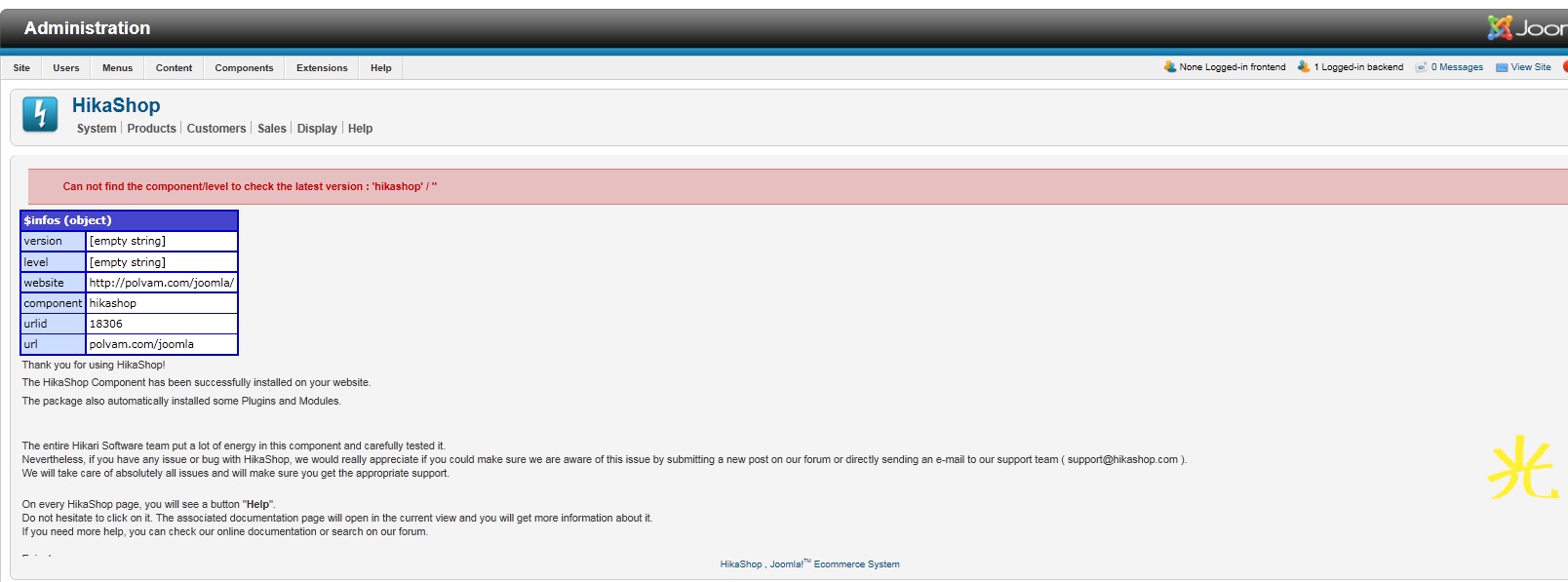

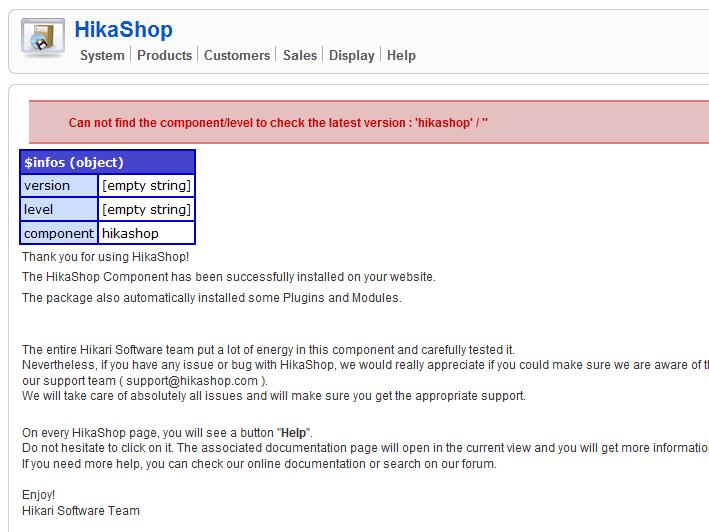

Hi all! I am trying to install hika shop on my website and i get this error message
Can not find the component/level to check the latest version : 'hikashop' / ''
See attach pic to understand better
Any ideas of what the problem is?

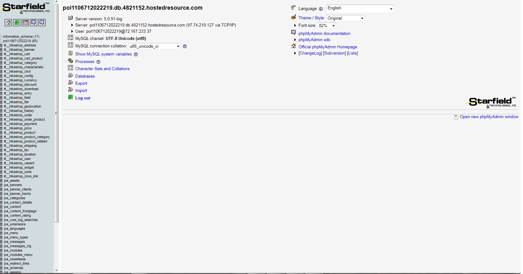

  • Posts: 8
14 years 4 months ago #10475
I am trying to upload the back folder but i am always getting an error.
Please check attached photo if this is the right place.
Last edit: 14 years 4 months ago by PANAGOT.

  • Posts: 8
14 years 4 months ago #10497
I have imported the table.sql.
You can check attached picture. But the problem insists.Any new suggestion?

  • Thank you received: 13639
14 years 4 months ago #10500
@PANAGOT: You need to change the #__ by jos_ in the names of the tables in the tables.sql file before importing it. Otherwise, they won't be recognized. You can either do it one by one by editing each table's options in phpmymadmin or edit the tables.sql, do the change there and reimport it in phpmyadmin.

  • Posts: 8
14 years 4 months ago #10507
I have changed them.And tried to install .
Now it says the following:It has installed successfully but there was an error on building admin menus.
I have attached photos to understand better.
