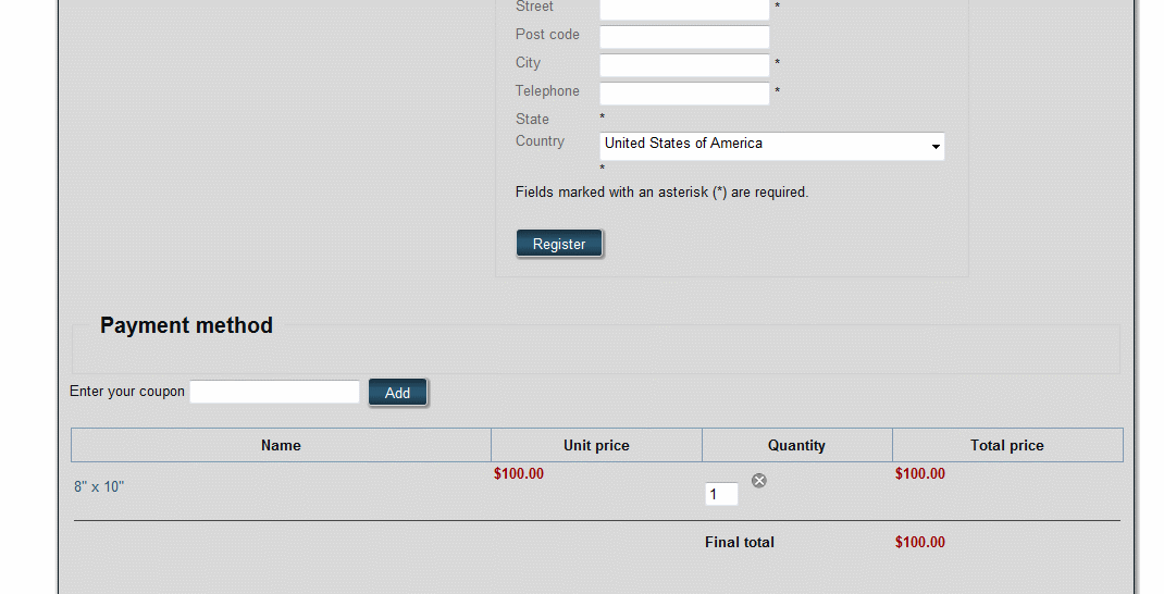

I have set the country to USA in the display tab, but there are no states showing. How do I insert states, and why were they not included?
Secondly, in the panel showing the product the name numbers and icons are terribly mis-aligned.
Lastly, is there a way to remove the add coupon option?

The products details are mis-aligned because of your template CSS. So you need to modify your template CSS.
You can remove the coupon option by removing the "coupon_" view from the checkout workflow option of the configuration.

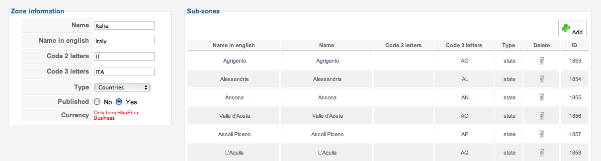

I have the same problem with ITALY, states are not showing. They are all active. Could it be that the registration form is in Italian?
ITALY is the only zone published.
  • Posts: 18
14 years 2 months ago #15001
Here is a view of the backend and the relative States.

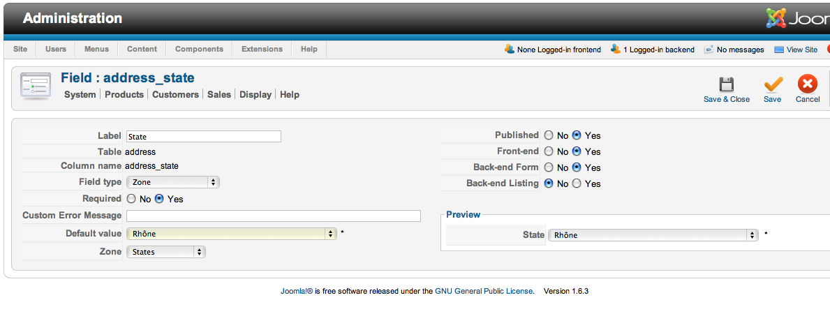

... and why are only FRENCH states appearing in the Field configuration?

The problem is totally different.
You said that the only zone published is Italy. That's the problem.
The states of Italy also need to be published in order to be displayed.

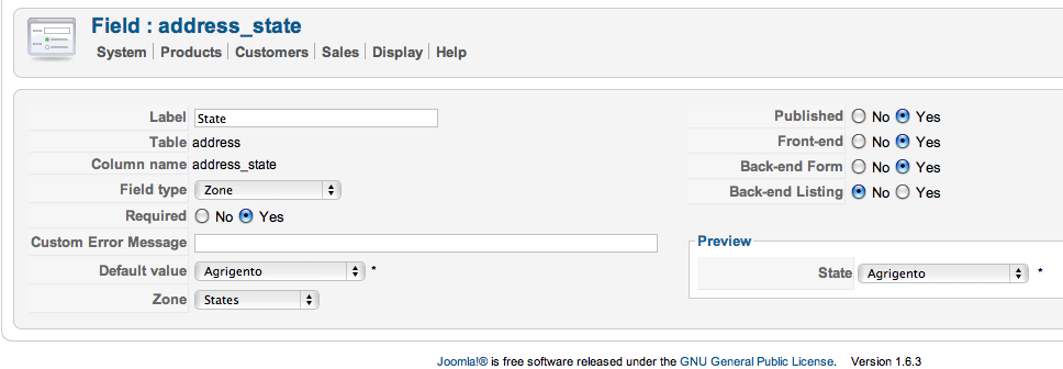

Only the French states appear in the address_state field because it bases itself on the default value of the address_country field. So you need to set Italy as the default country in the address_country field and save it before you can see the list of Italy states in the address_state field.

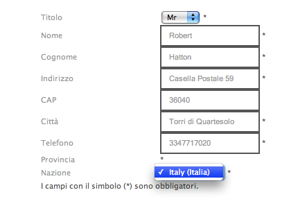

OK. I went in and found only Italy to be selected (no other coutries appear). So I just saved it and now the Italian States appear in the address_state field. GREAT!
However, the dropdown still doesn't appear in the registration form.
Any other ideas?

You have the javascript error below on your website:
Uncaught TypeError: Object #<Object> has no method 'adopt'
SqueezeBox.buildmodal.js:1
SqueezeBox.initializemodal.js:1
ccHikaErrorscheckout:73
invoke.fireEventmootools-core.js:1
hmootools-core.js:1
Array.implement.eachmootools-core.js:1
hmootools-core.js:1
That prevent the javascript of HikaShop from being run, and thus, HikaShop is not able to load the states dropdown.
You need to correct that error and it will work.
The error seems to come from the fact that your template is using the javascript library called jquery without the noConflict call which then conflicts with the javascript library of joomla called mootools.
There are several threads on our forum about that problem and the different solutions users came up with (like adding the noconflict call to your template) :
www.hikashop.com/en/support/forum/search.html?q=jquery
This in not a problem in HikaShop but between your template and joomla which results in HikaShop not being able to run the javascript it needs to run.
