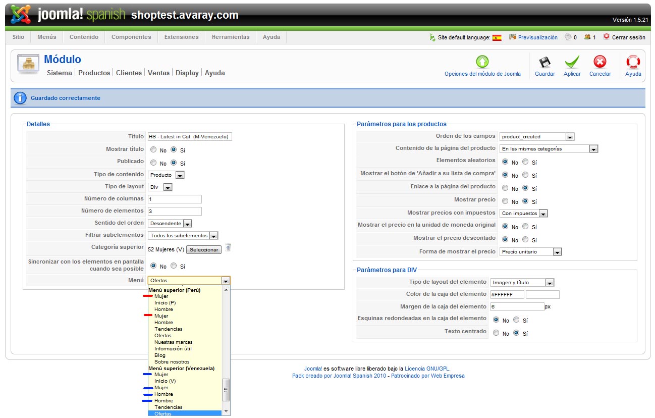

By the other way, i found what looks like a new bug. Through my web construction, i created and erased a lot of menu items that were definitively erased from the menu bin (i checked that it is completely empty). But now in the menu options of my hikashop modules, they have come back as you can see at the picture attached.

14 years 7 months ago #2085
Yes, it's indeed not easy to setup. Unfortunately, that's how joomla works...
We want to provide in the future preconfigured modules and menus so that you don't have to configure all that by yourself which should already greatly simplify the process.
For the menus appearing although your removed them, I just checked on a test website and after removing the menu and then removing it from the bin menu, I couldn't see it anymore in that dropdown. The menus displayed in that dropdown come from the joomla menu table. IF they are displayed there, it means that there are still in the joomla menu table... There is nothing we can do about it :/
