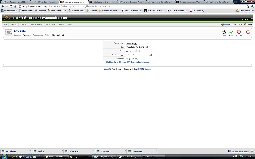

Could you do a screenshot of your taxation rules ?
The taxes will be applied automatically based on the billing/shipping address of the customer. It will depend on the zone restriction you set but also the customer type, the product tax category and whether or not the tax rule is published.
  • Posts: 12
14 years 7 months ago #2435
Customer Type? Had not tried that.. my test are being done with the admin account.
Here is the screen shot.
  • Posts: 84102
  • Thank you received: 13639
14 years 7 months ago #2438
So when you checkout, you should not fill the company field if any (otherwise the system will consider you as a company and since you limit the tax on individual the tax won't be applied). Also, you should make sure that in the configuration under the main tab, the option default customer type is set to individual.
Also, you're limiting your tax to texas. The tax will be applied in your store if you set the "main tax zone" in the configuration to texas. Then, once the user is logged in and that an address is selected on the checkout, the state entered in the address will be used instead of the main tax zone. So when you order on your website, if you don't put an address within the texas, the system won't add the tax.
