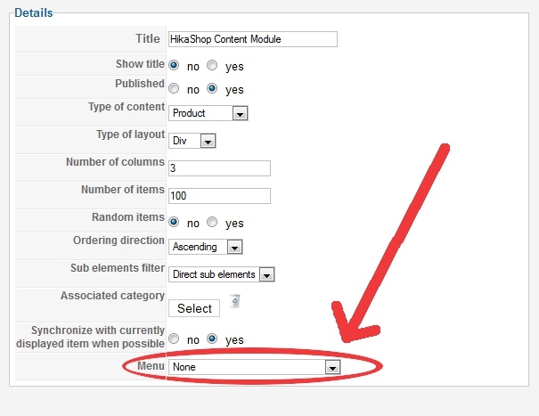

I JUST realized that this happens only if i select the product via the carousel (hikashop content module) and not from the normal listing of products below that. So the problem is related to the Hikashop content module....but i don't know what is wrong...maybe i have setup this module wrong?
Last edit: 13 years 3 months ago by Alexandrakis.
  • Posts: 8
13 years 3 months ago #45783
I found a solution:
At Hikashop Content module for the carousel i Had enabled the synchronize option but i had made a selection for menu field. Removing this selection (selected "none") solved the problem.
See the attached image
