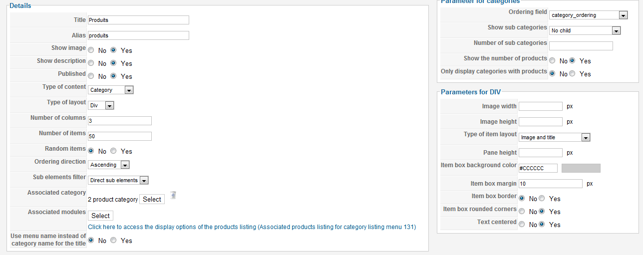

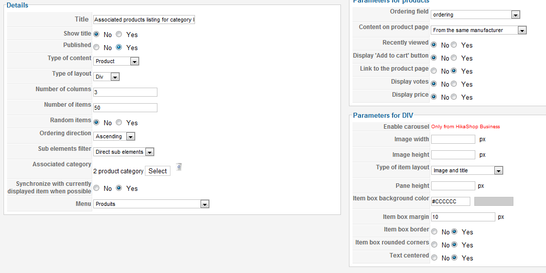

If that doesn't solve the problem, please provide more information on how to reproduce the problem like screenshots of the options of your module/menu.

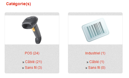

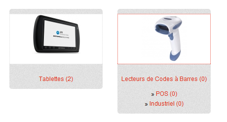

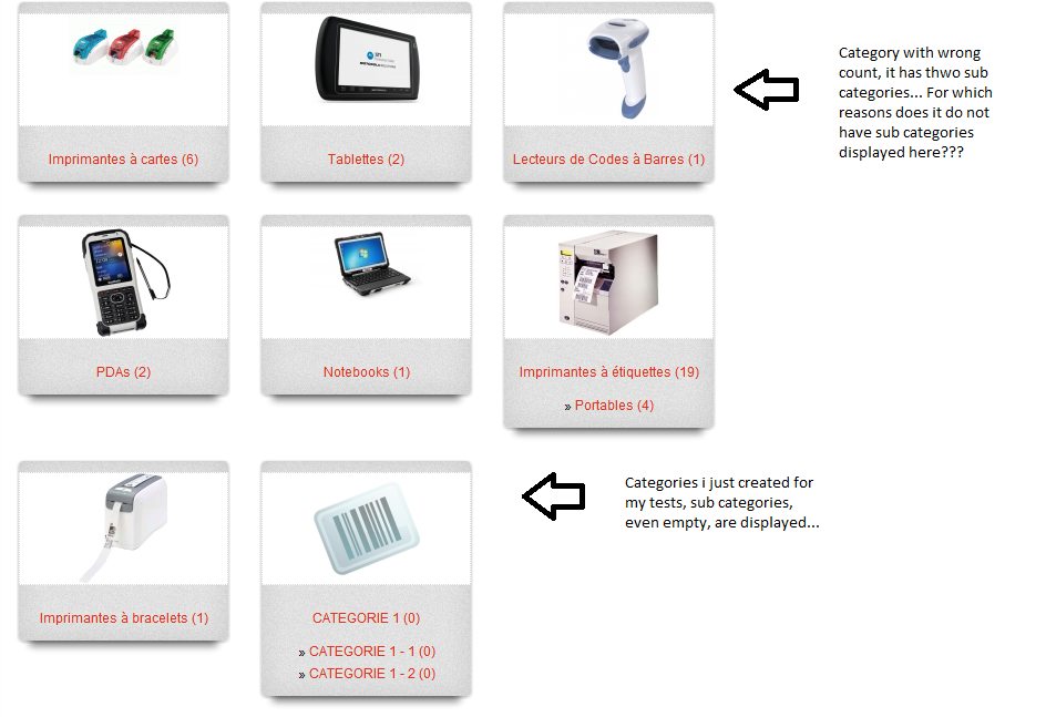

Ok, thank you for your attention but my pb isn't solved.
In attachment #1 there is my products structure, there is no product in "POS" or "Industriel" but there are some products in "Câblé" or "Sans fil"
attachments #2 & #3 are what I currently see in front end

  • Posts: 86052
  • Thank you received: 14180
14 years 3 months ago #49457
$this->params->get('number_of_products',0) comes from the option "Show the number of products" of the listing module.

I debugged the file components/com_hikashop/views/category/view.html.php line #183 - #187
Note: in the id's, #47 is a sub category of #35 and results are fine but #31 has two sub categories (#38 & #39) and the results are going wrong (0)
