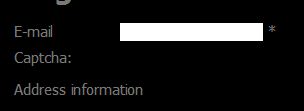

14 years 11 months ago #25451
So strange, the captcha has disappeared for me. Firstly it was showing the words captcha: without the captcha image. then I enabled and disabled the plugin a few times, switched the modes up, and now it doesn't show at all.
I disabled the new module on that page, the google translation and doesn't seem to be the problem.
Have disabled it for now so people can buy from the site, but just thought I would let you know.
Thanks :)

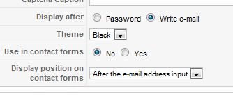

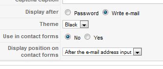

14 years 11 months ago #25467
Yes its so weird, a customer told me about it, and before that it was working and I hadn't changed any settings since it worked...
I have attached a pic of the settings to show you in case I am missing something.
Thanks :)
Last edit: 14 years 11 months ago by Bugger101.
  • Posts: 86077
  • Thank you received: 14186
14 years 11 months ago #25523
What about the other options ? Is the plugin published ?
  • Posts: 392
14 years 11 months ago #25545
Hey,
Yes, it's enabled :)
