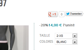

  • Posts: 41
13 years 11 months ago #66254
For image problem, you can see on the picture i've sent with my post.
I've sent the adress of the site and your id in a private message.
  • Posts: 2334
  • Thank you received: 403
13 years 11 months ago #66265
You didn't activated the "display add to cart button" in the main configuration, that solved the problem.
I also solved the image issue.
I hope everything is fine now :)

But, the picture still at a wrong place on the product view(in Firefox)...
  • Posts: 2334
13 years 11 months ago #66356
The modification was done in the CSS, it seems you removed it.
It did it again and it's working fine :)
The following user(s) said Thank You: Jean-Baptiste
