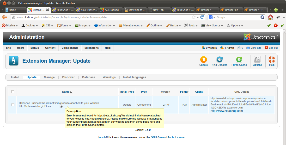

13 years 6 months ago #89314
I have the same problem. I developed the site on a beta subdomain of the actual site, and then moved it to the live site. Now (6 months later) I see it is unable to allow me to update (Hikashop BusinessWe did not find a license attached to your website) since it is still pointing to the beta subdomain.

13 years 6 months ago #89463
It's probably that you didn't empty the cache of the joomla updater where the beta.mywebsite.com website is still referenced.
You should go in the joomla updater and click on the "purge cache" button so that it gets the new URL from our website again.

13 years 6 months ago #89529
Assuming you mean the page that is called "Extension Manager: Update", I had done this before, and I have tried again. It purges the cache (says you have no updates), but then when I click 'find updates' it comes back again with the error message referencing beta.mywebsite.com
It is like the 'beta.mywebsite.com' is hardcoded into the Hikashop installation somewhere, since this is where I originally installed it. Could this be the case?
Steve
  • Posts: 86080
  • Thank you received: 14186
13 years 6 months ago #89547
There is no such thing in HikaShop.
However, there may be in Joomla. you should check the configuration.php file of Joomla. Sometimes the URL of the website is set there instead of being retrieved dynamically.

13 years 6 months ago #89589
I tried this too. configuration.php on the root of the live site has no reference to beta whatsoever. The variable $host (which I assume is where this might be set) is as below:
public $host = 'localhost';
configuration.php no longer exists on the beta site.
See the attached, just to be sure I am explaining things correctly (and yes, this is after I have purged the cache).
Steve
  • Posts: 86080
13 years 6 months ago #89620
Ok, I know what it is. That's because the data in the database of Joomla is not up to date.
In recent versions of HikaShop, that will be updated automatically when you access the HikaShop configuration and the problem won't happen. But that was not the case with HikaShop 1.6
So the solution for you would be to manually update to not have the error anymore (you can do that by downloading the package via the menu Help->Update of HikaShop and installing it via the joomla installer.

  • Posts: 31
13 years 6 months ago #89678
I can confirm that this last suggestion seems to have solved the problem (although I cannot be sure until there is another update!). Many thanks.
