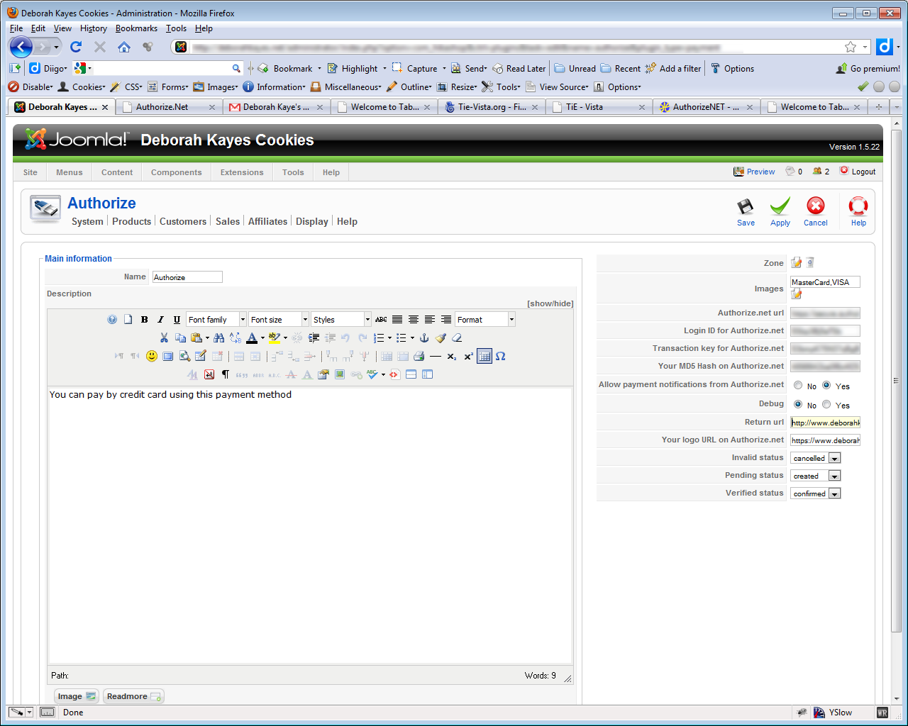

That's strange because no one had such problem so far.
Could you do a screenshot of the options of the auhtorize.net payment plugin options ?
Did you modify the file plugins/hikashoppayment/authorize_thankyou.php
  • Posts: 9
14 years 4 months ago #7632
My mistake...
[Allow payment notifications from Authorize.net] option was OFF instead of ON.

NEW ISSUE (related)...
After posting a live transaction to Authorizenet (status: Captured/Pending Settlement)... the system (HikaShop) emailed this response: "Hello, An Authorize.net notification was refused because the response from the Authorize.net server was invalid"
I've attached a screenshot...
  • Posts: 9
14 years 4 months ago #7676
Similar when I run a Transaction in TEST mode.
Thanks... ALPESH
