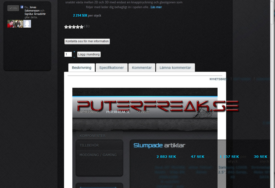

This is what it looks like if I have SEF set to Yes in Joomla config and follows a link from Facebook to my products if the Facebook like button have linked it into a profile:
The problem goes away if I don't use the tabbed interface or SEF in Joomla. Seems to be a javascript that keeps loading the page over and over and over again until the browser crashes.

Apparently, you still didn't had the latest build.
I've manually updated the files but I couldn't test since the account you provided doesn't allow us to turn on the SEF and that it is still off on your website, but normally it should be ok now.

13 years 2 months ago #107069
Problem solved, it was coming from the itemid in the url which was not SEF.

13 years 2 months ago #108805
I've found a solution by adding the code:
<?php
if(strpos(hikashop_currentURL(),'?fb_action_ids=')){
	$app = Jfactory::getApplication();
	$parts = explode('?',hikashop_currentURL());
	$app->redirect($parts[0]);
at the top of the show_default view file via the menu Display->Views on your website. It's not pretty but it works...
