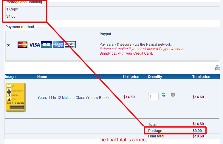

So i go to checkout and see
Total $23.20
Postage $0.00
Final total $31.10
the postage is 7.90 and the final total is correct.

All i can give is a screen shot

12 years 2 weeks ago #111698
Thanks Jerome
The problem was my cart override.
Sloppy on my behalf cause that override is version 1.5.4
All is good now.
