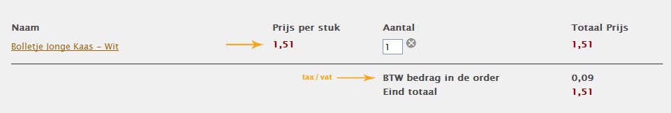

I just started setting up a shop for food and drinks see:
Part of the message is hidden for the guests. Please log in or register to see it.

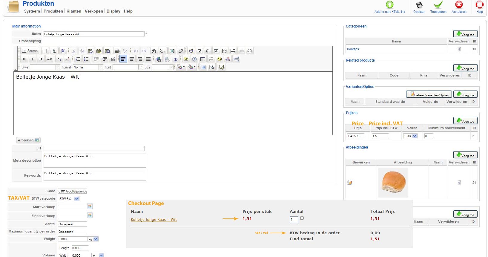

After hours of strugling with the TAX setup I finally succeeded (I think). I have setup two TAX rates rules (VAT is called BTW in the Netherlands): 6% for food and 19% for non-food or alcoholic drinks. Customers who buy are all in the Netherlands. Edited an existing food product and applied the tax rule 6%. There is everything ok.
Also on the product page where it says EUR 1,50 incl.TAX. But on the Checkout page the price is EUR 1,51? Seems to be a rounding issue. Any solution? Since TAX/VAT here has to be paid over the total amount of each order.

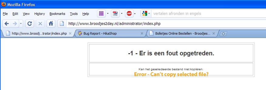

Tried to install 1.4.7 but then get an error -1- Can't copy selected file.
Manual Upload?

Simply Uploading didn't work :(
All my work (menu items) lost but database still intact.
Thank you very much! Your advice seems to work. Will be doing some more testing :)
"please look in the file adminsitrator/components/com_hikashop/classes/currency.php in the function addTax near the end of the file. Could you try to remove the line:
$price->price_value = round($price->price_value,$round);
and see if the price is correct after that?"
