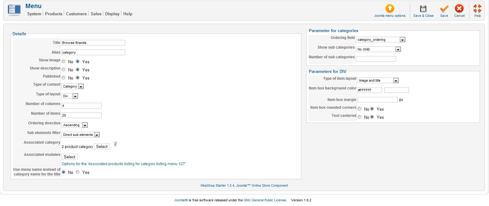

Nicolas, I checked the "Help" documentation on that page and saw a "Height" field (no width though). But I cant see the height field on the right. Here is screenshot please take a look.

That's strange. You should see them, like on our demo website:
www.demo.hikashop.com/administrator/inde...=menus&task=edit&cid []=89
Could you give a back end access to your website so that we can check on that ?

I checked the file administrator/components/com_hikashop/views/menus/tmpl/form.php and I can see that header at the top:
<?php
* @package HikaShop for Joomla!
* @version 1.4.9
* @author hikashop.com
* @copyright (C) 2010 HIKARI SOFTWARE. All rights reserved.
* @license GNU/GPLv3 www.gnu.org/licenses/gpl-3.0.html
Which means that this file comes from an old version of HikaShop.
Thus, it's normal that you don't have these fields.
There was apparently a problem when you updated.
