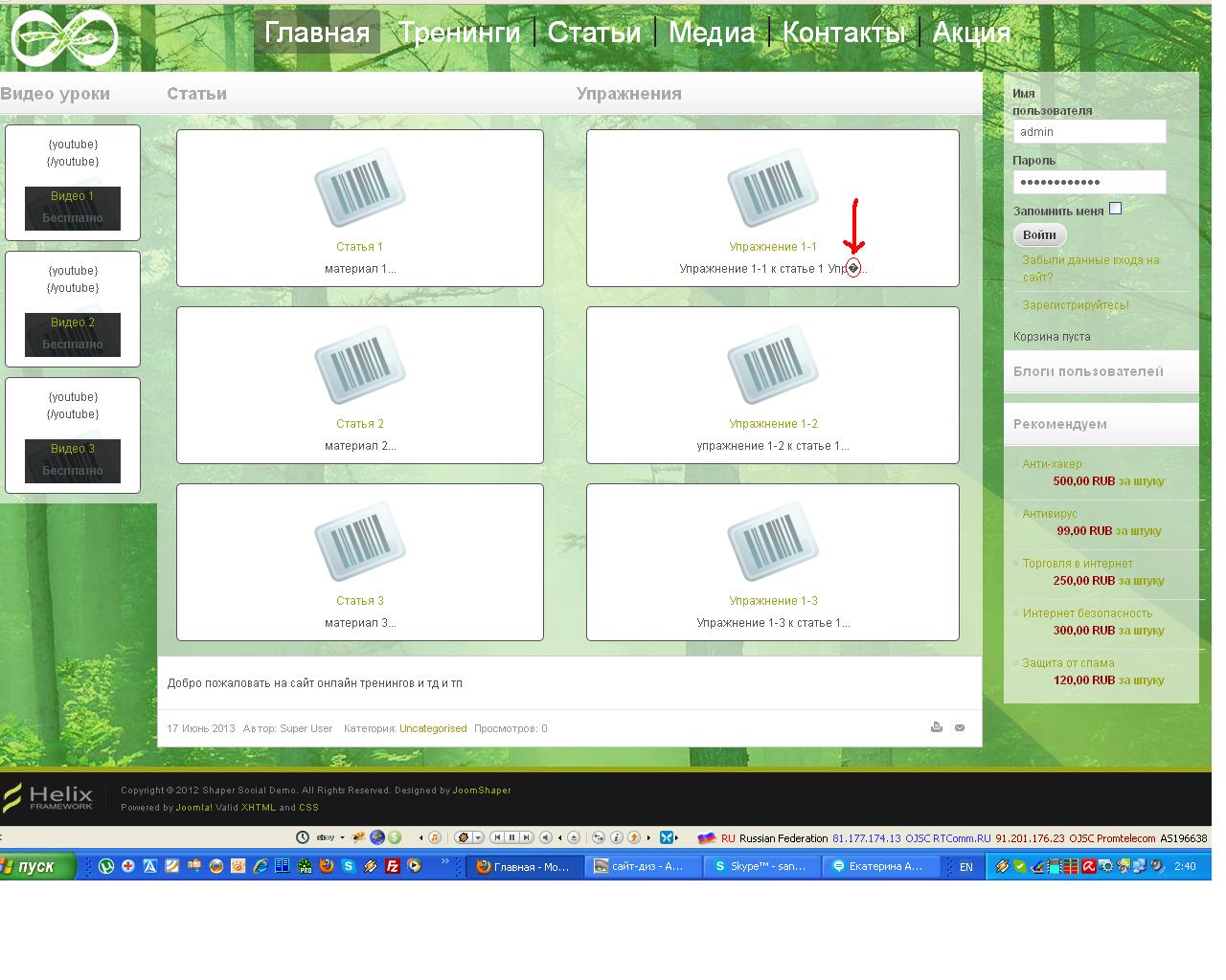

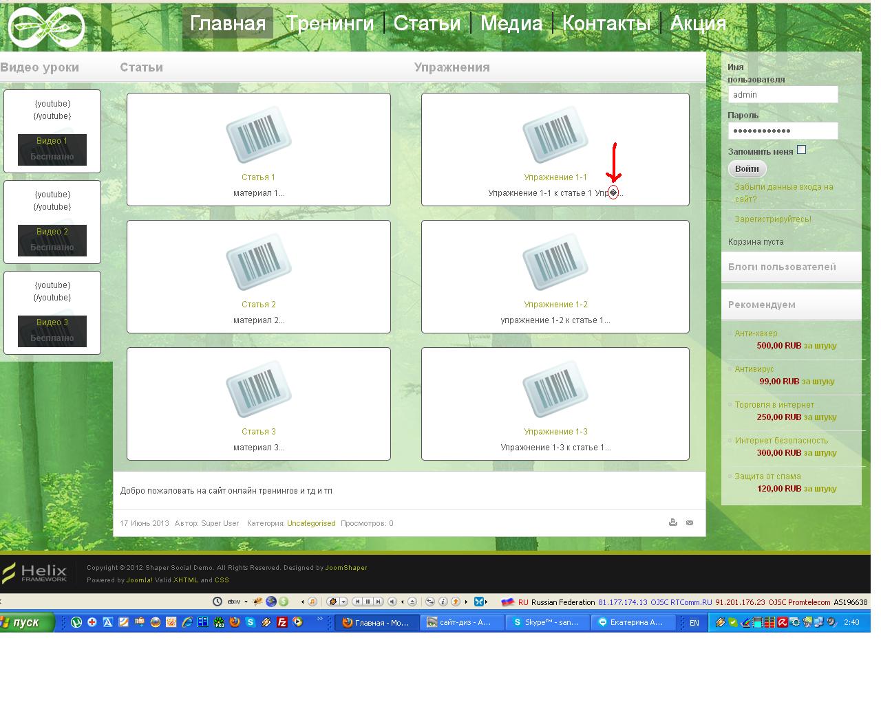

how to fix that?
13 years 1 month ago #111572
This is probably due to "substr" which return a part of a string but it can too cut a character so it return this symbol because the character is not complete.
I think that the function "mb_substr" allow you to avoid that.
The following user(s) said Thank You: master_b
  • Posts: 540
  • Thank you received: 49
13 years 1 month ago #111584
Xavier wrote: Hi,
tnx its help:)
