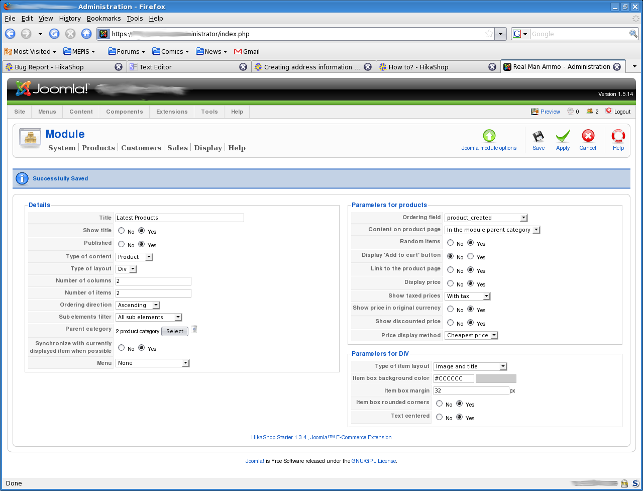

I've attached an image file that shows the Hikashop module properties for a "Latest Products" module I have:

Your options are good. There is no reason for the button not to be displayed.

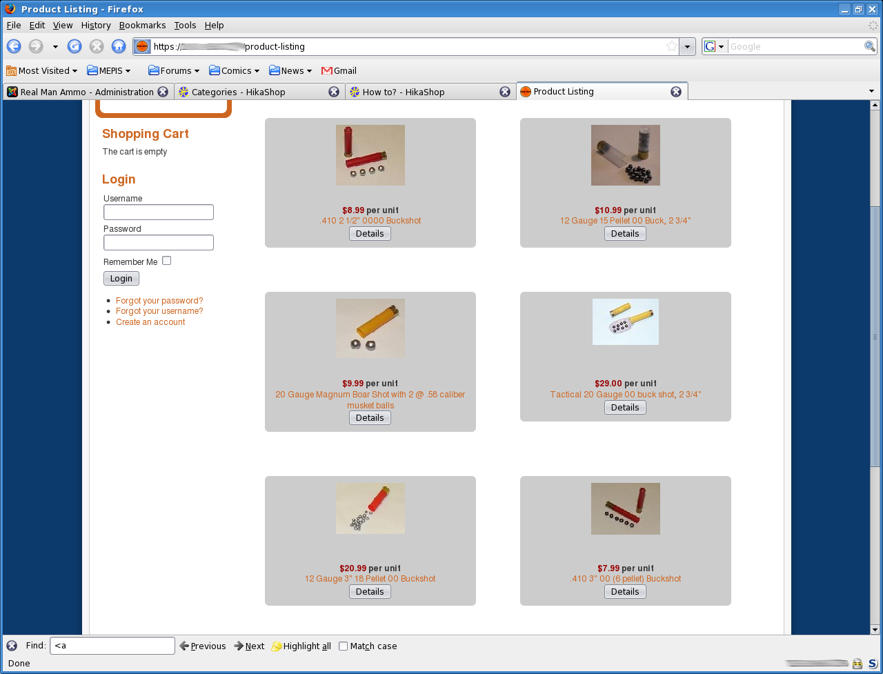

The problem occurs on any module regardless of view type except for my 'Product Listing' page.
Here's a screenshot of the listing page with the desired results...

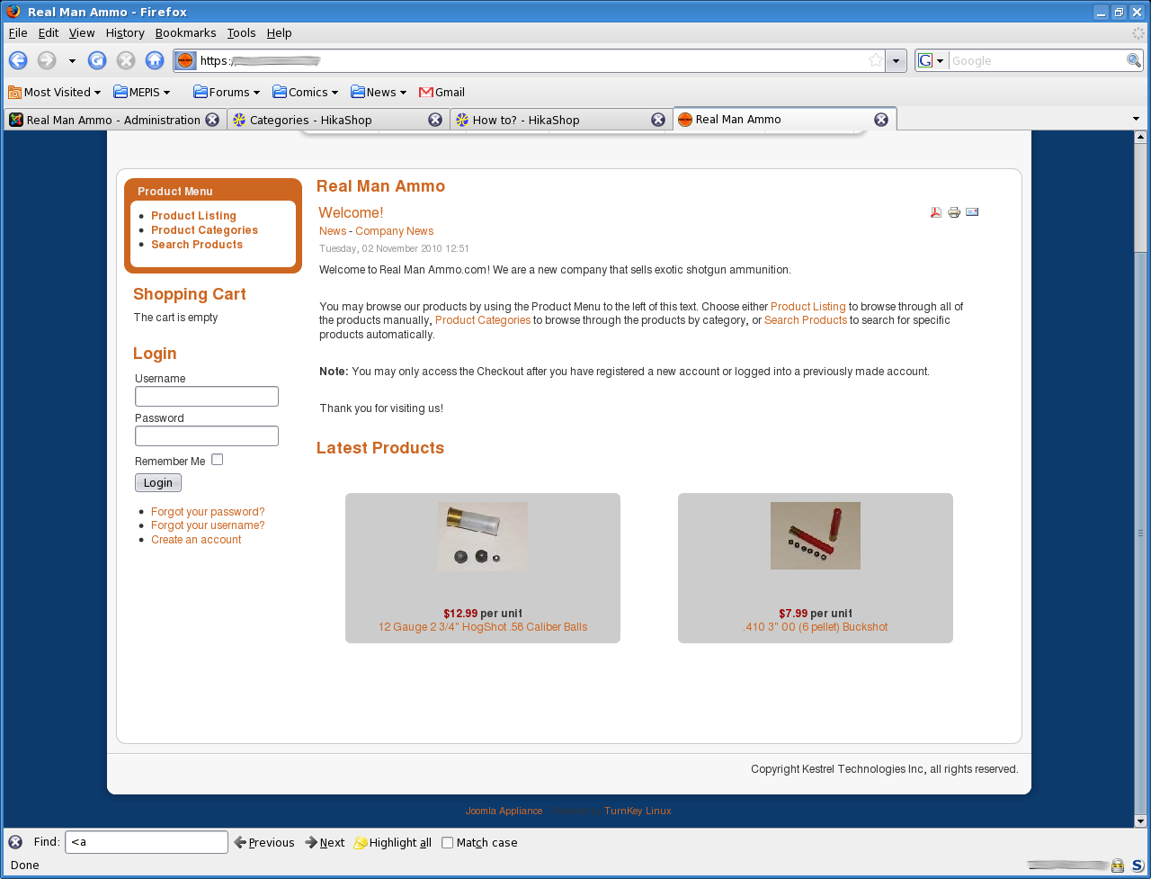

15 years 8 months ago #1370
And here's a screenshot of the frontpage, where you can clearly see that the 'Latest Products' module is missing 'Details' buttons.
The same problem shown above also occurs when I look at a list of products under a specific product category.
