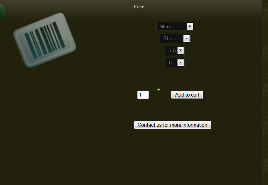

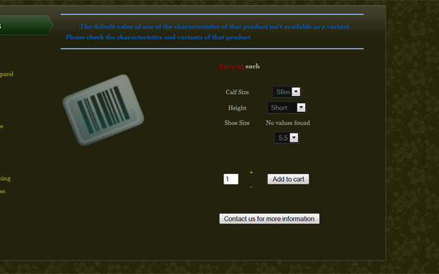

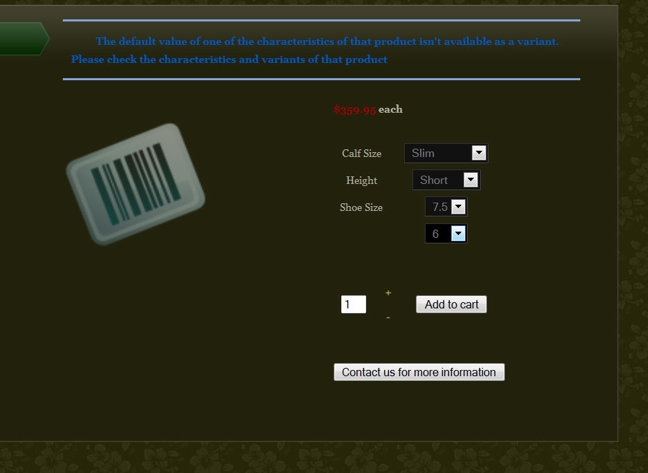

15 years 2 months ago #17335
So darn close!
I took your file and added more sizes. While I don't get the error, I get 2 drop down boxes for shoe size and no option labels. See "HHIssue1" image.
So I took the same file and added the default variants in line 1. See "HHIsue2" image. I get 2 drop down boxes for shoe size, but I did get option labels. And I get the error message "The default value of one of the characteristics of that product isn't available as a variant. Please check the characteristics and variants of that product"
Progress ;)
Last edit: 15 years 2 months ago by FreshIdeas.

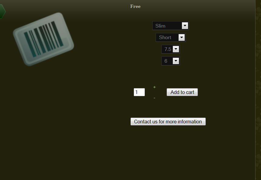

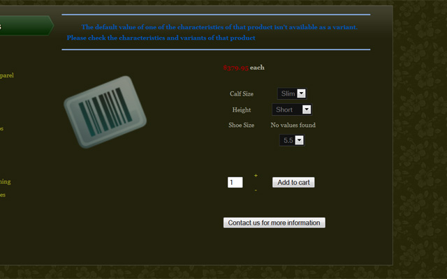

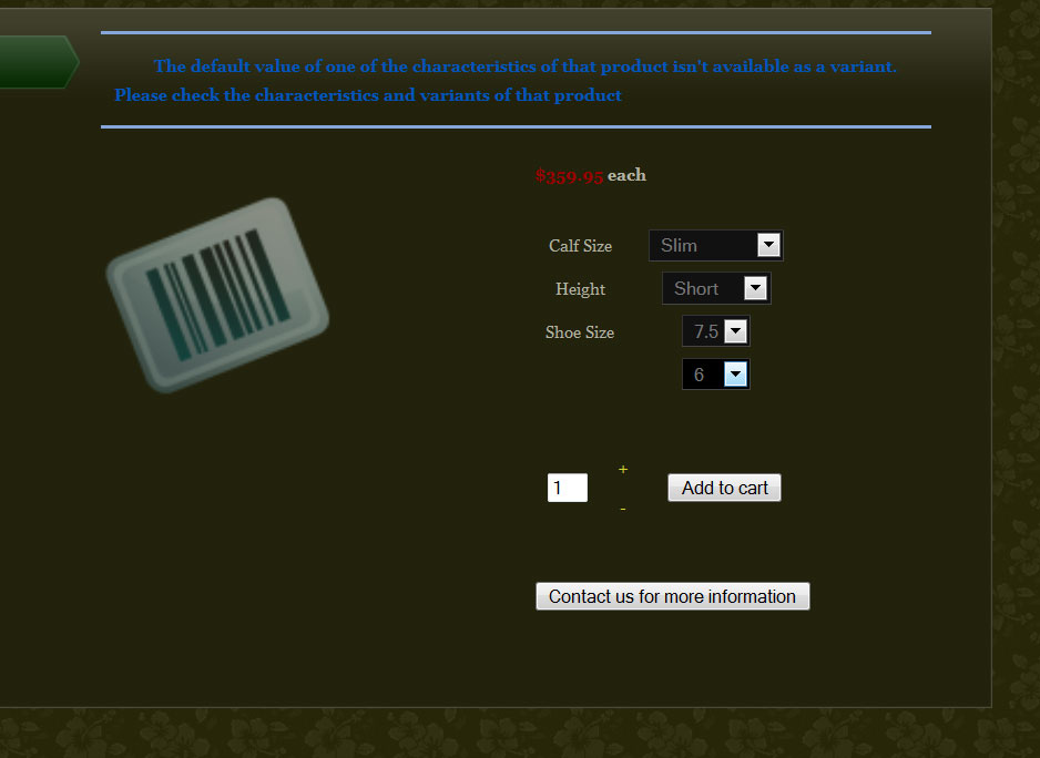

15 years 2 months ago #18353
I'm still getting this issue -- with the multiple drop down boxes -- randomly. I've already PRELOADED tons of characteristics. Randomly it will include drop down boxes and then I have to delete everything...delete the entire characteristic (some have quite a few option) and re-enter the characteristic.
NOW I uploaded a file, after re-adding GIRTH SIZE (for the THIRD TIME) and I don't have an add to cart option - it says "no stock". ARGHHHHH
[url=http://http://174.121.38.60/~hhware/index.php?option=com_hikashop&ctrl=product&task=show&cid=62567&name=edgewood-1-end-overlay-fancy-girth&Itemid=815&category_pathway=95]http://174.121.38.60/~hhware/index.php?option=com_hikashop&ctrl=product&task=show&cid=62567&name=edgewood-1-end-overlay-fancy-girth&Itemid=815&category_pathway=95 [/url]
