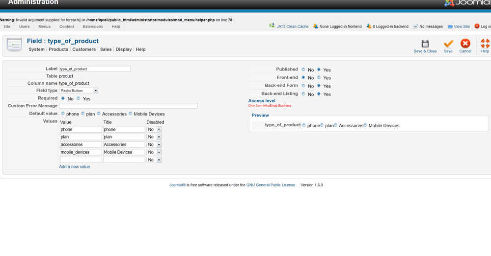

ok i just purchased it, i have created the field in the table as a radio box with the values i want, now how do i connect this with the product, i don't see it anywhere.
  • Posts: 86112
  • Thank you received: 14210
15 years 3 months ago #18263
It should be displayed on the product edition screen.
If not, please do a screenshot of the custom field options.
  • Posts: 156
15 years 3 months ago #18268
some of the options to view weren't set, got it to show now know. thanks.. i got a bug that needs to be addressed. i posted under the Bug report. check it out for me please. thank you :) HIKASHOP all the way!!

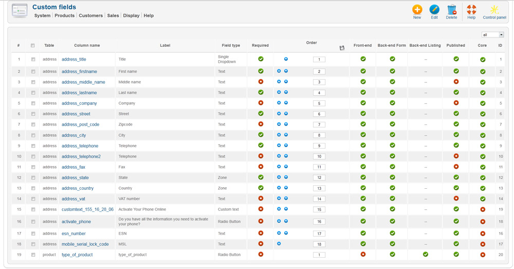

  • Posts: 156
15 years 3 months ago #18336
here they are.
  • Posts: 156
15 years 3 months ago #18337
Here is inside the field.
