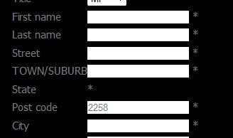

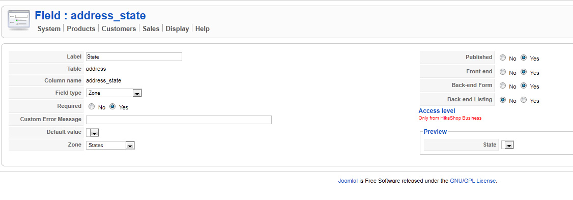

15 years 1 month ago #18917
nicolas wrote:
Did you change the default country and the default state in the custom fields address_country and address_state ? Because if that's not the same country as the one you have published, it might create such problem...
Hi, thanks for the reply.
OK, I looked in this section just now, under country, Australia is set in both default value and "preview" country.
When I go into the state field, there are two drop down boxes in the same two positions, but they are empty.

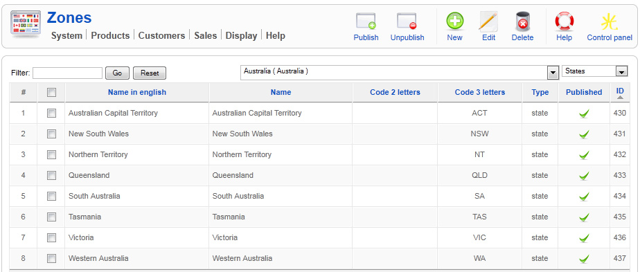

  • Posts: 86042
  • Thank you received: 14174
15 years 1 month ago #18922
That means that HikaShop couldn't find any published state for australia. Do you have them published in the menu System->Zones ?
  • Posts: 10
15 years 1 month ago #18929
Yes, sure are published...
  • Posts: 86042
15 years 1 month ago #18936
Edit your custom field address_country and SAVE it. Then, see if you see the australia states in the dropdown ?
If no, then it means that the states are not linked to the australia country and you should edit the australia country zone to check its subzones.
  • Posts: 10
15 years 1 month ago #18939
Hi, ok, saving it allowed the state to appear in the custom state fields, I set those and saved those.
In the front end, when adding a new address, it says australia in the country, but nothing for state at all until I change to New Zealand as a country and switch back to Australia?
Appreciate the help!!

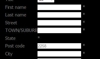

  • Posts: 392
15 years 1 day ago #23317
I also have the same issue of the state box not showing up. I disabled all the rok components to see if that would work, but it didn't.
Could it have something to do with the custom "suburb" I added?
Thanks :)

  • Posts: 392
15 years 19 hours ago #23444
Yep:
Thanks :)
