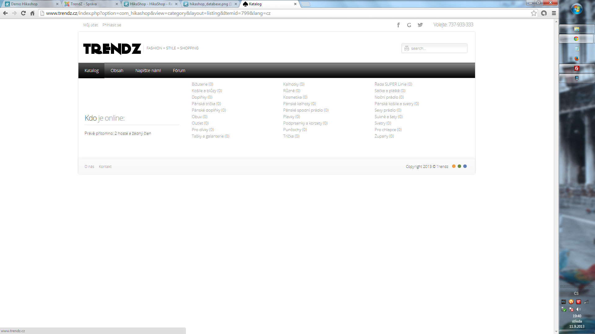

I have one more question.
Do you think not having the variants in the database but having the variant in the product table could block product listing module from displaying the products in the front end? Till now I can only display empty categories with no link futher to products listed.

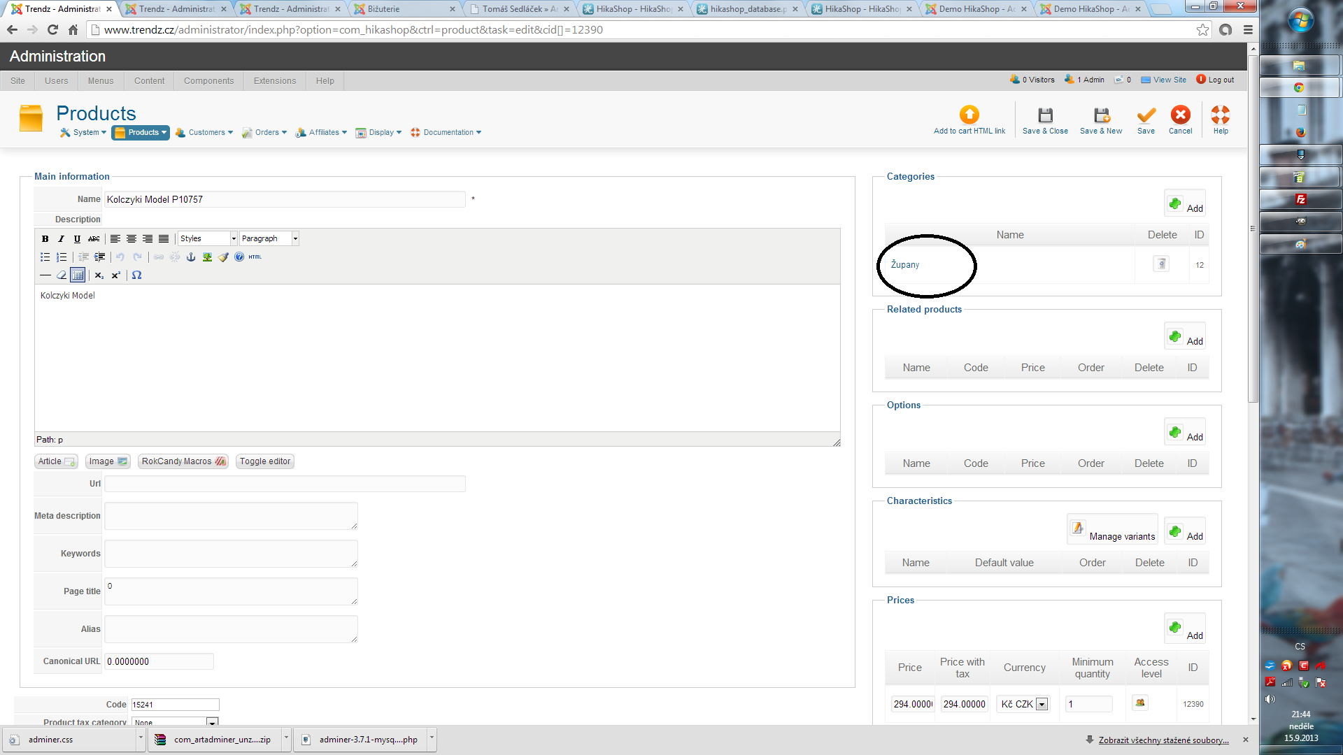

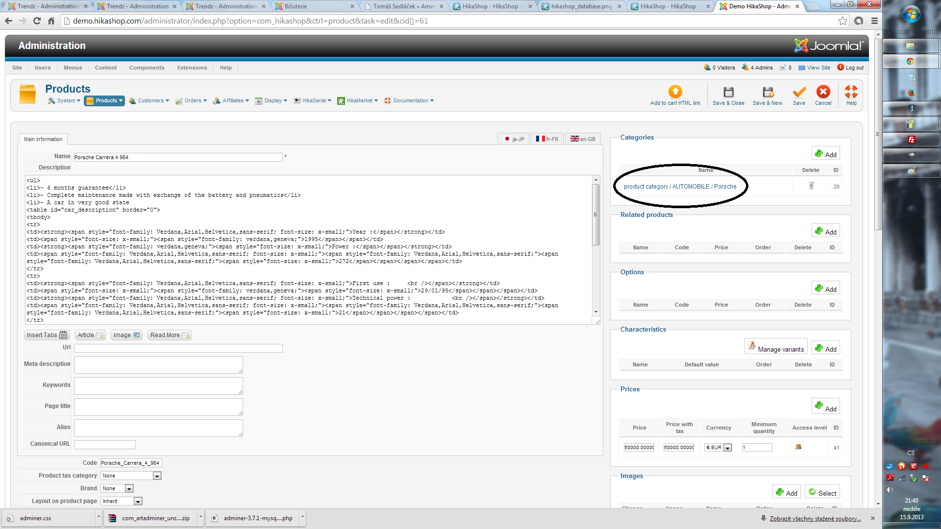

The module is there, of course.
The problem is somewhere with hikashop_categories table. When I look at the back end products I can see the product to be inside category. However the category is not linked to Product category.
In other words, at back end page of product I see only CATEGORY.
I am sure I have not linked properly the categories to ROOT/Product Category/"some category".
Please see the attached pics.
Ondrej
Just to add. Please note I need to upload the categories through sql. Therefore I cannot go through back end and add category, but insert the data into the tables.
Also for products display.
Products get displayed only after I go to product page on back end and clink on save button. There are no changes in the hikashop_product or hikashop_product_category tables.
Is there any script what I could run to go through all the products and make them registered with the system?

  • Posts: 26384
12 years 11 months ago #123824
For what I see the product is right link to a category, with the id 12
But this category does not have a parent category, so there is no "breadcrumb" displayed.
