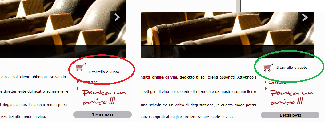

13 years 11 months ago #59392
I used the overrides option to add an imege to the Minicart:
CART_EMPTY <img src=" www.madeinvino.com/images/varie/Carr02_A.png " /> Il carrello è vuoto
TOTAL_IN_CART_X <img src=" www.madeinvino.com/images/varie/Carr02_A.png " /> Totale : %s
it works but the image and the text are not alligned vertically.
Is there a way to allign image and text (like the green circle)?
Many Thanks!

13 years 10 months ago #60062
After many many tests i have found the solution....
this is the string to use in the override text
<img style="vertical-align: middle;" src=" www.madeinvino.com/images/varie/Carr02_A.png " /> Il carrello è vuoto
It seems to work! :)
Thank you so much for your help!
