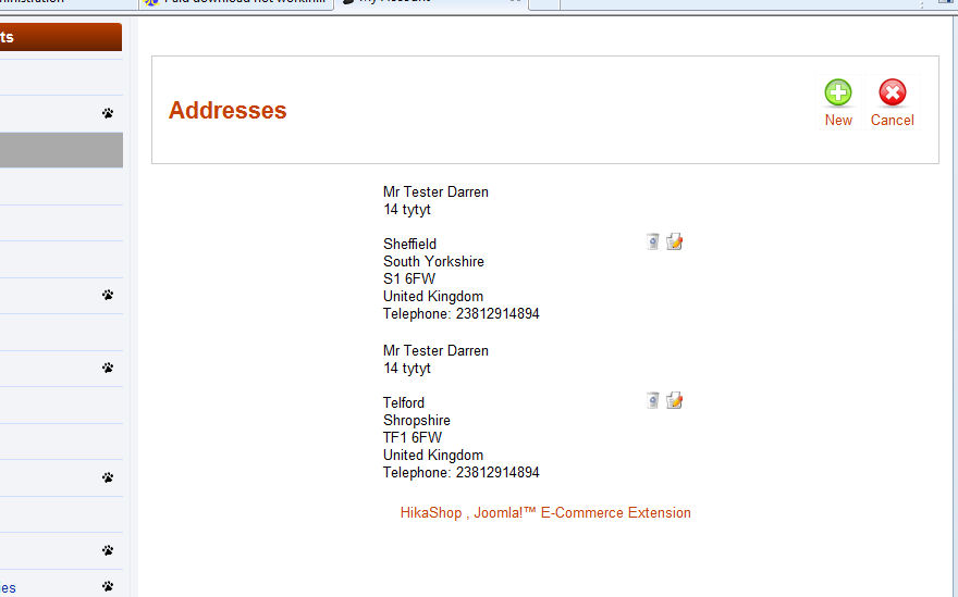

Hi, just a small question, there appears not to be an idendity title in My Account when there is a billing address & a shipping address? can they be included.
  • Posts: 85949
  • Thank you received: 14139
14 years 11 months ago #22764
What do you mean by "idendity title" ? I can see the titles (Mr) on your screenshot.

14 years 11 months ago #22766
i.e. Address titles
Billing Address
Shipping Address
minor I know but I think it will look cleaner.
thanks
  • Posts: 85949
14 years 11 months ago #22767
Addresses can be used for billing or shipping. There is no type attached to them.
The billing address of my first order might be the shipping address of my second order...

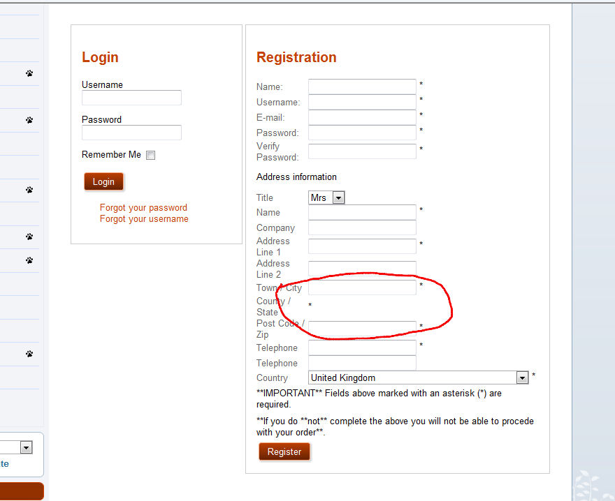

Another problem I have just found, you cannot select the county/state when registering, however you can select this from My Account once registered. (this is supposed to be a required field)
  • Posts: 85949
14 years 11 months ago #22771
It's either because:
You have a javascript error on your page which prevent the system to load the states of your country
You unpbulished/deleted the states of the UK
You removed the states from the subzones listing of the UK country zone.

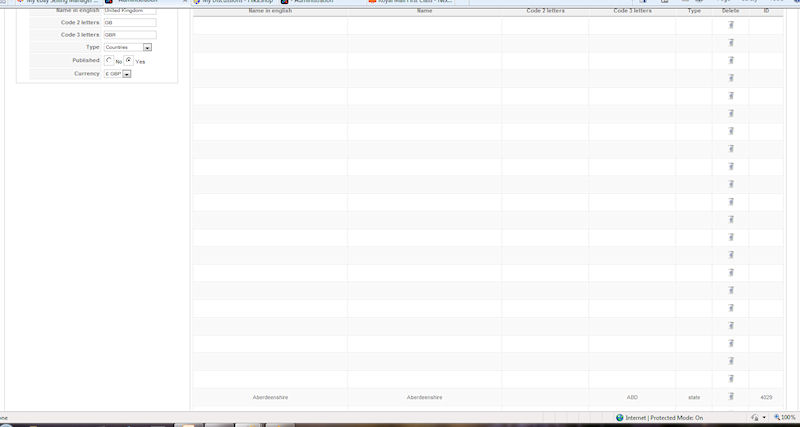

I have spent tried all of your suggestions and cannot find anything wrong except see the attached, there are a lot of blanks in the UK subzone that I cannot seem to delete? not sure if this is the problem?
  • Posts: 85949
14 years 11 months ago #22787
That's indeed the problem. It means that you deleted the UK states from the database and the system cannot find them anymore.
To solve the problem, the easiest is to do like that:
Go in your PHPMyAdmin and empty the tables jos_hikashop_zone and jos_hikashop_zone_link.
Then, install HikaShop on top of your currently version.
That will put back all the zones with their default values and it should work again.

re-done this and this time cleared the cache, the blacks have now gone the I still get the same problem, if you register and login you can change the field then, it's only on the new account form that this is happening.

So the dropdown of states works when you change the country. But the default dropdown does not display because you have a javascript error on your page:
Uncaught TypeError: Object #<Object> has no method 'getProperty'
That error is caused by the mod_superfish module you're using. If you remove that module it should work properly.
It's the problem described there: www.hikashop.com/en/support/documentatio...tibility-issues.html in the "problems with modal popups".
  • Posts: 585
  • Thank you received: 12
14 years 11 months ago #22894
Thanks I would have never found that, there is an option to run it with no confict so it now works ok.
