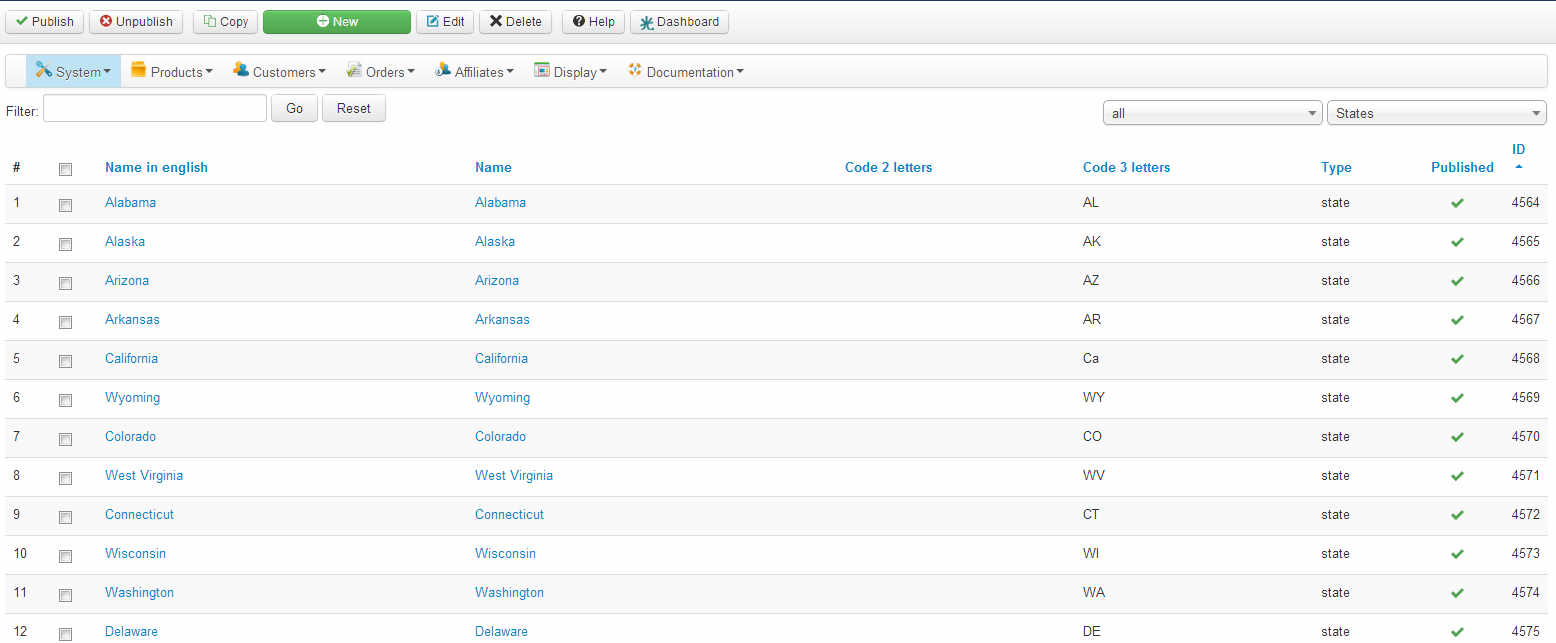

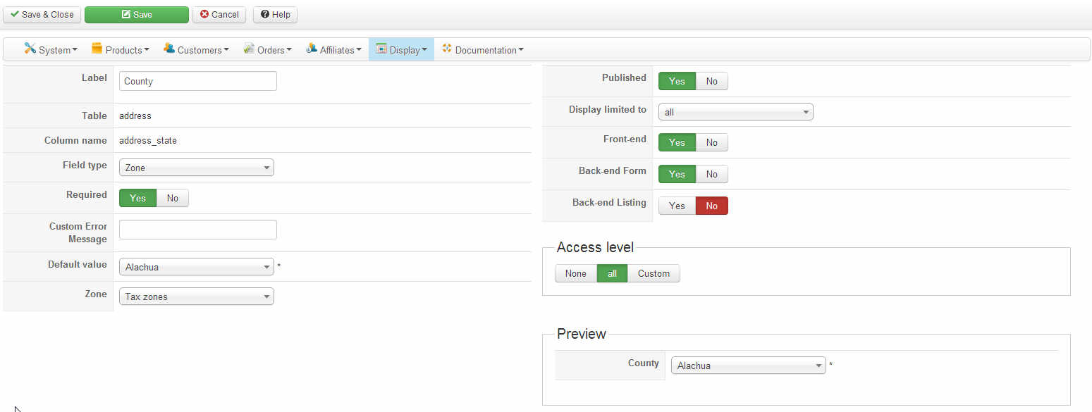

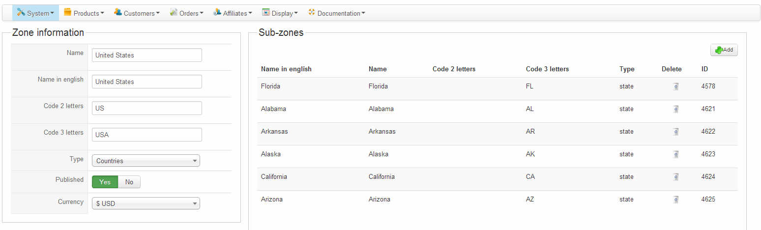

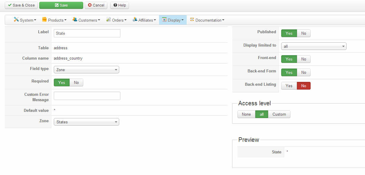

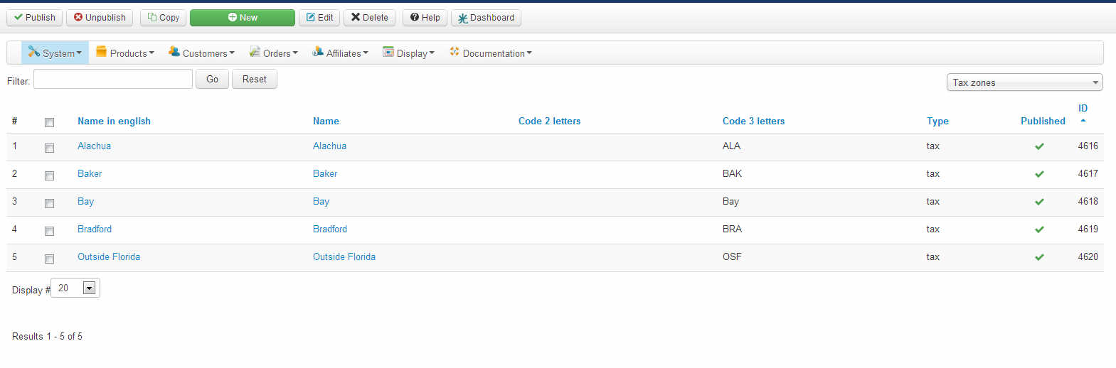

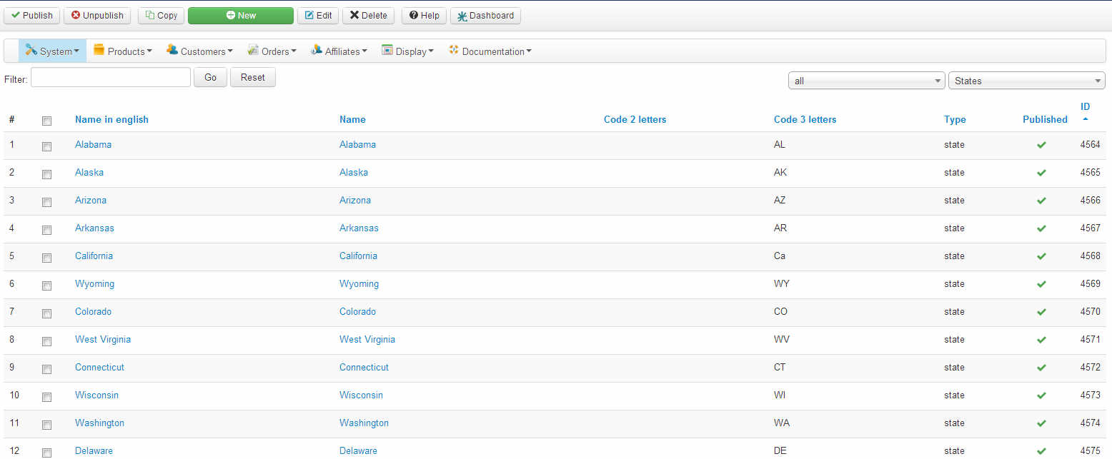

HI. I see this post was over a year ago but I am trying to accomplish the same thing in Florida but stumped. I've followed the instructions in this post and although my county list is showing up my state list isn't on the front end. However, on the backend I see the list with counties and states. I renamed address_country to state and I've renamed address_state to county.

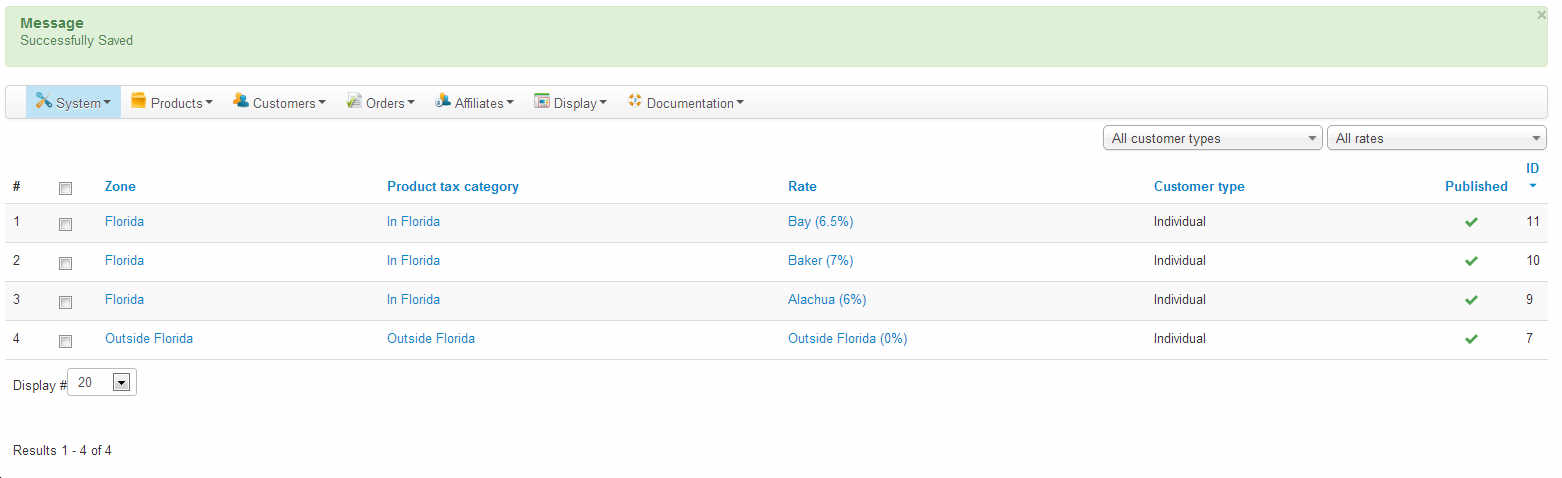

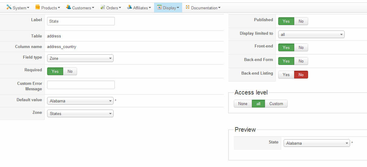

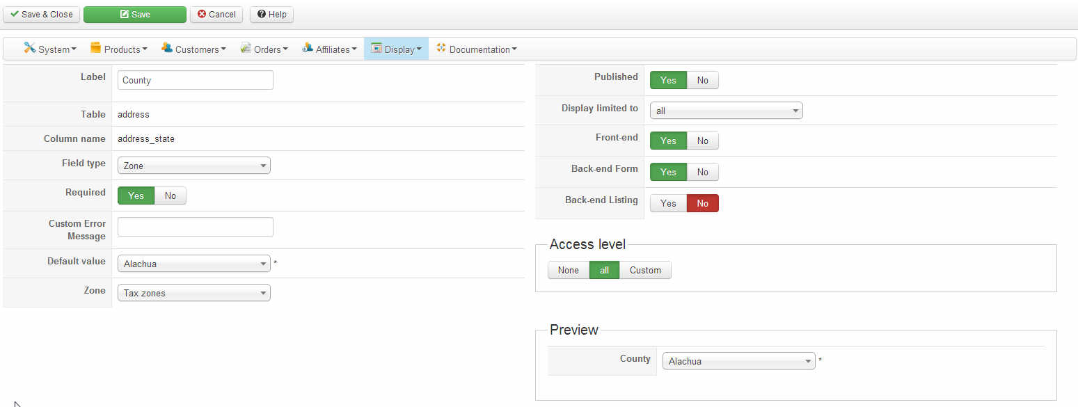

Please provide screenshots of your tax rules and of your states/counties zones

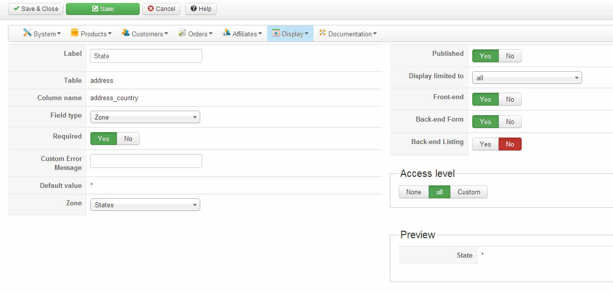

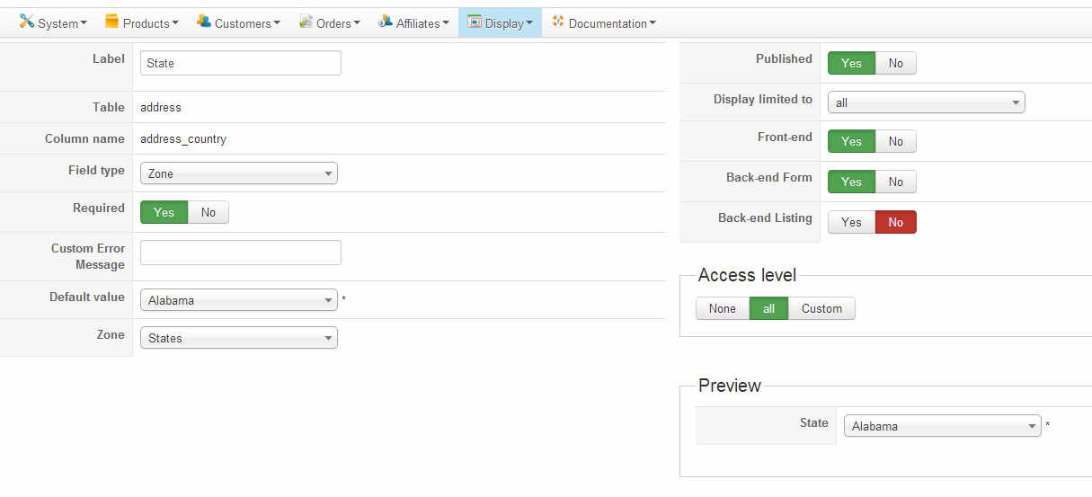

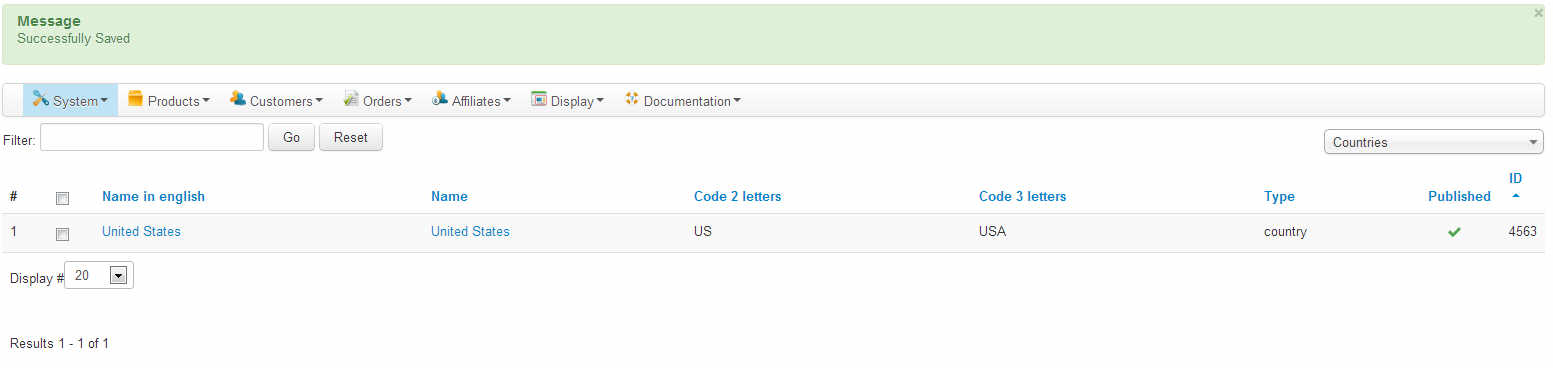

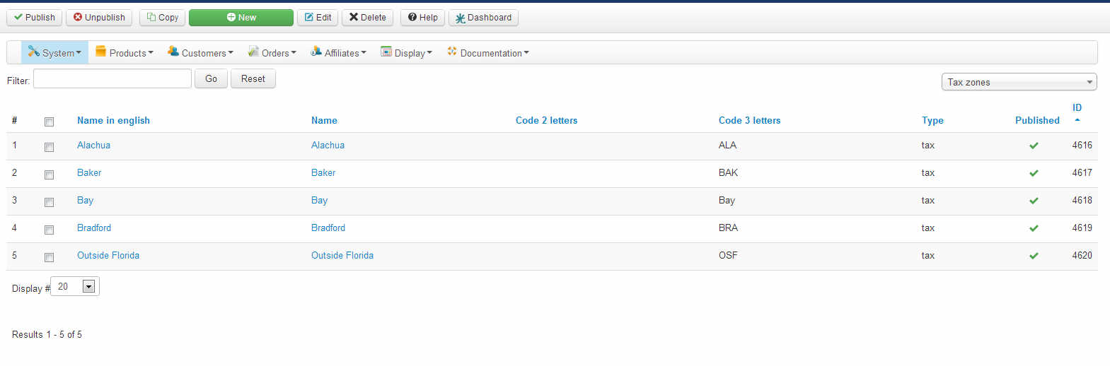

HI and thanks for the response. I have taken snapshots and attached of what you asked for plus...At this point my head is spinning :-). I feel like i am a mouse in a maze trying to find the cheese! Can you help me find the cheese?
Thanks,
Additional info: Before we created another zone (countries), since we are using the original country as state we couldn't even get the state list to populate on the backend in the custom fields. However it still does not appear on the front end as per my original screenshot. If i unpublish my new countries zone then I can't even get the backend state list to populate. I am sure it's something we have done wrong.\

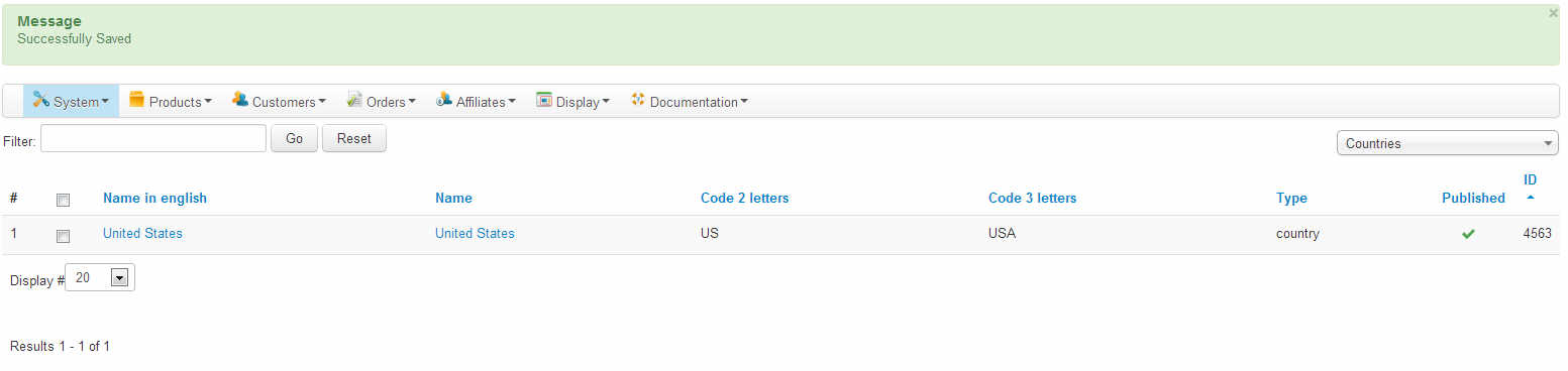

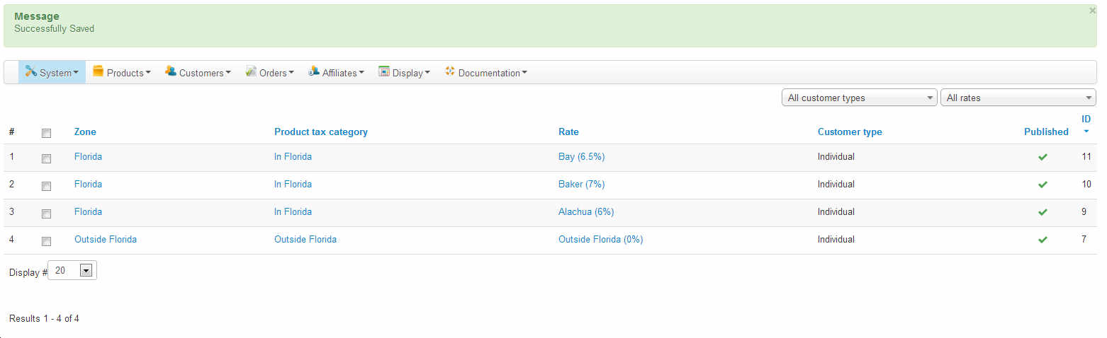

I can see several problems actually.
1. There is no need to modify the custom fields.
Please revert their "zone" value to the default.
2. You should not create tax zones.
3. In the zone field of your tax rules, you should have a county selected, not the whole florida or the tax will apply to all the customers of florida.
What you need to do:
a. unpublish all the countries.
b. change all the US state zones' type to "country" instead of "state".
c. create new zones for each county of florida and set their type to "state".
d. edit the florida zone and add all the county zones as sub zones of florida.
e. In each tax rule, select the corresponding county in the zone field.

13 years 2 months ago #108113
Nicolas - You are can I say "Awesome" those instructions worked like a charm and we now have successfully added the counties and taxes are being applied correctly. Thanks Again!

Your products are all in the "Default tax category". So your tax rules should also be set for the "Default tax category" and not for other tax categories. Otherwise, the tax rules won't apply to the products since the tax category doesn't match.
