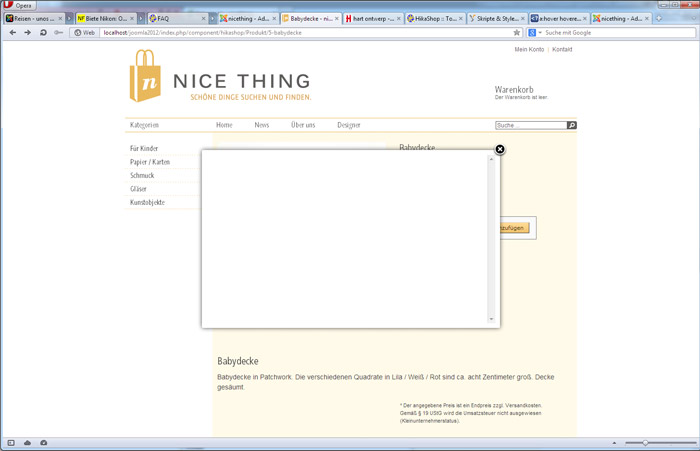

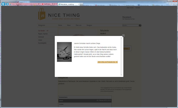

  • Posts: 95
13 years 7 months ago #89541
Yes, after view days I can find the same problem. Seams to be a Opera-Browser problem, why I attached two pictures: without content in Opera and with the content in IE.
Have you an idea, why this things happen?

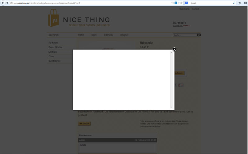

  • Posts: 95
13 years 6 months ago #91056
Hi Jerome,
thanks for the fast reply.
The popup of the "Designer" is a lot of times empty (see actually screenshot). I don't know why. (After clicking some sites is appearing sometimes.)
Thanks for give me the hint to http - I ignored that. Now is working.

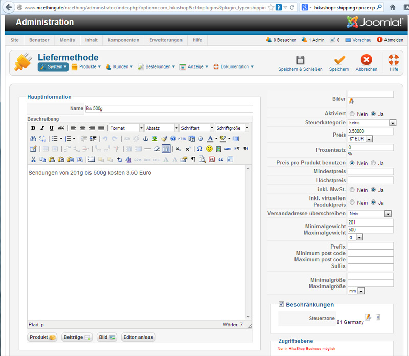

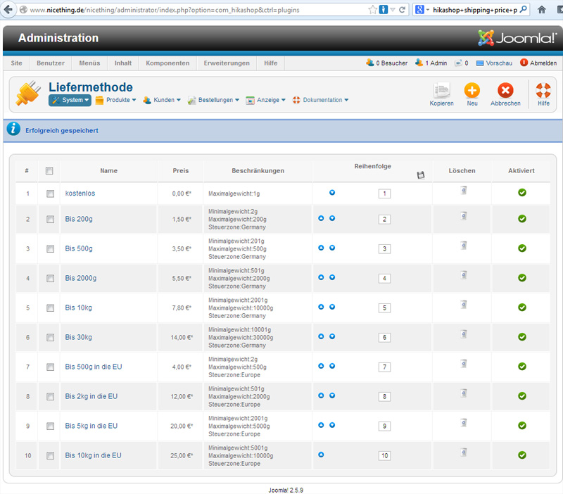

About the shipping method:
I don't want a price per product. It would be nice, that I can determinate a weight-"area" e.g. 501g - 2000g will cost 5,50 Euro. Then the amount of the weight of various products count automatically the shipping price (e.g. 150g + 300g + 200g = 650g -> 5,50 Euro).
I 've tryed it (see the attached files) and sometimes it is working a bit - but not sure (you can test it on my site).
Also I have set, one time for testing, the price per product and it dosn't working right too. I think the manual shipping method no is working fine on my site.
Can you help me to solve this two open problems?
Thanks for all!
j.

  • Posts: 95
13 years 6 months ago #91070
Seams to work with adding new products, but if I want change the number of products or I want to delete a product - both with the buttons in the cart - the new amount of all weight no will be counted well and the shipping costs are deleted (if I put after that a new product sometimes I recived the right price-sum of shipping)
Maybe is the foult in this two changing-buttons in the cart?

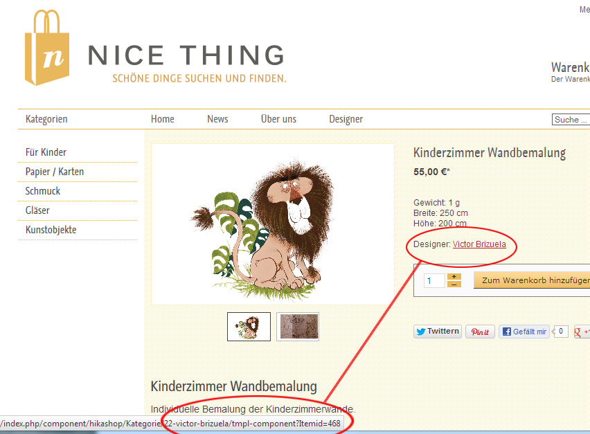

  • Posts: 95
13 years 6 months ago #91077
For the problem with the empty popup. I've tested it more and I've seen that the link is different when it won't work.
If ends with "...tmpl-component" its going right. But if ends with "...tmpl-component?Itemid=468" will be appear empty (see attached screenshot).
Of which depend it on - no idea.
Can you help me, please?
