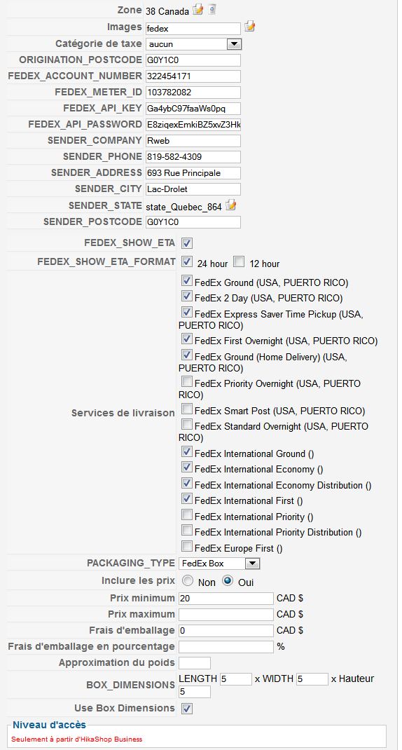

14 years 5 months ago #43829

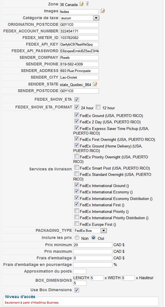

I'm really not able to have the FedEx module work. This is the only shipping method I can use.
Fedex doesn't show in payment method (I'm using Paypal, but it don't show with others too).
I'm joining you screen shot of my configuration.

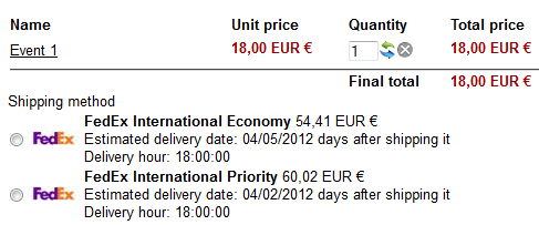

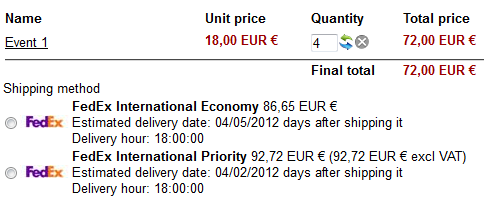

The cart with one product:
The cart with four products:
Last edit: 14 years 5 months ago by Jerome.
