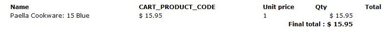

I edited the quantity php file to show the product code and product name on the checkout and on the email form that goes to the customer, but the product_code des not appear on the emailed invoice/order form
that goes to the business.
What do I need to edit to show the product_code on the emailed order form.
The product_code DOES appear on the order as seen on the backend.
Jim
ADDITIONAL INFORMATION:
I did find the emails section (I was looking in Display/Views earlier) and I added the product code to the email. But I don't know the internal codes because this is what I get in the email.
I get the price not the product_code??
PS I now see why I get the price and not the product code, but my PHP knowledge is not up to getting the correct coding to get the product_code shown, which I would have expected to have been included in this email.

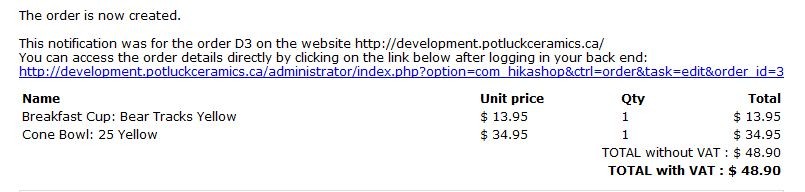

In the email, you can use this:
<td>
	<?php echo $item->order_product_code; ?>
</td>
You have to past it just before:
<td>
	<?php echo $currencyHelper->format($item->order_product_price+$item->order_product_tax,$data->order_currency_id); ?>
</td>

Many thanks indeed, Jerome.
Works perfectly.
