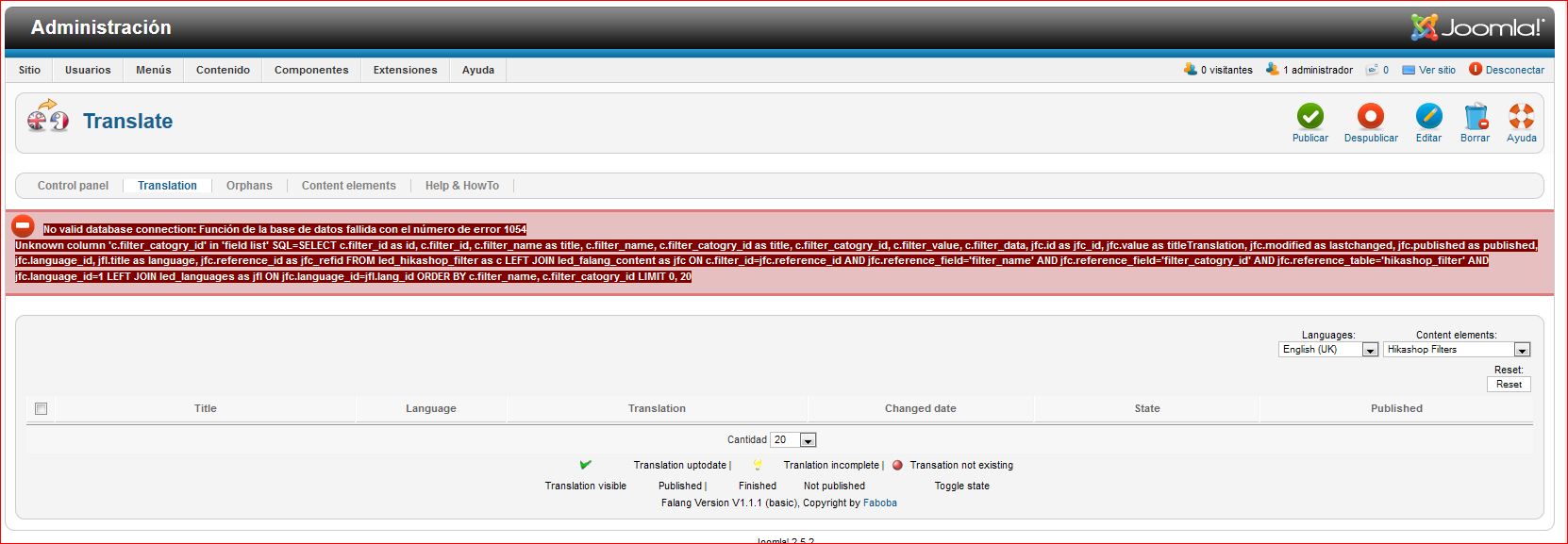

14 years 5 months ago #46696

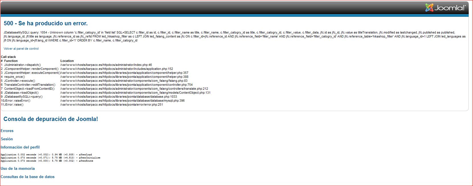

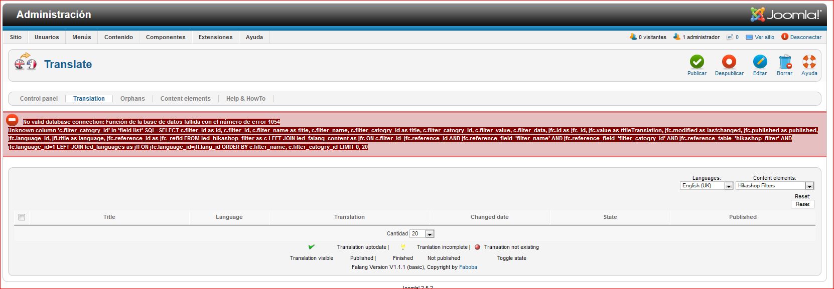

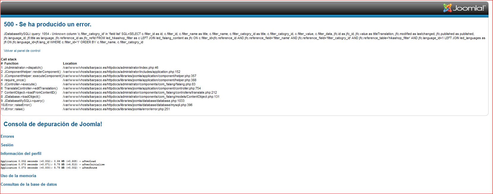

I Installed the las xml file, now the hikashopfilter appear but when I choose this option an error message appear.
Many Thanks
  • Posts: 86177
  • Thank you received: 14212
14 years 5 months ago #46700
Try with that xml instead:

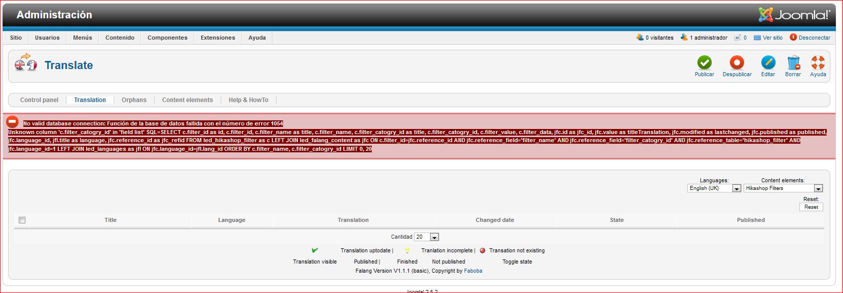

  • Posts: 32

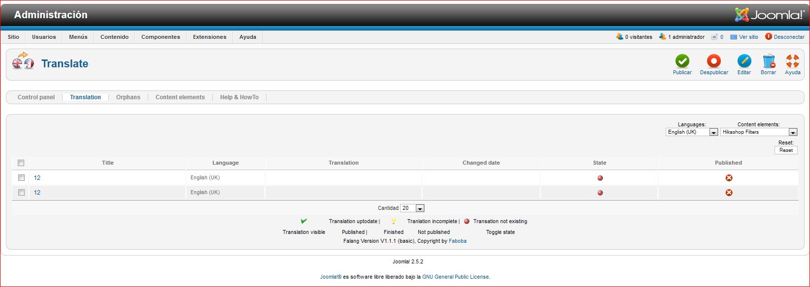

14 years 5 months ago #46711

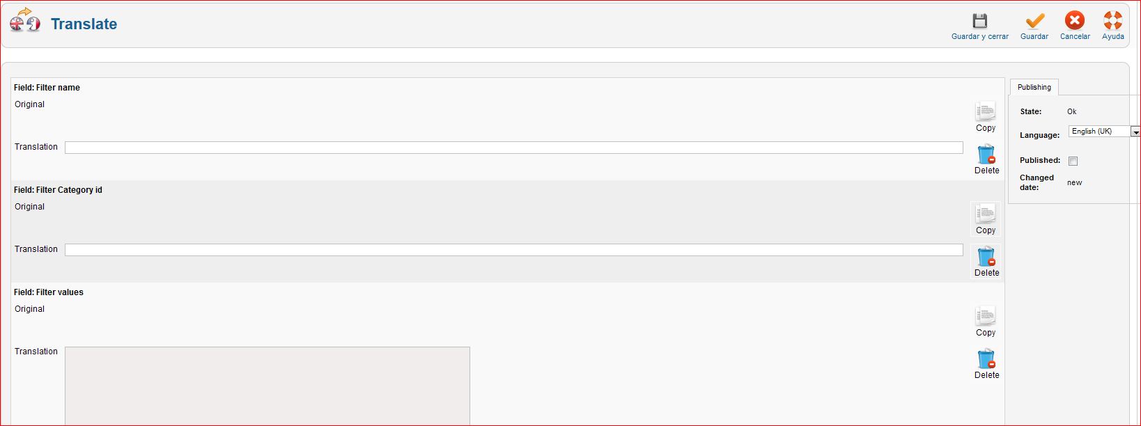

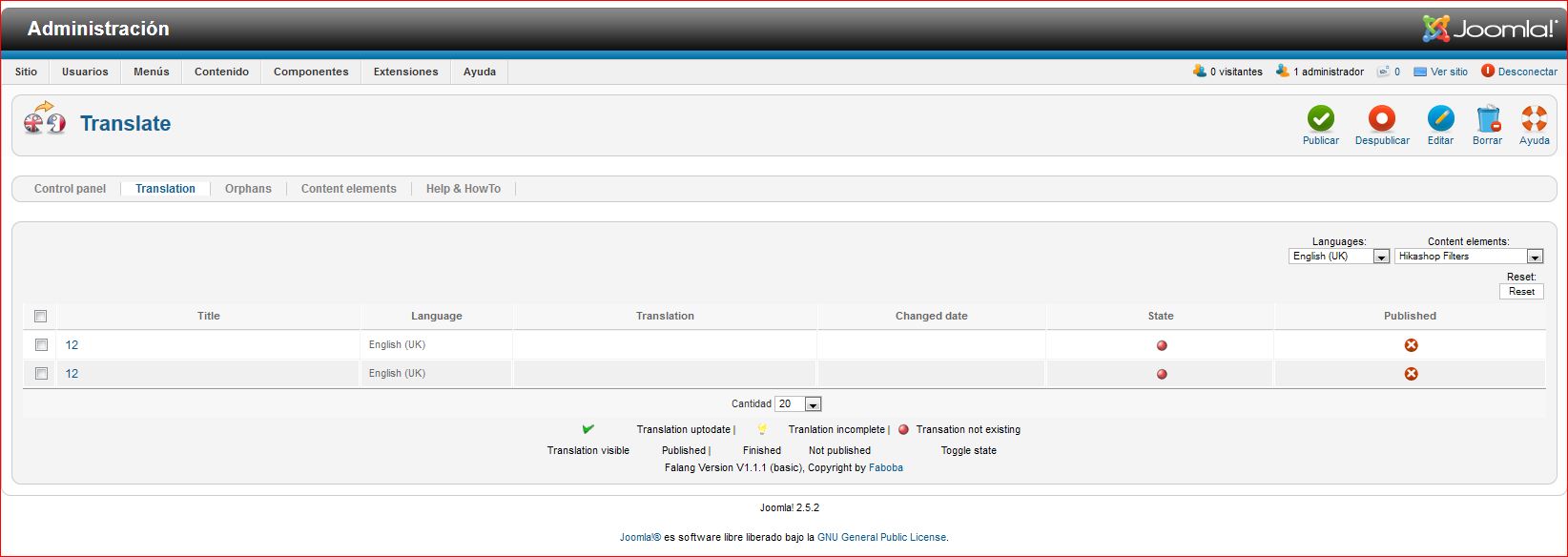

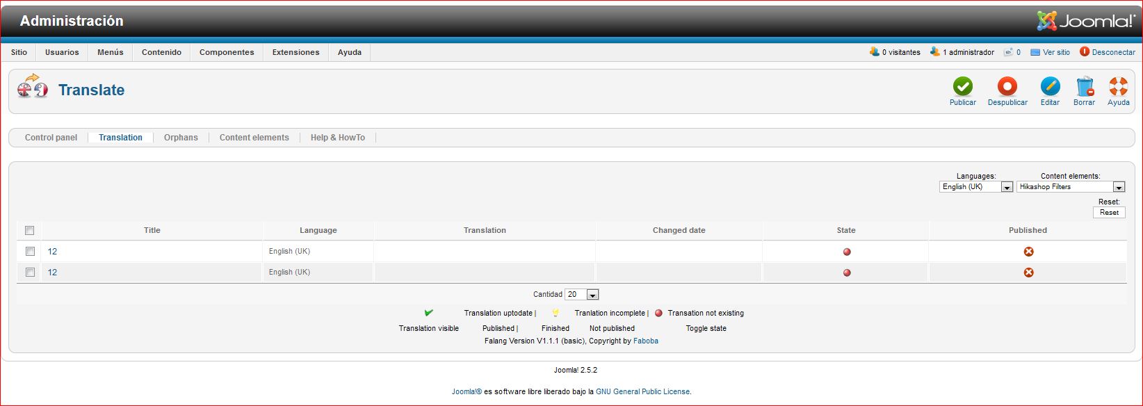

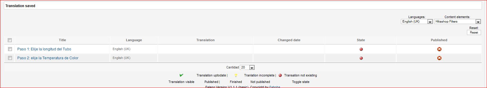

Hi Nicolas,I tried with the last xml and there is no warnings but it does not work.

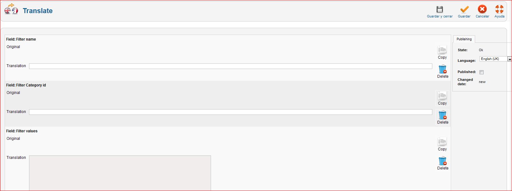

In the falang menu I can Choose Hikashop Filters, but this is what can see
12 is not the name of the filters I have. Probably will be the ID of the cathegory over the filter is working which is 12 I dont know.
When I choose one of them what can I see is
There is not original name, etc...
Many Thanks,

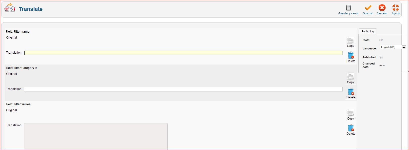

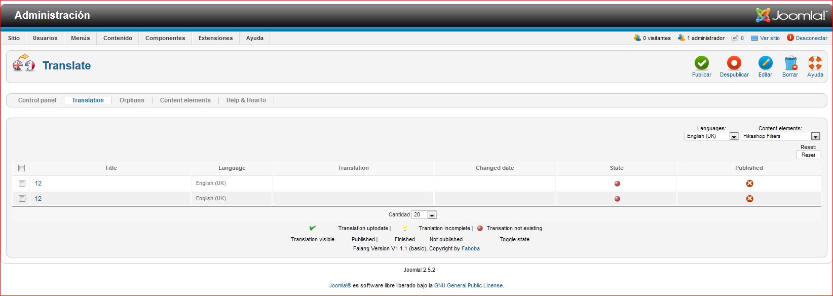

  • Posts: 32
14 years 5 months ago #46712
Sorry, the second jpg is

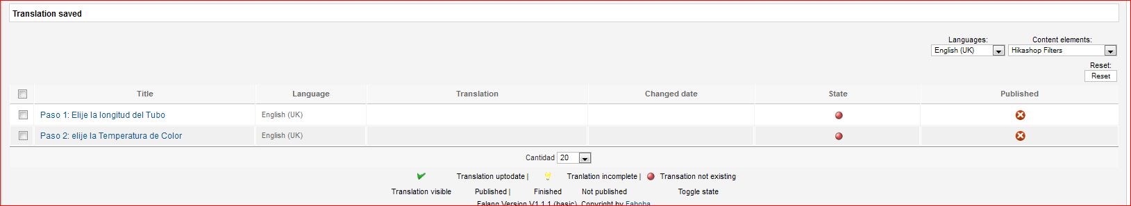

  • Posts: 32

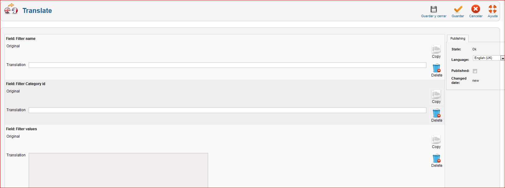

14 years 5 months ago #46735
You are very close. Now as you can see the name of the filter is ok and I can choose it.
The problem is that do not save the translation and can not publish it.
The original name is not shown.
Thanks,

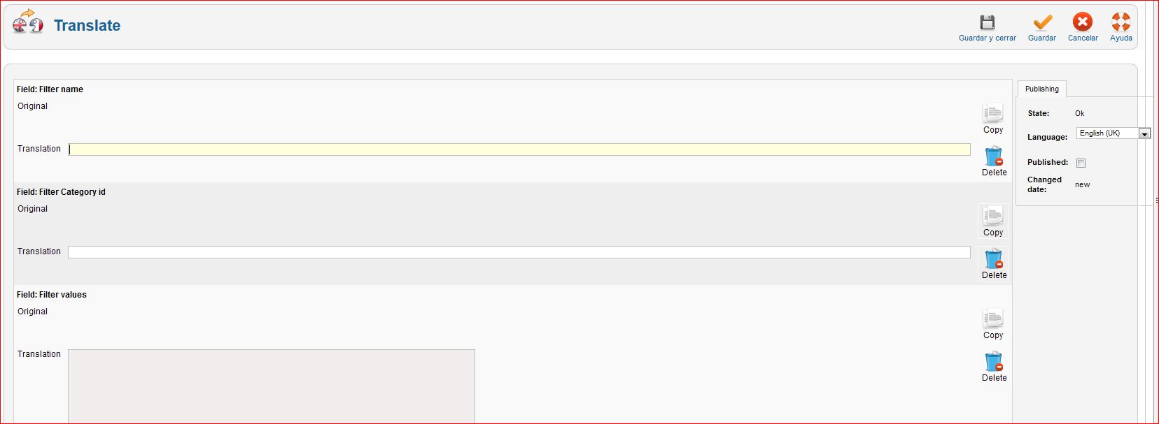

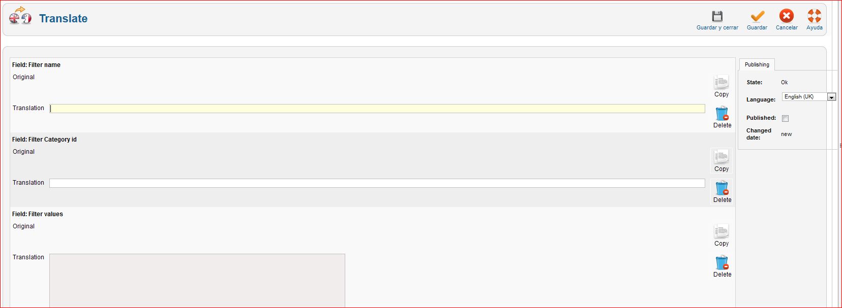

  • Posts: 32

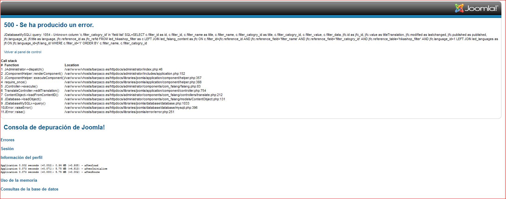

14 years 5 months ago #46741
When I try to edit the tralation of the filter then this appear:

14 years 5 months ago #46744
Try to delete the content element file in falang and install it again.

  • Posts: 32
14 years 5 months ago #46832
Hi, Nicolas. After delete all the files you told me and reinstall the last .xml it did not work. The problem was that I install the file with the name you sent me hikashop_filter_2012_04_03.xml, when I change the name to hikashop_filter.xml and reinstall it works, I am very happy now.
Well done Nicolas, Many thanks.
